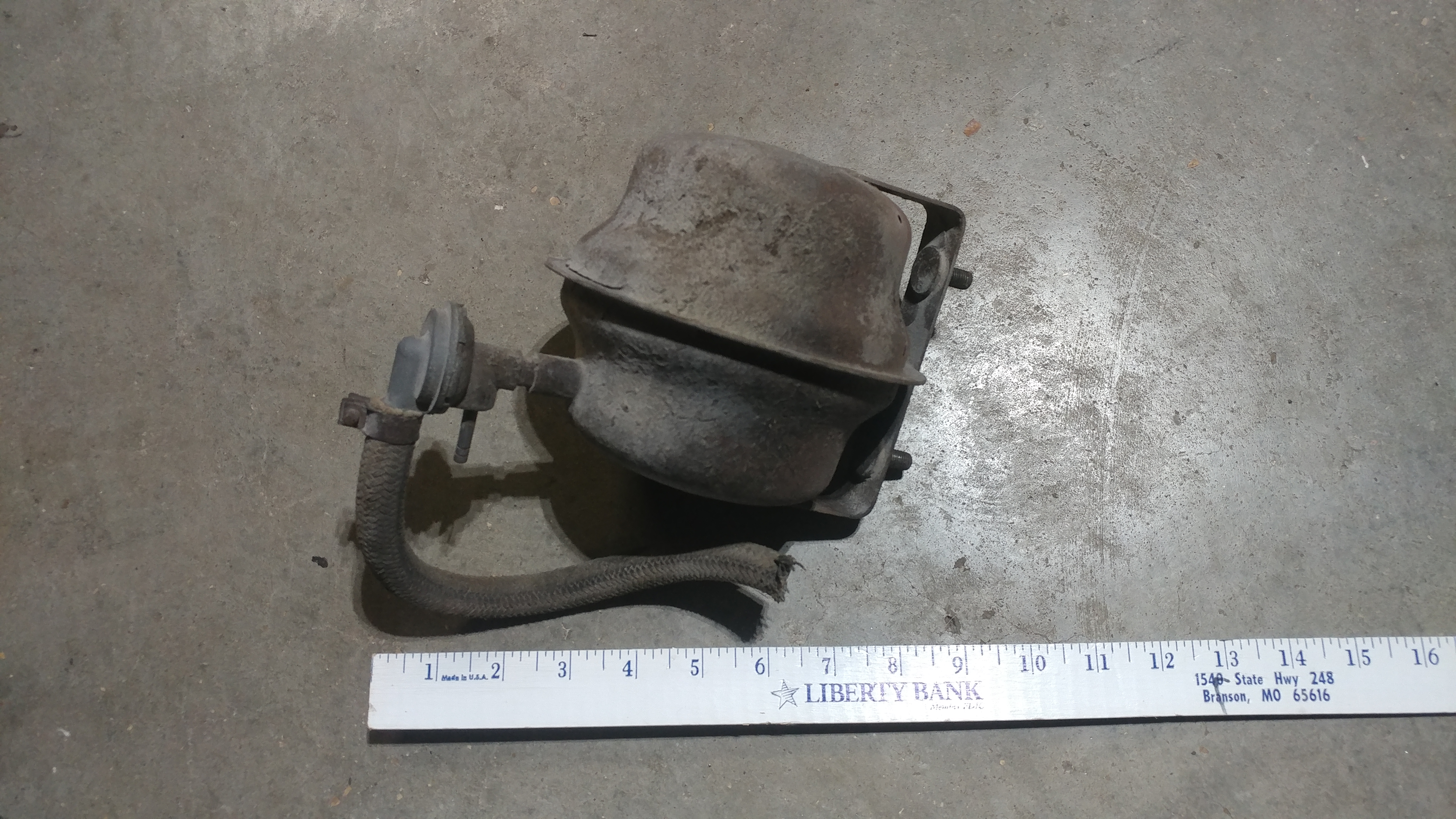

Number 4 is C19425 Reservac tank
Plate 88 part 53 is the vacuum tank for the heater and scuttle switch. Goes under the front left wing mounted on the front cross member.

As always, thanks guys. I may need to find the vacuum tank since mine has small holes in it. Going to try and fix it with epoxy. Unless Rob has a good one. Hey Rob...looks like I do not need the Air Filter listed on my other thread. Just need the servo clamp, support block, banjo, and banjo bolt.

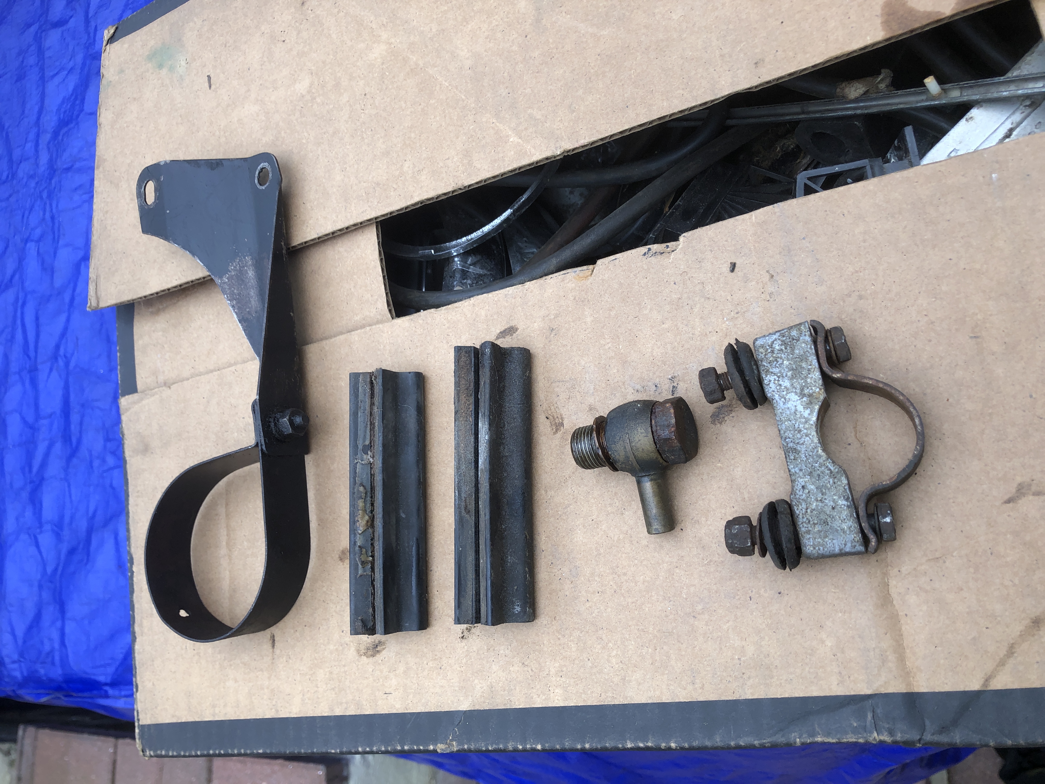

OK Joe this is what I have for you.
Servo clamp complete with bolts and rubber grommets but it does not have what you are calling the shim.
Two rubber petrol tank pads.
Banjo and banjo bolt from the servon
Complete air hose bracket and clamp.
I do not have a vacuum tank and if I did I would possibly hold on to it baring in mind I might have a hole in mine when I start investigating.
You can buy new ones from David Manners https://www.jagspares.co.uk/product/bra ... /c24910**1*** which is where I might go as they are used on the Mk2 but the other vacuum tank you have for the heater is not made anymore. SNG are £15 more expensive. https://www.sngbarratt.com/uk/#!/Englis ... e5198f518f
I hope the banjo is the one you're looking for. I have attached a photo of it in situ on my old servo to double check.
