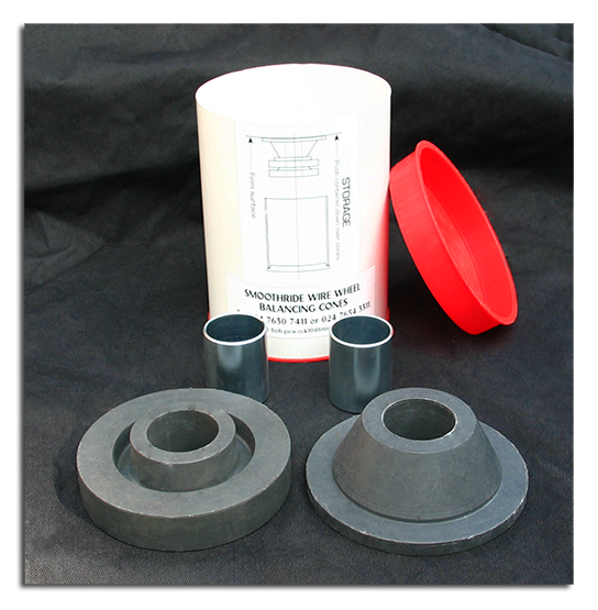

Is this the kit you use Orlando?

Well I thought about it over night and this morning had to drive to a garage to get some electrical work done. The shake on the front wheels is quite pronounced over 50 mph so decided that I have enough friends with cars that sport wire wheels that I would be justified in buying a set of cones and renting them out at a £5 a time.
They come in two sizes. The 52mm cones fit the likes of the Jaguar and Alvis then you have the 42mm cones that fit the MG and Austin Healeys. A single set of 52mm cones cost £75 but for an extra £25 you can buy both the 52mm and 42 mm cones. The full set it is then.
Glyn the cones you have shown above are basically the same as I have bought.

Yep, that's the one.
