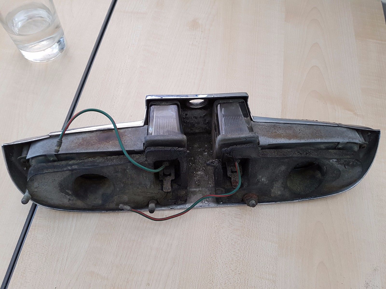

Dave the plinth top seal only fits along the top of the plinth & down the sides. Ending where the vertical chrome strips abutt the plinth. The entire assembly then mounts on two internal moulded foam fillers that are unobtainable. I found a pair in reasonable condition.
Example of deteriorated foam pieces.

Thanks for your prompt reply Glyn, thankfully both my foam pads either side are in really good condition another job done.
