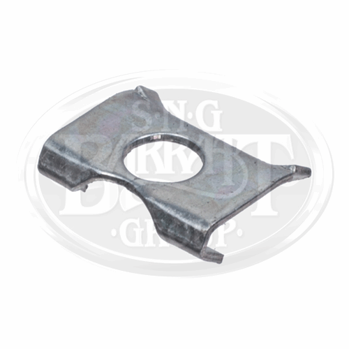

Manual says that BD 9851 is used for the door chrome and the center bonnet chrome. How do you use this clip? With a rivet? Manual does not say a rivet must be used. SNG shows BD9851 with just a clip. XK Unlimited showes bd9851 with a rivet and a clip. If you use the rivet for this clip, how do you attach the clip to the rivet? How to you attach the chrome to the clip?
While you are at it.....how do you attach BD28982? Manual says to use DAZ 404/8c screw.
Photos attached.
Photos attached.

BD 9851 is riveted to the doors or bonnet. One side is slightly sloped the other side is sharp. You line all the clips up so the slope side is say down. The chrome bead then hangs over the sharp edge and you push fit the other side of the chrome bead over the sloped edge where it clicks into place.
Again hope this makes sense.
Not sure about the plastic clips you have shown as I do not know what the are attaching.
