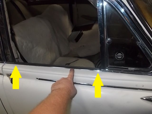

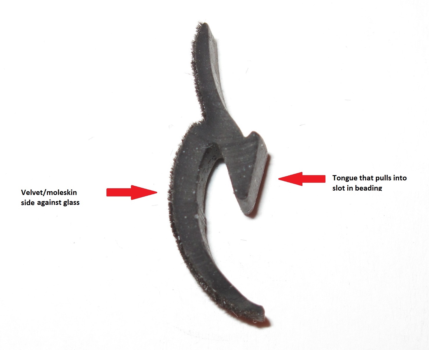

No 8 ~ Door shoulder moulding ~ Joe & I have already covered at length for his window "wipers/seals/moleskins (pic of some Aussie trying to sell one LOL)

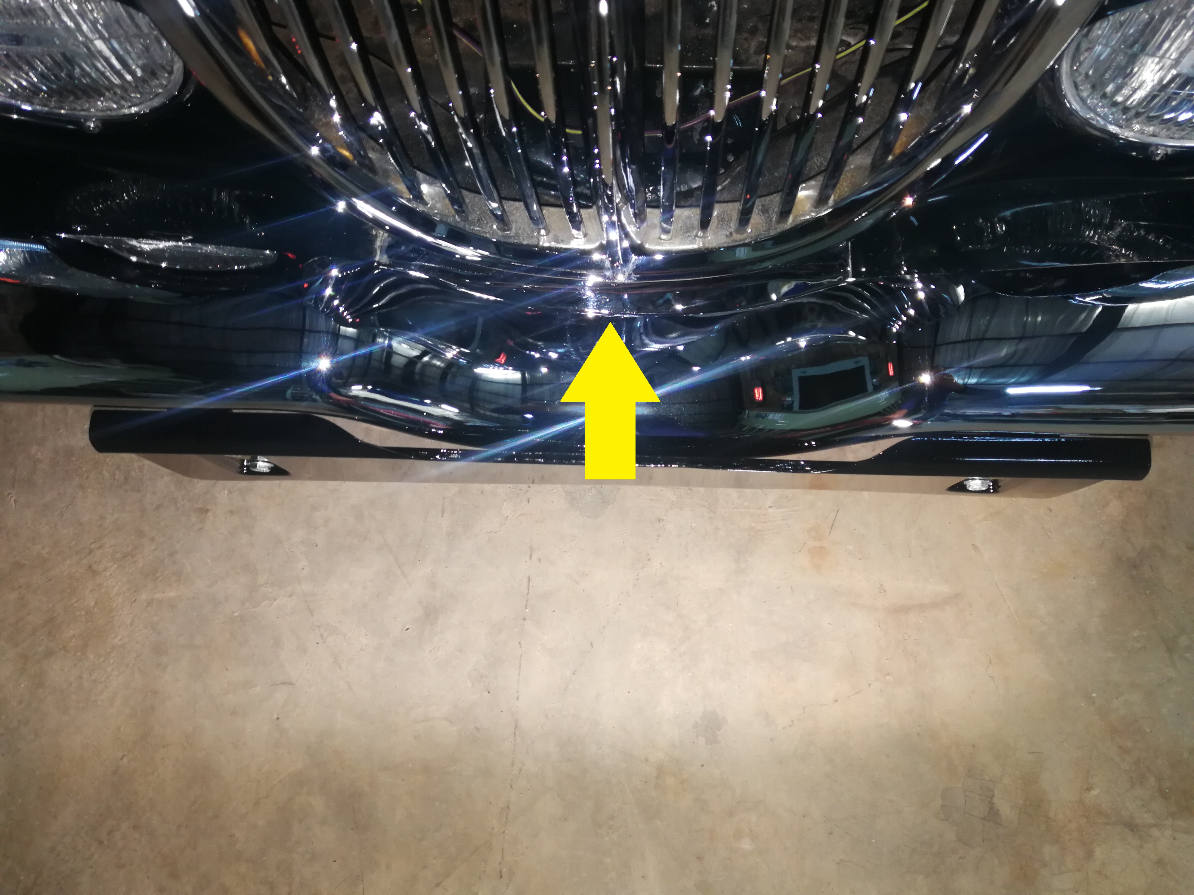

No 15 ~ U shaped chrome moulding below grill ~ many missing from cars. Here goes for now. I will try & find a better picture

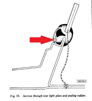

No 5 ~ Front window rubber chrome strips are known to blow off at speed. Gluing is advised. Many do not have wiring holes. Sounds like a good idea if they have.

Fitting the rear window chrome is an evil job. They need to be perfectly shaped & held down by much tape until adhesive has set. They hook into the rubber window side & cap over the rubber body side.

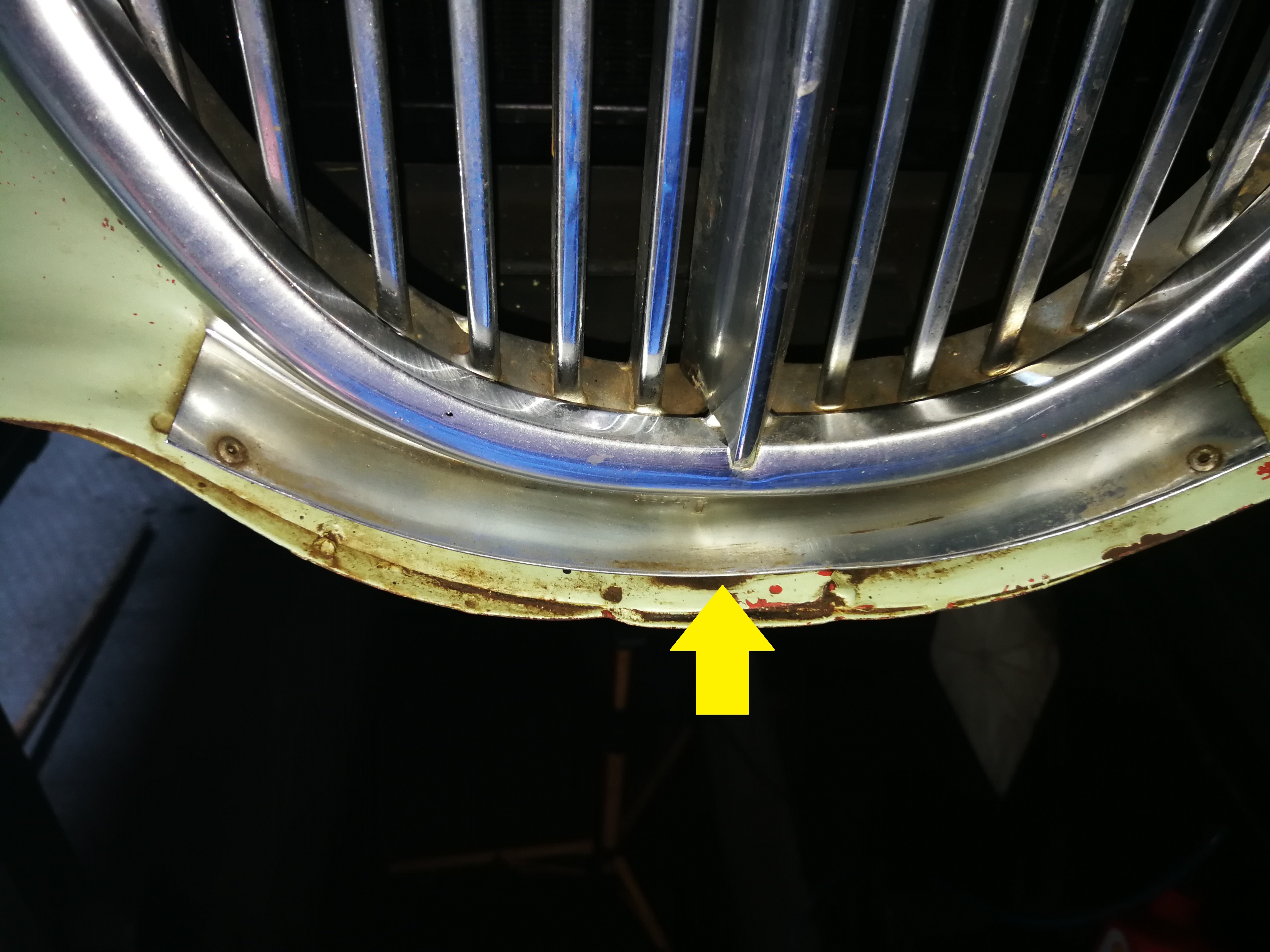

Chrome moulding that has 2 sharp tongues & lips up under the grill. Fills gap between bumper & grill. All S Types had them. Discarded by many when repainting or repairing accident damage. Part Number BD26510.

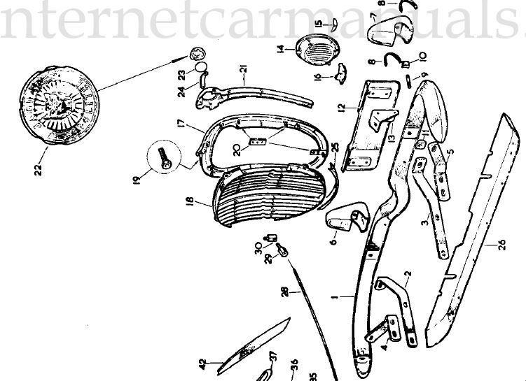

Part Number 25 here:

After I posted I had a look at the parts list and found the chrome under the grill but my car has not got one and it did not come with the car when I bought it so had no idea it existed. I will have to buy one eventually but presumably the grill has to come off to fit it and that is another bitch of a job. I am lucky to have long thin arms because with short fat arms you would never be able to reach the top screws behind the grill through the inspection hatch.
The "External shoulder window wiper chromes" confused me as I thought you were referring to the windscreen wipers and could not envisage an extra bit of chrome to stop the wipers going too far.lol.

I salvaged one of those under-the-bottom-of-grille-molding-finishers but it will need re-chroming.

Item !5 on your list Glyn the chrome trim below the grille behind the front bumper, I was going to ask about that as my S type has that fitted. My question was, is that a part a Jaguar option, standard fitting or aftermarket factor accessory part. Only it a good idea covering the spot welds and various welding of panels in that area from new, but it is a water trap perhaps.
I have seen it on a very nice red S type NMO 978E at the I.O.W. show last year and on several later Mk 2' 340's with the S type front bumper so was it an option for that type of front bumper ?.
Re: Refitting the chrome
Many have been discarded over time. We all use different terminology. If you loosen the base of the grill you should be able to slide the two sharp tongues up under it. Working through the hatch under the grill is not easy. I rattled off the list from memory in the early hours of the morning & have likely forgotten something. Fortunately it is fresh in my mind from doing the chromework on my car.cass3958 wrote: ↑Fri Mar 01, 2019 1:05 pm After I posted I had a look at the parts list and found the chrome under the grill but my car has not got one and it did not come with the car when I bought it so had no idea it existed. I will have to buy one eventually but presumably the grill has to come off to fit it and that is another bitch of a job. I am lucky to have long thin arms because with short fat arms you would never be able to reach the top screws behind the grill through the inspection hatch.
