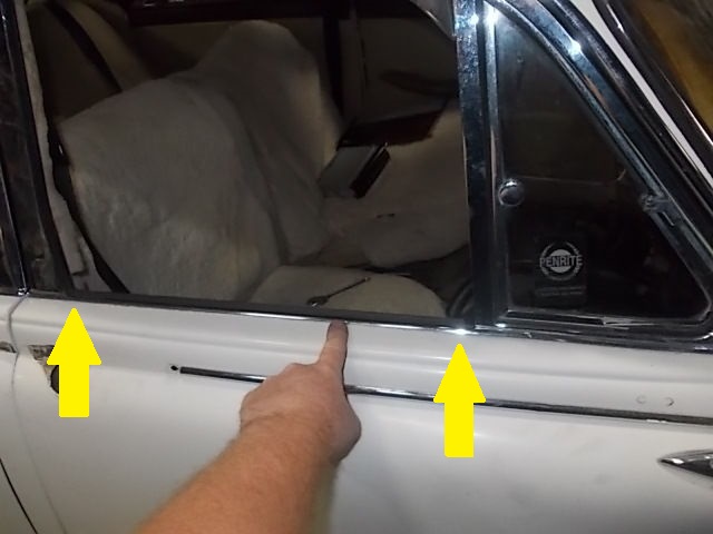

8) External shoulder window wiper chromes are screwed & pop riveted in place once you have pulled rubbers into grooves. Once again rust prevention necessary at screws & rivets

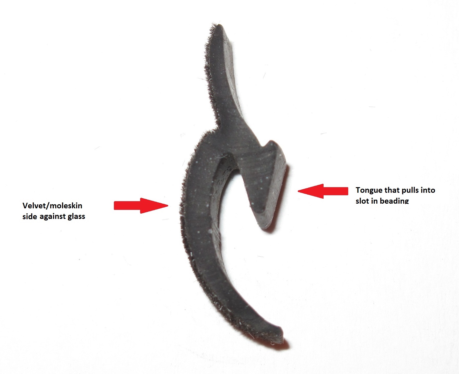

No 8 ~ Door shoulder moulding ~ Joe & I have already covered at length for his window "wipers/seals/moleskins (pic of some Aussie trying to sell one LOL)

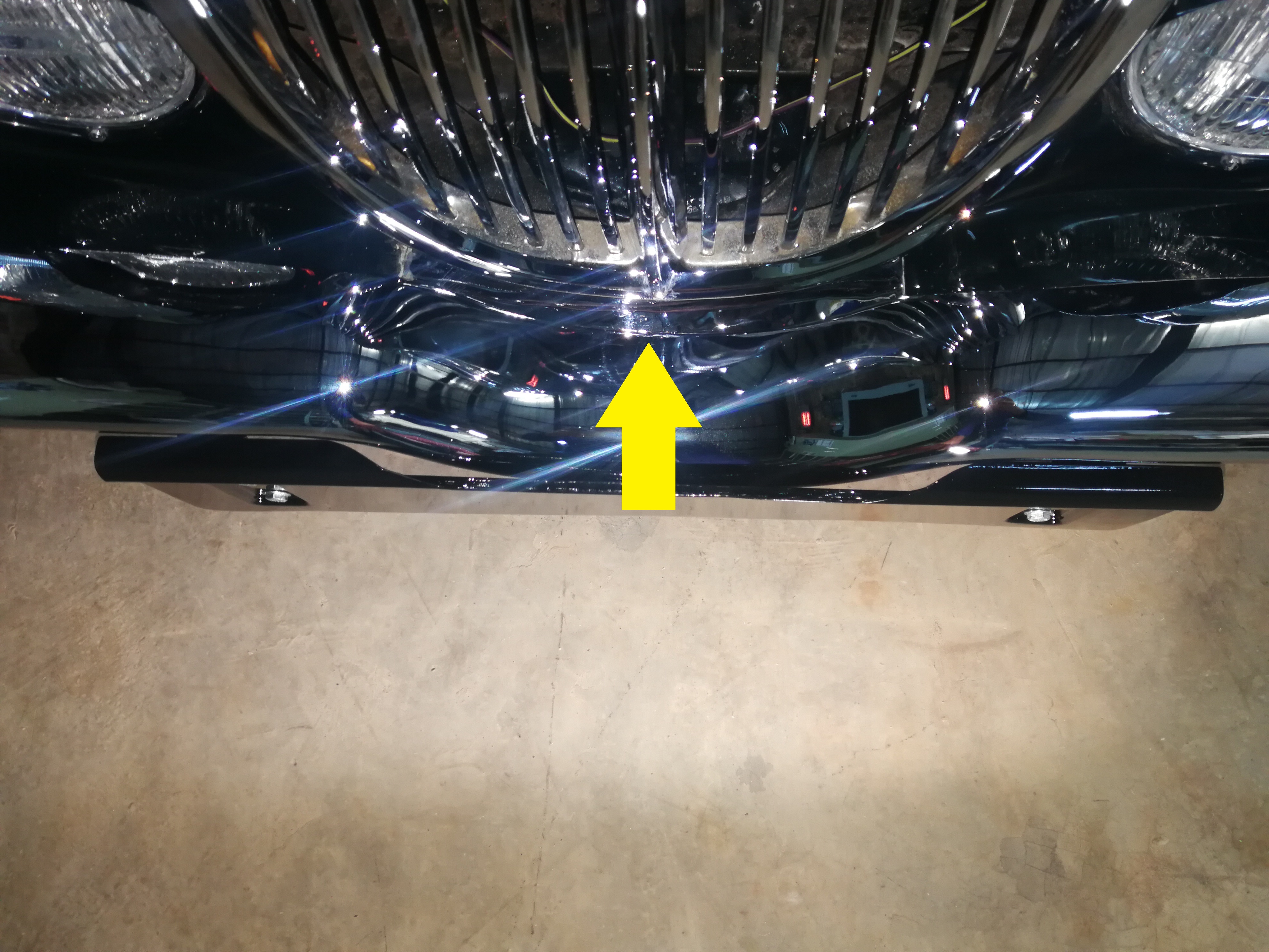

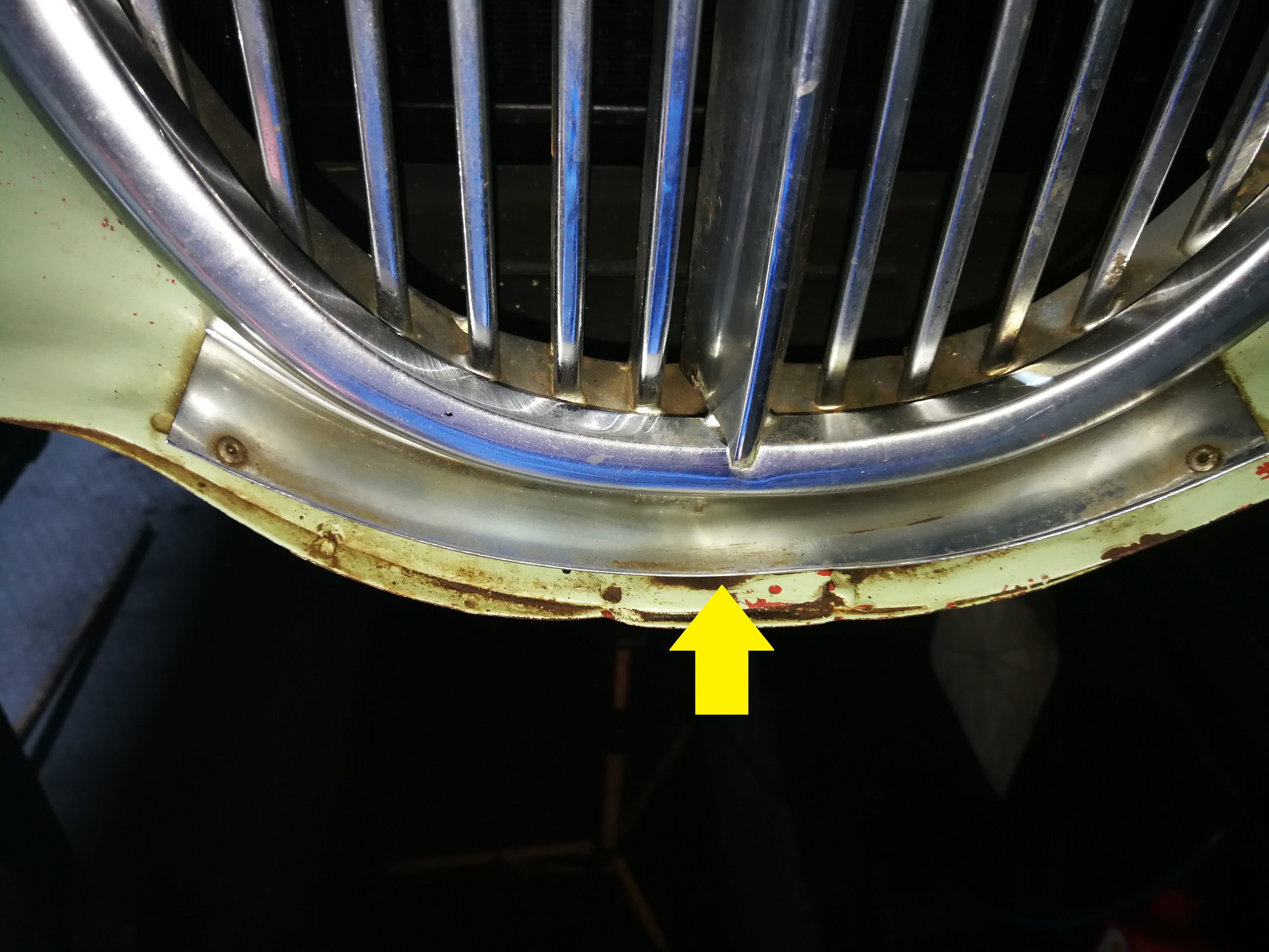

No 15 ~ U shaped chrome moulding below grill ~ many missing from cars. Here goes for now. I will try & find a better picture

Chrome moulding that has 2 sharp tongues & lips up under the grill. Fills gap between bumper & grill. All S Types had them. Discarded by many when repainting or repairing accident damage. Part Number BD26510.

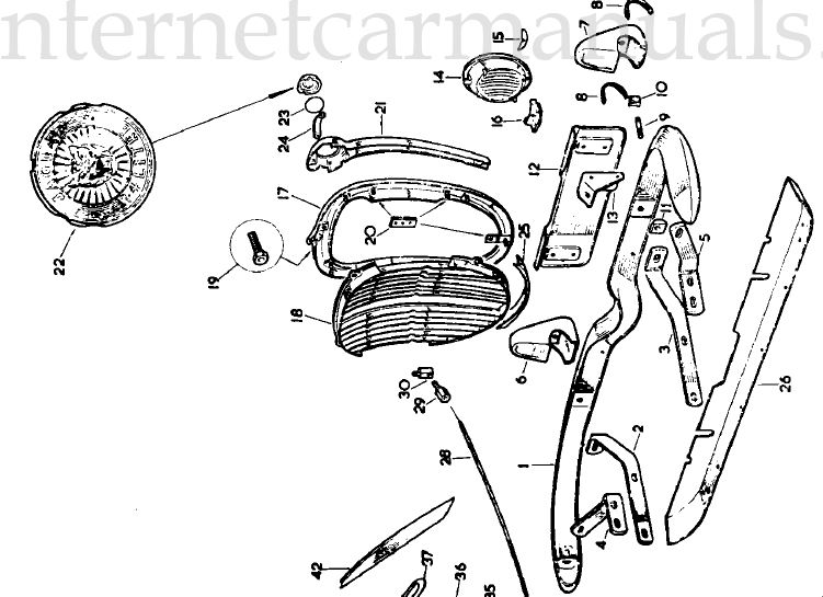

Part Number 25 here:

After I posted I had a look at the parts list and found the chrome under the grill but my car has not got one and it did not come with the car when I bought it so had no idea it existed. I will have to buy one eventually but presumably the grill has to come off to fit it and that is another bitch of a job. I am lucky to have long thin arms because with short fat arms you would never be able to reach the top screws behind the grill through the inspection hatch.

I salvaged one of those under-the-bottom-of-grille-molding-finishers but it will need re-chroming.
Actually, I think it holds the front wings together from blowing off the car at speed. :D

Item !5 on your list Glyn the chrome trim below the grille behind the front bumper, I was going to ask about that as my S type has that fitted. My question was, is that a part a Jaguar option, standard fitting or aftermarket factor accessory part. Only it a good idea covering the spot welds and various welding of panels in that area from new, but it is a water trap perhaps.
I have seen it on a very nice red S type NMO 978E at the I.O.W. show last year and on several later Mk 2' 340's with the S type front bumper so was it an option for that type of front bumper ?.

Many have been discarded over time. We all use different terminology. If you loosen the base of the grill you should be able to slide the two sharp tongues up under it. Working through the hatch under the grill is not easy. I rattled off the list from memory in the early hours of the morning & have likely forgotten something. Fortunately it is fresh in my mind from doing the chromework on my car.
