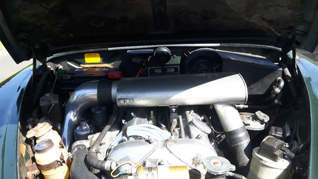

I had a look at this S Type belonging to a chap living locally today and had a look at the air cleaner on it, it was level across the engine despite as the photo shows in the last one.
