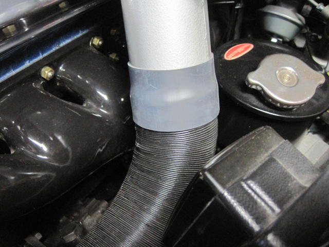

As you know mine is a September 1967 manufactured car. I did not have a hose attached to the air intake when I got the car but I did have a type of jubilee clip attached to the radiator mounting point which appeared genuine. It was around 3 inch in diameter and slightly off to the side of the radiator almost as if the intake hose drew cool air from down the side of the radiator rather than from through it. On some Mk2s (not sure if the S Type was the same) they had a grill in place of the fog ranger. did this connect up to an air hose to supply cold air to the intake? On my S Type if you remove the driving light it has a solid back to it so no chance of it being used as an air intake. On the Jaguar 420 it had main lights, fog lights and also two small oblong air grills in the front panel.
yes the S type has built in buckets for fog lamps with just a center hole for the lamp stud to go through, and a grille was added for cars without fog lamps. Same with MK2 .
though the fog lamp buckets are in theory, ideal for air intakes, if you look behind the buckets there is no tunnel or opening into the engine compartment unless you cut into the inner wheel housing, which in that specific point can debilitate the structural integrity.
the ring or bracket you mention is attached to another side bracket bolted to the engine block. So yes it is original. The hose is clamped by the round ring bracket.
s type air cleaner sleeve 001.JPG (45.38 KiB) Viewed 5735 times
I think he is confusing the modern or current S type with the 1963-1968 S type.
