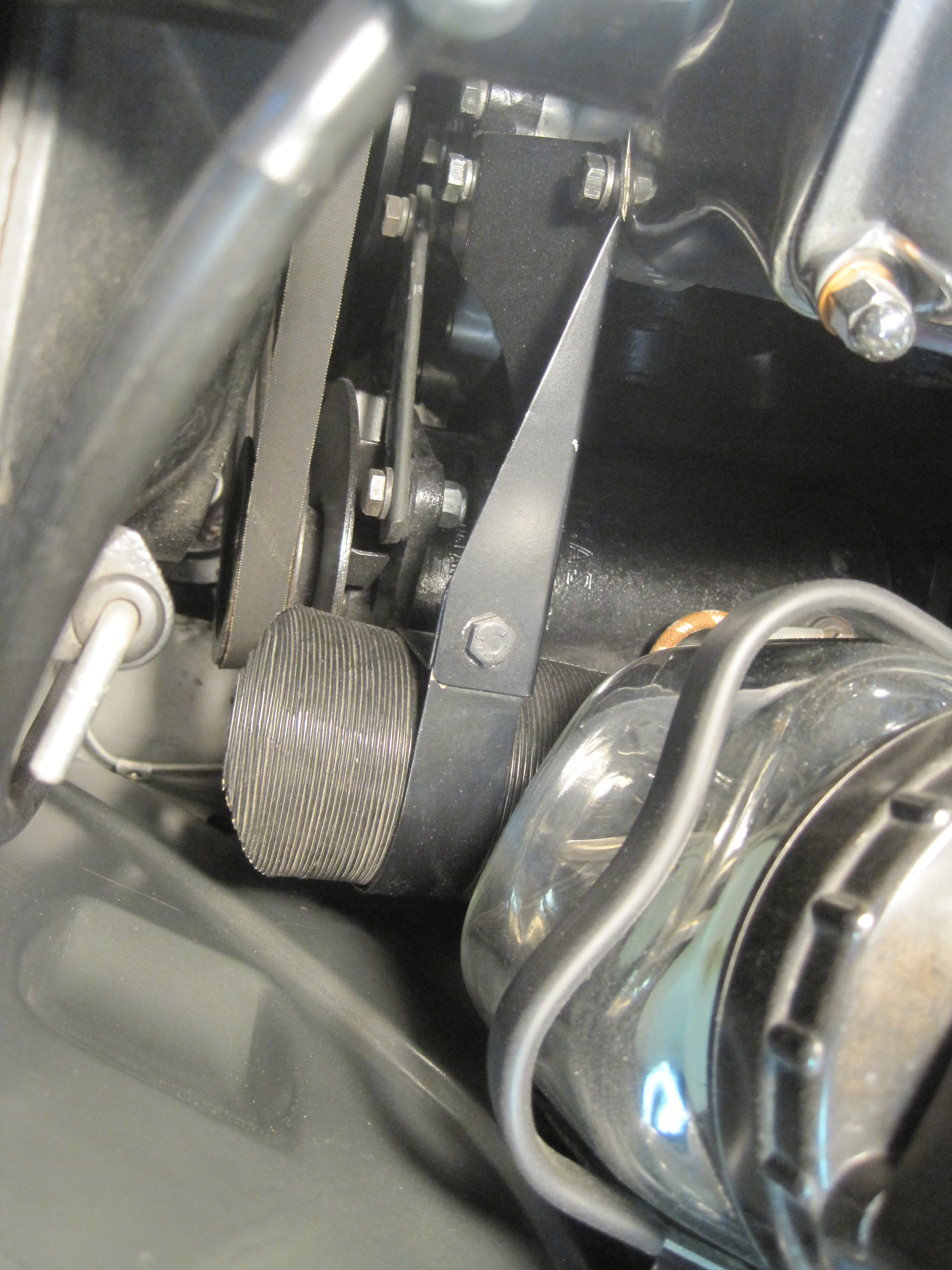

there are no plain washers between the Bracket and the Timing Cover. The Bracket itself acts like a plain "washer".
But each of the two bolts at the timing cover should have a plain washer and a lock or "star" washer.
The Clamp should have a plain and lock washer at the nut end, and a plain washer under the bolt.
in my car, the Nut was UNDER the clamp, and the bolt head at the top of the clamp. Not that it matters at all.

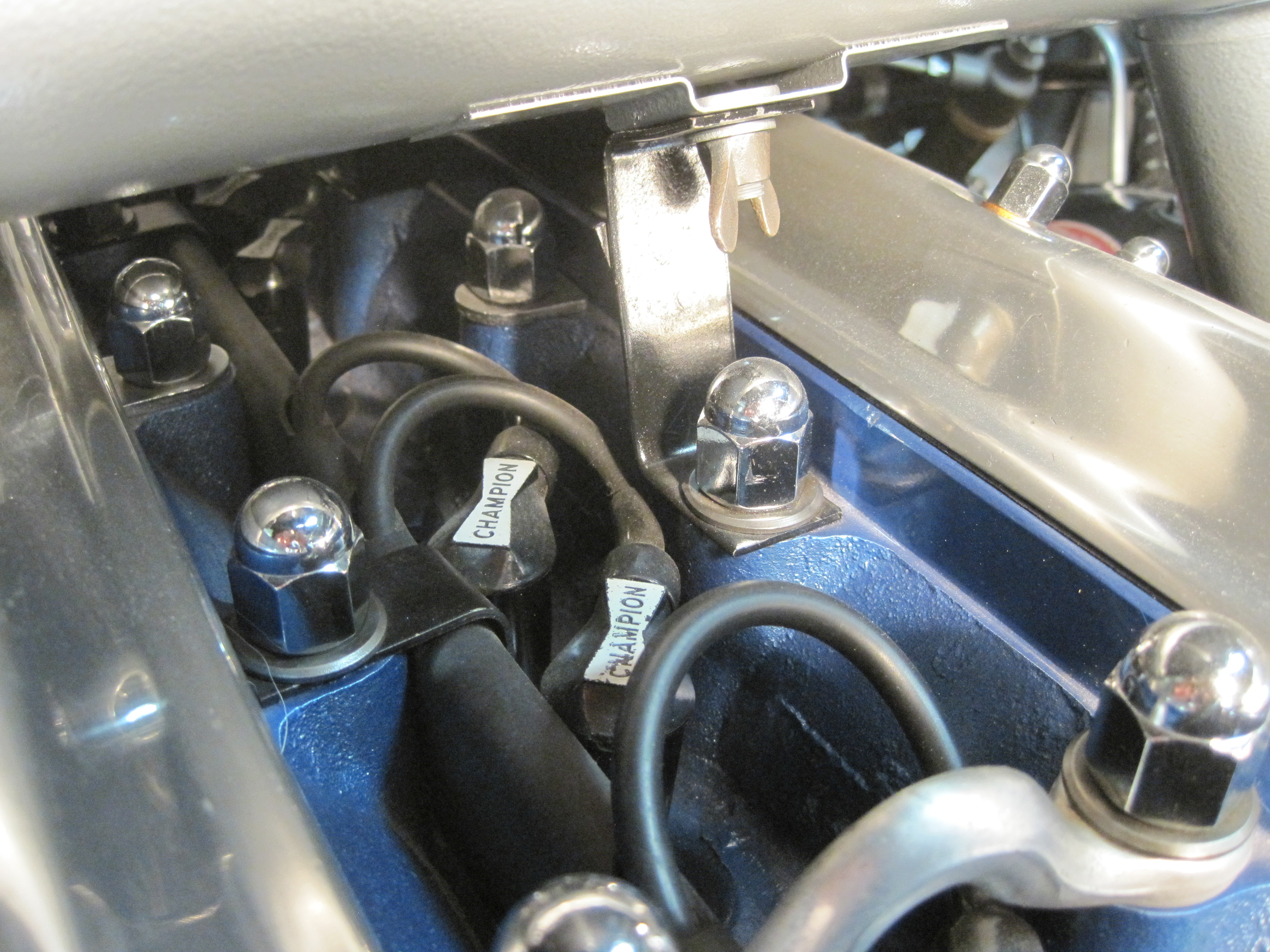

Thanks Orlando for the kind words. Your hose, seal and bracket setup looks great. To answer your question about washers at the air cleaner bracket. the bracket sits on the head just like the plug wire brackets with a beveled head washer under the dome nut. There is a regular washer under the thumb screw at the top of the bracket. Anyone with contradictory information, please correct me.

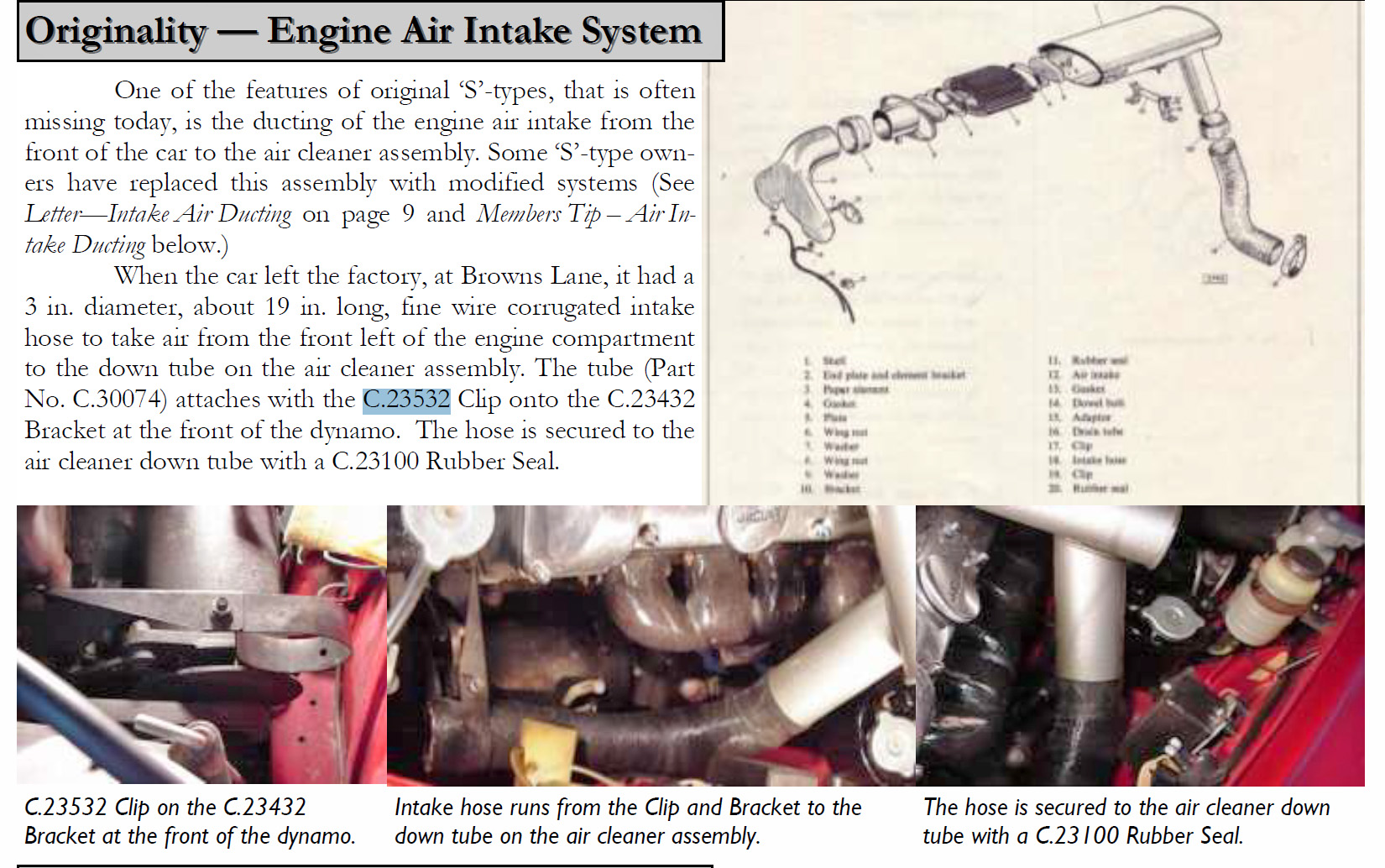

I have been told (when I was looking for a replacement hose), that in late 1966 through 1968 production this hose was deleted, but David says there is no Service Bulletin about it, and the parts book does not give any VIN "delete" info. either.
In my car I removed the hose and clamp / bracket. There is an existing hole on the inner wing panel with a rubber plug which I removed to allow cool air into the engine compartment. It is near the intake pipe of the air cleaner. I really didn't notice any performance difference without the hose.
Thanks for your replies, everyone. I will whip those washers out at some stage and put them on the other side of the bracket. I thought they probably weren't required, but the resolution on the Newsletter 7.4 with pix of David's car wasn't quite sharp enough to be sure. Yes, I installed the 70mm hose over the outside of the air intake and Alan's collar neatly holds it in place. Though I confess that, looking at David's car, the hose appears to go inside the intake tube. It took me three years to find the clamps, so there aren't too many about.

Thank you Orlando. 70mm id it is likely to be in the modern world. Looks fine. I'll order a metre. I hope Alan & David chip in again regarding the termination under the sleeve. David's is original & Alan's pipe is NOS supplied to him by David who had kept a spare. Technically if it went inside the aircleaner snout it would create less turbulence & be better but I think it goes on the outside with or without tabs.
