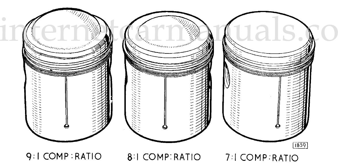

I don't know what pistons you have fitted. Come in 7, 8 & 9 to 1 CR.
I'm sure you have either 8 or 9 to 1 CR pistons & that your cylinder head has been shaved. Most heads today have been shaved.

Joe your engine number originally was 7B57313-8. The last 8 signifies you had 8:1 compression pistons fitted so unless you have changed the engine or had some major work done to it you should still be running these pistons.
You guys are a wealth of information....yes, mine is 8:1 compression with /8 after my engine number. Premium it is.
Thanks,
I'm sure your head will have been skimmed at some time pushing up the CR & making knock more likely ~ Premium it is!
