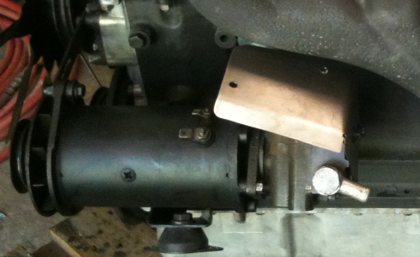

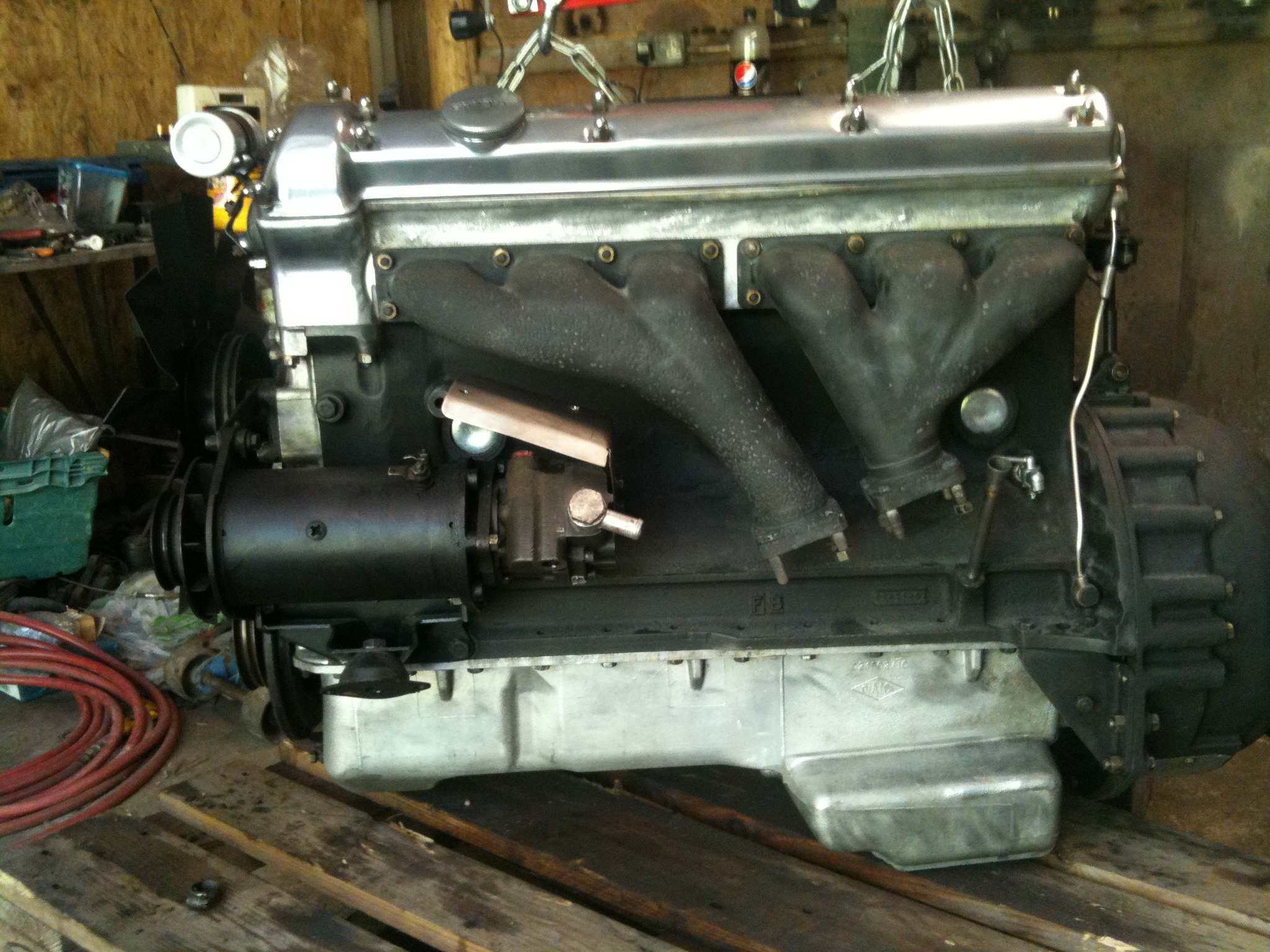

My car was manufactured in September 1967 and it has a stainless steel heat shield fitted as standard over the top of the PAS pump.( See photo.)
On the back of my PAS pump there are two screw holes which allow the shield to be bolted to the pump protecting it from the majority of heat coming from the exhaust manifold. I know I have some close up photos of the shield off the car but I cannot locate them at the moment. If you are raising the position of the pump some form of heat shield is essential. Not all the PAS pumps have the holes in the base plate. I have two spares one has no holes (from a 1966 S Type) the other has four holes (don't know the origin) and my original pump has two holes for the bolts.

Thanks Rob. I am thinking that the higher mounting will not work, partly because of the heat problem but also because it will probably be near impossible to get at the bolts attaching the PAS pump to the dynamo. I will see if I can fit the replacement into the lower bracket but also get the old one checked out and maybe overhauled.
