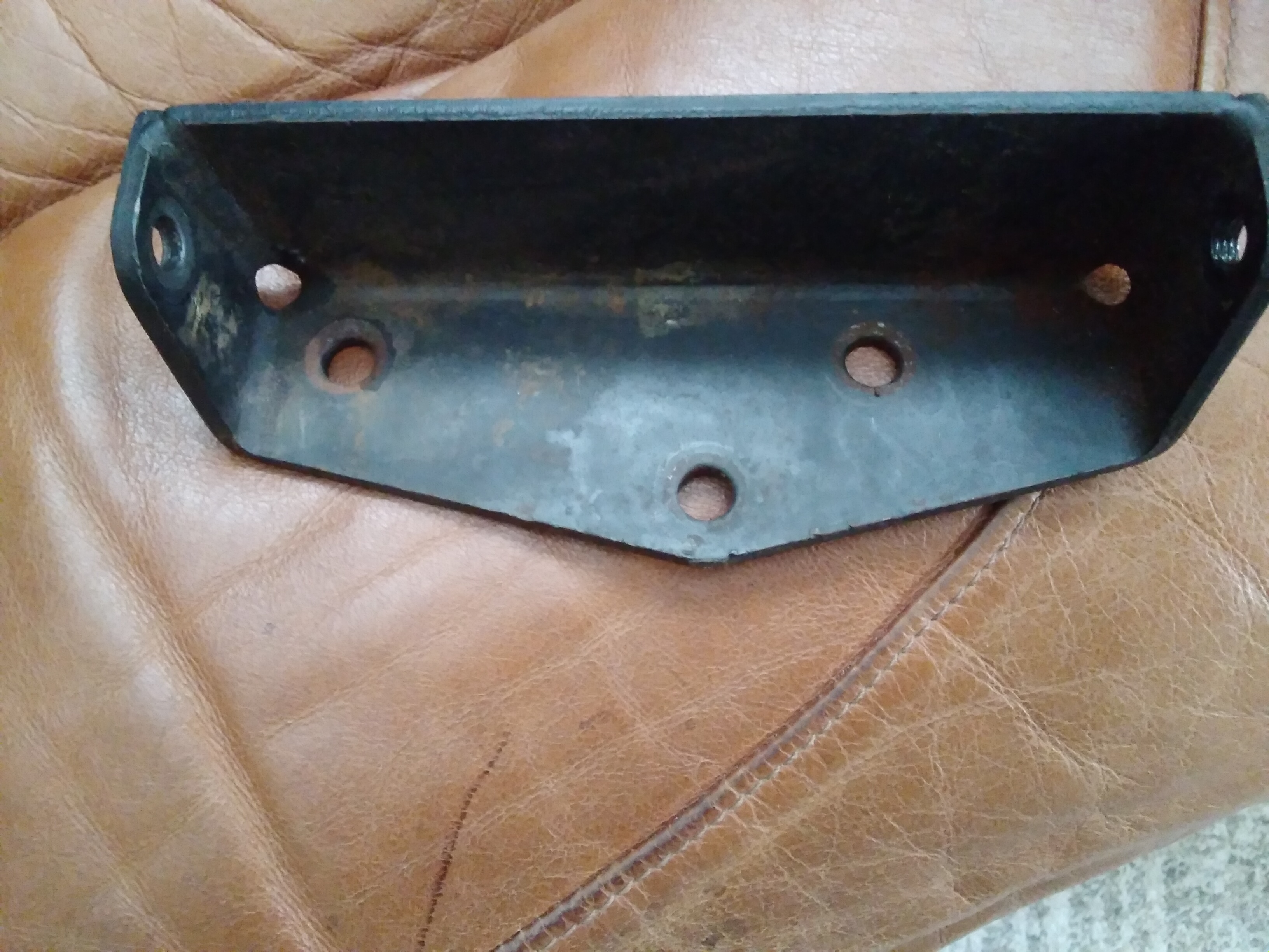

Well, I have finally bitten the bullet and taken out the Dynamo to replace it with a functional spare that came in a box of bits with the car. The good news is that the power steering drive dog bits look to be in great shape so I won't be up for a big expense there. On the downside the Dynamo I took off is a C48 - standard I believe - while the intended replacement is a C45 and has a totally different mount bracket that matches up with three bolt holes higher up on the side of the block. A bit of research suggests that it might be from an E-type. This arrangement looks a lot easier to install and uninstall than the presumably stock mount. So - my question is - will the replacement unit I have fit properly or will I have issues with alignment etc, or will the smaller dynamo be underpowered? Pictures of the existing mount and the replacement bracket. Any suggestions appreciated.

If it is really from an E Type it will not have the rear plate provision to mount the PS pump. Some things to consider, if the location changes will the hoses for the PS pump reach? Will you be able to find a belt that accommodates the new location? If it were my car, I would find a good electrical shop to rebuild the C48 unit. Usually it only take a front and rear bearing and a set of brushes and a good cleanup of the commutator. Sell the C45 on to defray expenses. And looking at my vintage Lucas catalog, early 3.8 liter E Types took a part number 22902. Also shows a 22528 for a Mark II with power steering.
