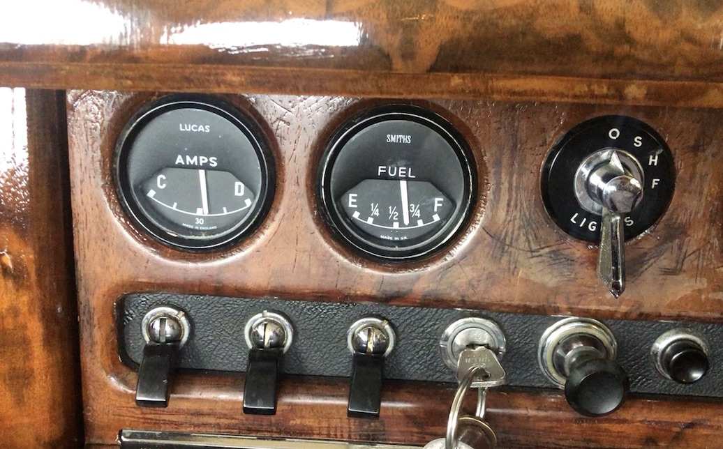

Thanks guys for comments. I went for positive earth as I am not feeling confident enough to change all polarities throughout the car, but once I understand the system better I may change it down the track. Now I have converted it, the new alternator fits nicely and wiring has been done as per Dynalite instructions. The small terminal from Dynalite is attached to warning(ignition) light and large terminal to B (To battery). Car starts well, runs well and battery is getting 14.3 volts (checked by multimeter at battery terminals) when engine is running. Suddenly there seems to be a smoothness in the ride. Up to this point I am happy.
But.... (and there is always a but !)
Now as you may (or may not) know that with the positive earth Dynalite there is a relay fitted between the Ignition light and Ignition, which I fitted as per instructions. However the ignition light is not coming on, not when key is turned and not when engine is running (and battery getting 14.3 volts). Also the Amp meter showing continuous negative deflection (towards D). When the headlights are turned on it deflects more (while battery still getting 14 volt charge in +ve). I didn't touch the amp meter at all. I presumed that it should show positive (towards C) deflection at some stage?
So is there an issue or is it normal ?
Battery is fully charged.
Thanks
idling
idling
Amp 1.jpg (243.8 KiB) Viewed 3107 times
With headlights on
With headlights on
Amp 2.jpg (213.21 KiB) Viewed 3107 times

When I fitted mine I did not have a relay between the Dynalite and the ignition light. (maybe a new thing) so I would try removing the relay and just have a straight through wire as per the original. If you go back to my fitting instructions http://www.jagstyperegister.com/forum_n ... earth#p802 there was a wire on the RB340 terminal marked W/LT which runs direct to tthe ignition warning light. All I did was connect this wire direct to the small terminal of the Dynalite and the ignition warning light works as it should.
With the Ammeter "C" stands for charge and "D" stands for discharge so if you have a full healthy battery it should very rarely go in to the "C" range on the dial as the battery is always being topped up on a trickle charge. At the same time when you start to drain the battery by using the lights, radio, heater fans, wipers and driving hard then the Dynalite will be pushing more power to the battery to keep it topped up and I would expect the needle on the dial to dip into the "D" range so consider this normal.

Glyn I think with the older Dynamo the Ammeter was possibly more important then if you have an alternator fitted. Modern batteries might help as would a new or fully rebuilt dynamo unit as well.
My old dynamo would only really start exceeding 12 volts when the engine was producing 1000 to 1500 RPM. Quiet often when I had the dynamo fitted when the car was on tickover the red light would be on and the ammeter would be showing towards "D" meaning the battery was running all the systems and very little extra voltage was being produced to charge the battery. Once the revs were over 1500 the dynamo would start to produce more than 12 volts possibly up to 15v to run all the systems and recharge the battery so the needle would swing over to "C". The dynamo as I understand it varied its out put depending on the speed of the engine from below 12v on tickover to over 15v at full gallop but the RB340 voltage regulator would only allow a little over 12v in to the system or fuses would start to blow.
The alternator produces a constant 13 to 15v so even on tickover it is producing enough power to run the systems and charge the battery so there is very little movement in the needle on the ammeter unless the auxiliary belt snapped or the battery died on you.
The needle on my ammeter sits as your does smack in the middle and I have often wondered if it was working or not. You could always test it by starting the engine then disconnecting the battery to see if the ammeter moves. Or do it the other way and disconnect the wire on the dynamo then start the car off the battery and see where the needle goes?

John, the reason why Ammeters disappeared once manufactures started to fit Alternators is that Alternators produce much more current than a Dynamo. To retain an ammeter would have required wiring of greater current capacity, I.e. much more expensive! All the current used by a car ( other than the starter motor) flows through the Ammeter.
I've known of several cars "upgraded" with an Alternator to burn out (literally melt) the innards of the original Ammeter, something to watch out for.

The 420 had an ammeter of higher rating. A correct S Type ammeter with standard dynamo should have a small 30 under the centre marking i.e. rated for 30 amps max. Likewise RB340 Regulators came in different ratings (originally marked on the face of the case with yellow crayon to differentiate them.
If you had enough modern accessories on the car you could indeed fry a 30 amp ammeter.
