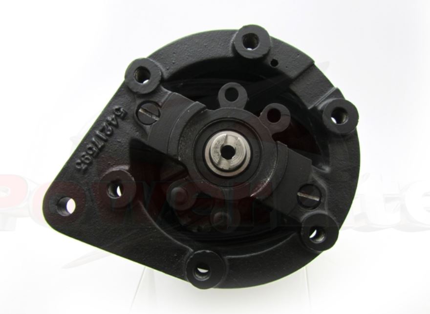

Not sure if you have power steering but a standard alternator will not have the pickup on the back for the PAS pump which is why theses Dynalites are so good as they use all the original housings and the PAS pump fits on the back.
The Dynalites come as + ve or - ve earth but they do not have the ability like the old generator to switch between positive and negative earth so once you have made your decision to convert the only way to go back (not that you would need to ) is to buy another Dynalite with the correct polarity or convert back to the original generator.
Re: Dynamo conversion to positive earth Alternator/Dynamator
PAS Dynalite rear.
