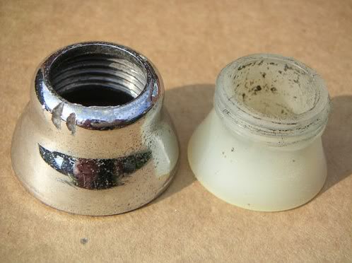

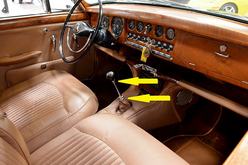

Yes, I have an antenna. #3 has threads. #4 does not. #5 has threads. Understand where #2 goes....thanks. If #3 is the gear lever boot ferrule, then what is this?
Re: Help Joe Again
3 goes on the top of the gear lever leather boot. Your pic above is the gear lever cone that screws up against the round knob to lock it in place.

Thanks Glyn......it looks like #4 and #5 are for the antenna. I zoomed in the best I could on my photos and it looks like they go there. I really appreciate the help. I think all the chrome has been identified if I am correct on #4 and #5.
