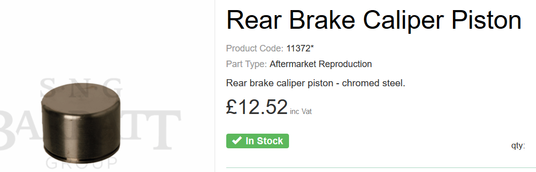

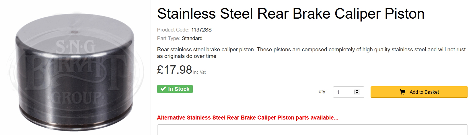

Barratts can supply pistons. I fitted SS. I do not know XJ caliper fluid displacement. Be careful with single circuit brakes or you could disturb back to front braking bias.
Rear brake piston 1.PNG (316.49 KiB) Viewed 3205 times
Rear brake piston.PNG (76.98 KiB) Viewed 3205 times
Rear brake piston SS.PNG (337.57 KiB) Viewed 3205 times

Thanks for the responses. I purchased new SS pistons from XKs Unlimited, however these do not have the spring retraction mechanism in the back like the originals, only a recess where they go. I have been unable to remove the retractors from the old pistons to reuse in the new pistons. How are they removed? If not removable, does anyone supply replacements, or will the pistons work without the retraction mechanism?
Paul
Re: Rear brake conversion
I retained the retractors but while I have not done it I'm told that plain pistons work just fine. As shown in cheaper Barratt's replacements.
