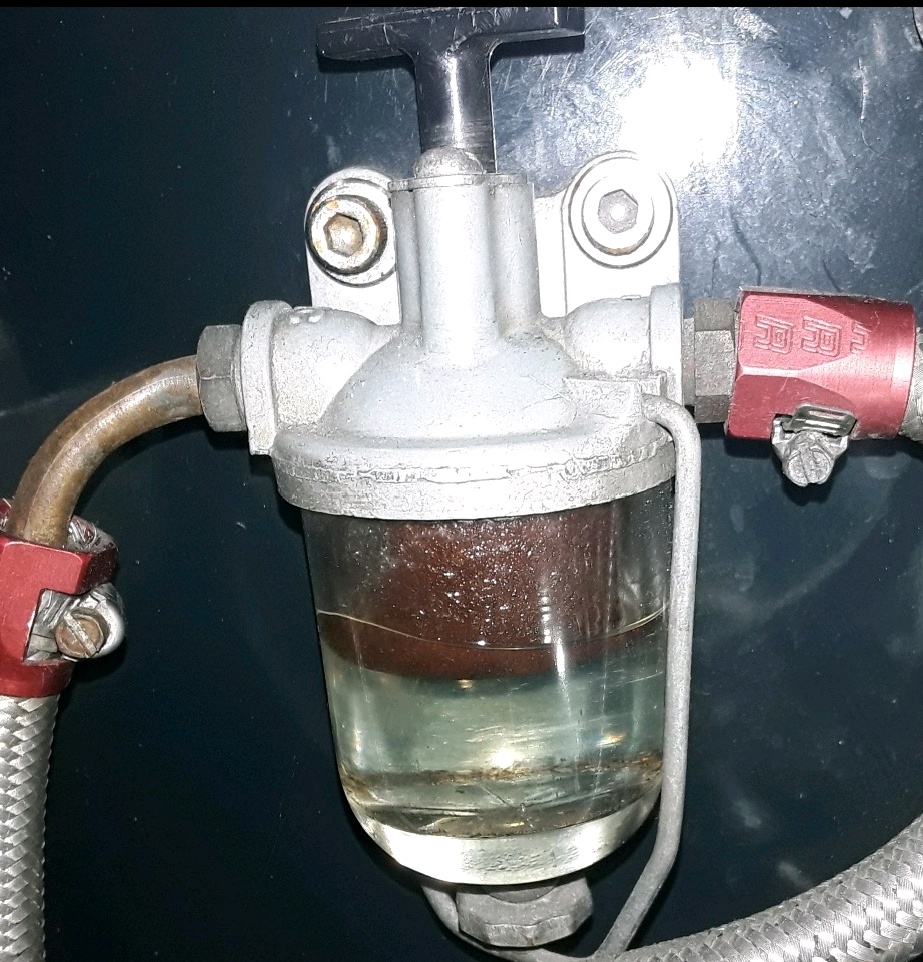

John, if it any help this is my filter after the car has sat three weeks while I was away.
- filter.jpg (352.99 KiB) Viewed 3666 times

I still have the starting carburetor on my car, it was on my XJ that I removed the AED and changed to manual chokes. If you are concerned about fuel flowing back into the pumps/tanks then fit an XJ fuel filter with a shut off tap on top like in the previous photo I posted, it's also useful for working on the carbs and changing the filter not to mention an effective anti theft device.
