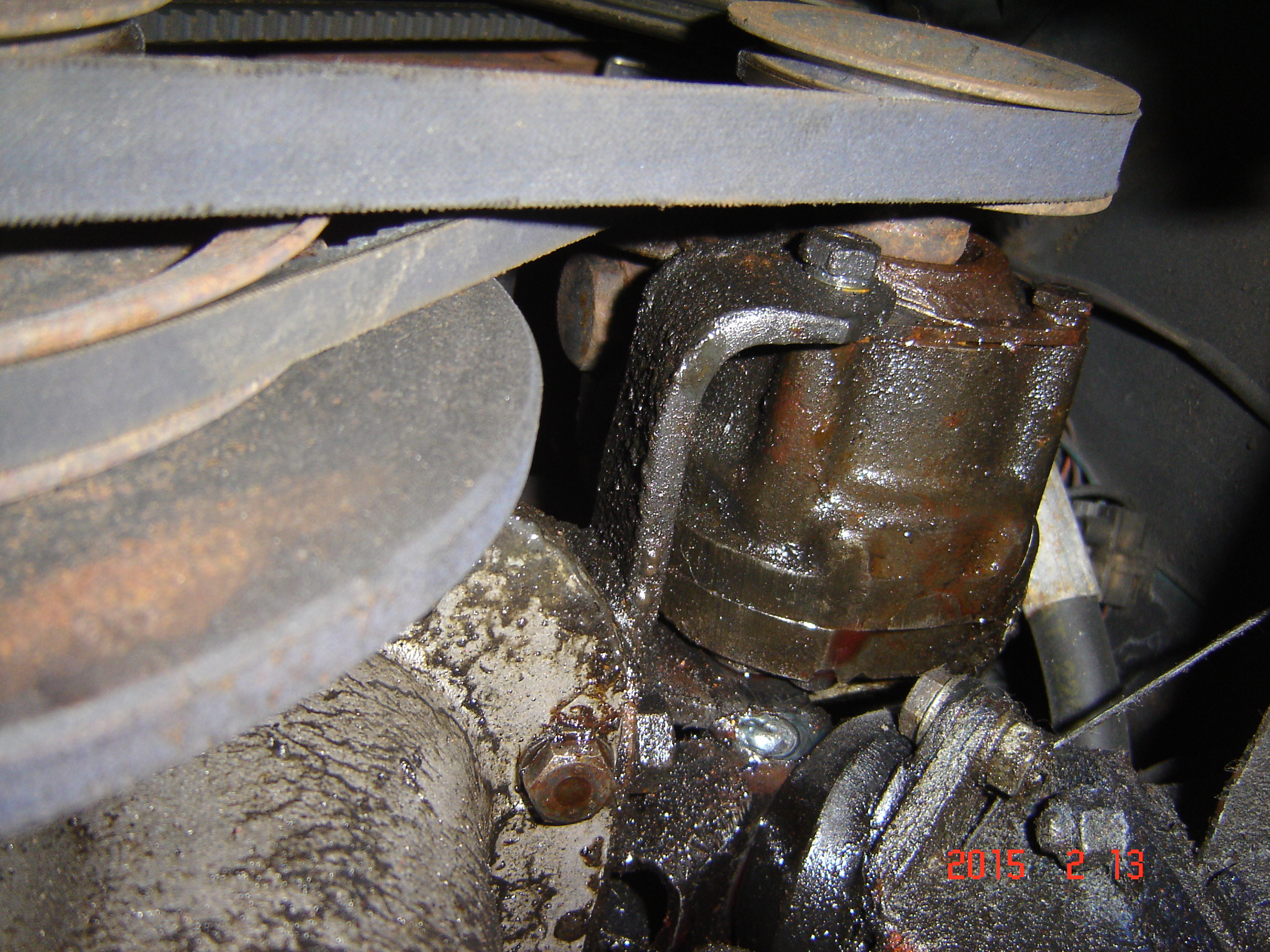

I had a look at some pictures of my power steering set up, and the power steering pump power is taken off is from a duel grooved pulley on the crankshaft. This of course would mean that either a different pump is used or the original modified to take a pulley. when I acquired my car the original pump had been modified but it now has a pump used from an early Range rover that I bought off ebay. If you you don't mind me saying it seems like an awful lot of work and cost particularly if you don't have any issues. I suppose you could change the pump for a pump/motor and attach it to the inner wing. Some of the small cars use this in the past
jag restoration 005.JPG (1.64 MiB) Viewed 3890 times
. As you can see this picture shows an oil leak and that is why the pump was replaced after three attempts to cue the problem.
