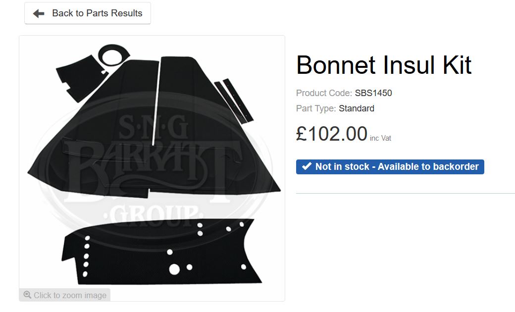

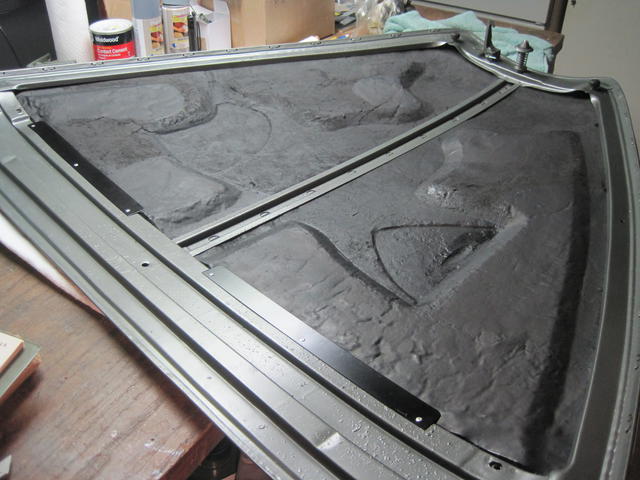

Mine came from SNG Barratt in a kit for a Mk2. Black woven appearance foam rubber material that looks very neat but is not original. Original was moulded glass fibre matting that unfortunately deteriorated. Alan Wiedie on this forum has the best preserved original I have seen.

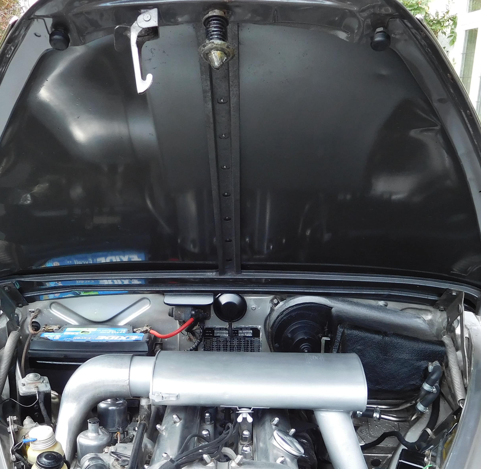

Your bonnet/hood is missing the rear pop riveted retainer strips that held the rear of the liner in place.
Some folk here have fitted hardura felt in this application that looks sort of period.
Kit.

Original.

My car ~ work in progress.

Thanks Glyn. I can't find that product on their website at the moment so maybe it's out-of-stock. It looks as if the retainers came with it?

Re: Under bonnet insulation
The retainers come with it but the Mk2 used 4 rivets to mount them but the S Type uses 3 as with the original pic I show. Don't know how picky you are.
Barratts new website is a disaster. They keep changing what they call things.
Available to order.

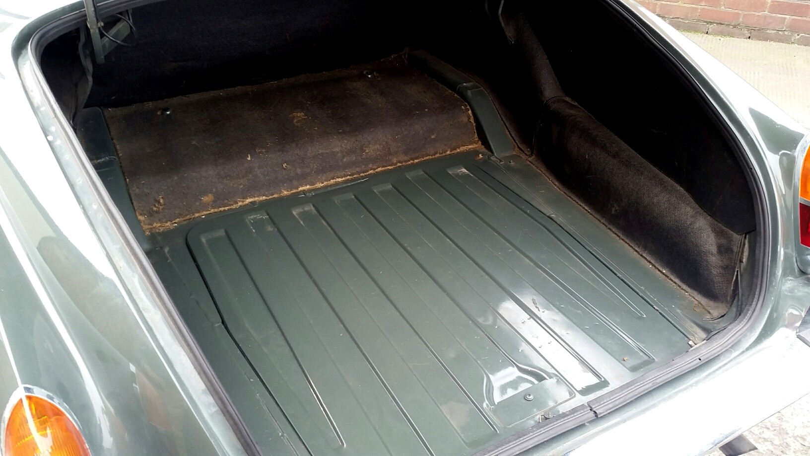

The boot lid has no liner. Just 3 pieces of hardura glued into the 3 triangles. Available from John Skinner.
https://www.john-skinner.co.uk/jaguar/
Original.
For the boot it is crucial that the felt pad is in place over the IRS under the boot mat. And that the Hardura felt is in place in the boot behind the back seat & under the rear parcel shelf that you can just see starting to fall off in the above picture.
