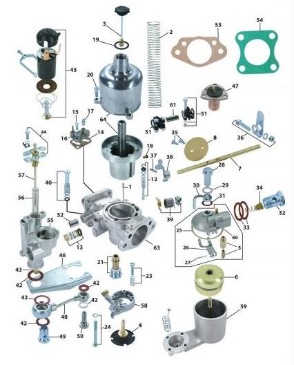

You would need to change item 58 (Jet Housing Assembly) in this diagram in both carbs so you can manually pull down the jets on their diaphragms. Burlen can provide 58 in a number of configurations.

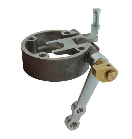

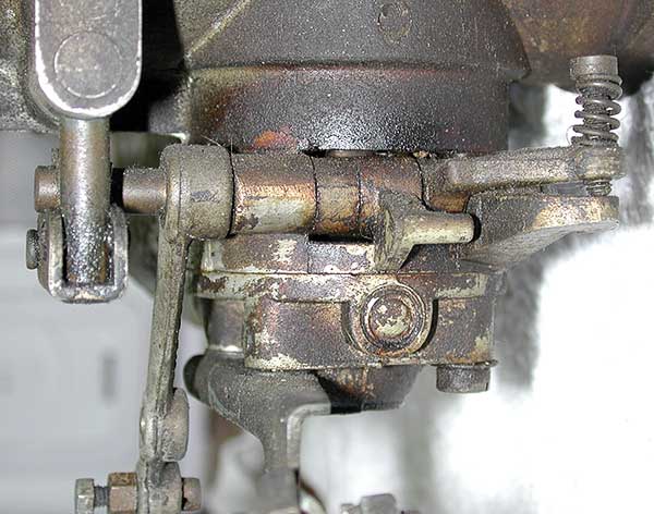

This arrangement as fitted to the E Type for cable activation.

Glyn’s image of the S.U carburetter is a thermo version that does not illustrate the none thermo choke parts listed above. Look for a HD non thermo type, which will show the choke and no AED.

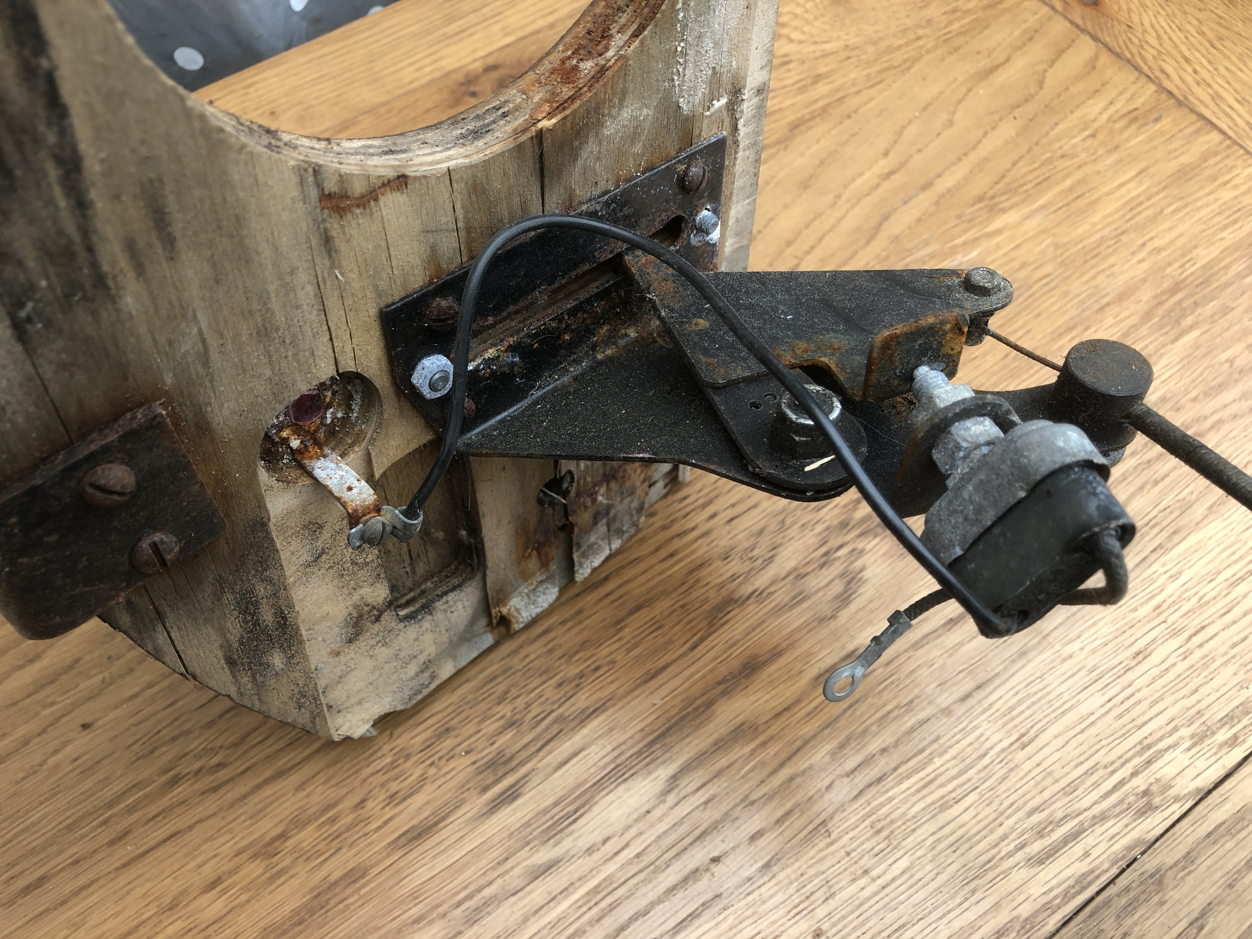

Choke operating slider mounted on a Mk2.
Replacement for item 58 on your existing carb diagram:
2 X AUC 8654
Then as Norman suggests you need the lever link rod (between the two levers), inner cable clamp for primary lever & carb bracket to clamp outer Bowden cable sheath. (see E Type pic above) Burlen can advise.
2 X AUC 8654

Re: choke
Now it just so happens that I have the complete lever, bracket, switch, cable, chrome and escutcheon in my new box of many parts. If you want it John PM me with an offer if not it is going on EBay next week.
