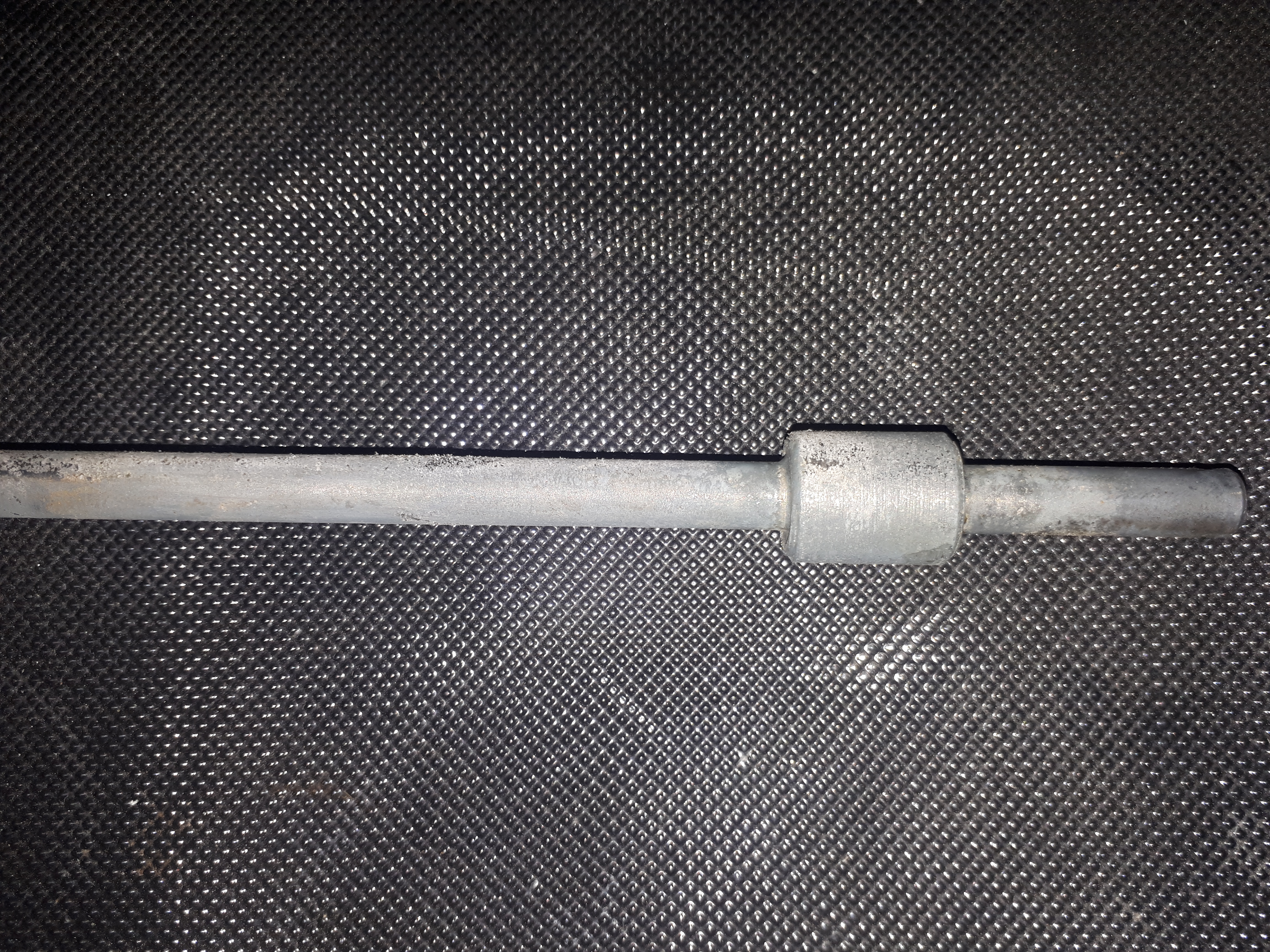

After watching some youtube clips I opted to experiment! It is practically impossible to gather all that needs to be plated and commission them at once, because there are far too many small bits. So, basicly I thought it might be possible for me to plate parts as needed at my own pace. Why not give it a try? So I set up a rather rough setup. No scales no measures, nothing. Just to satisfy my curiosity! Got myself a zinc anode, Epson salt, vinegar, sugar, distilled water, muratic acid and a mobile battery charger. Picture shows left part plated while right part which was just dipped in muratic acid for some minutes. Yesterday I could barely tell the difference, but today I could see that the plated parts is darker and much more dull. More experimenting on the way.

Excellent! That's very impressive. I'm used to the bright silver zinc plate on items you buy - nuts and bolts, etc. Yours is more subtle and less noticeable. Well done.

Apparently a dull finish is normal and one only has to brighten up up by polishing it with some steel wool. Which I havent tried yet. Looking at the picture I had posted, the advantage of plating is visible as rust colouring is noticable on the other part which had been cleaned in muriatic acid. In order to have good results though, good planning and preparation is of utmost importance.

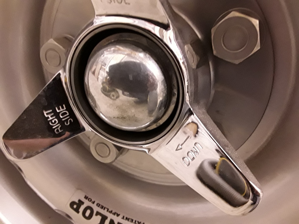

A friend of mine does his home zinc plating for his motorbikes, he did my front wheel hub covers for me. A twist on the usual result as he polished them.
- hub.jpg (209.41 KiB) Viewed 2992 times

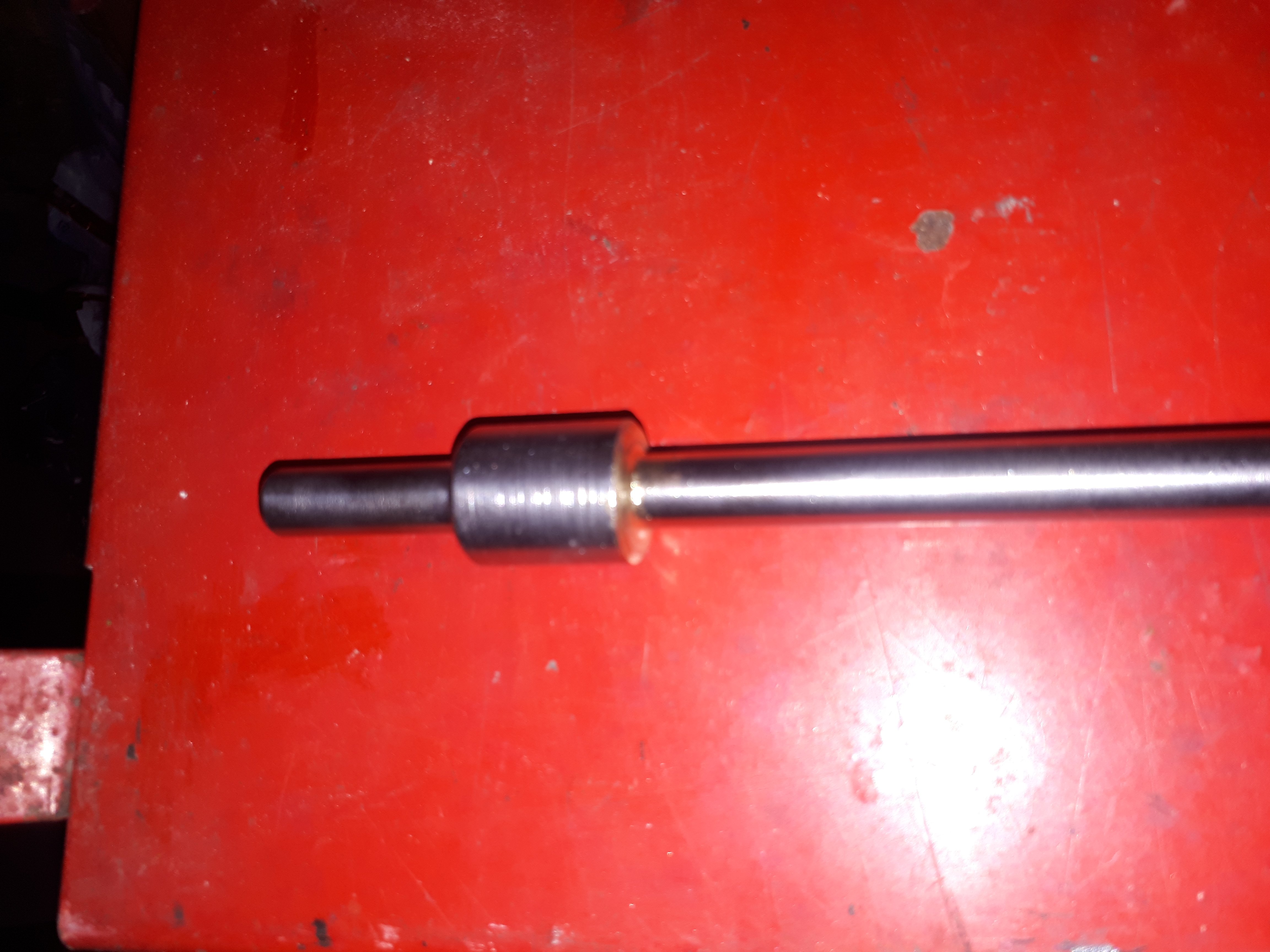

Hi guys, here is an update of my experimenting with zinc plating. One can find plenty of information online, but finally since I am not much into chemistry, it is just a matter of experimenting.
And so I got myself a small fish tank to start with. It included a small filter which up till now seems ideal to keep the electrolyte in movement. Since I read that temperature is also a factor, I bought a submersible heater which I set to 22deg celcius and a thermometer. Water temperature as I started was around 15deg Celsius and it gradually increaced to around 18 or 19deg. By the time I finished plating the throttle rod it did not reach the target I set of 22deg. Don't know if this makes any difference, but the following item I plate I make sure I get the temp warmed up beforehand and see if I notice any difference. I put 10 litres of distilled water in the tank to which I added 450ml of white vinegar, 550grams of Epsom salt and some sugar. Some claim that sugar helps in obtaining a brighter finish. Obviously there are appropriate solutions ready available, but I can't source them locally. On the net I found a couple of companies in UK an Germany who can supply complete kits for DIY, but unfortunately if is difficult to ship them over due to being listed as Hazardous material. So for the time being I have to do with what I find. Still haven't been able to find some kind of brightening agent through as the end result is pretty dull. Once dry, it polishes out nicely though. For the time being, not as bright as newly bought but I am happy with the results.

- Throttle rod plated. Lhs having been polished by steel.wool, while rhs seen as got out of tank. Notice on Lhs there are some bright lines where the rod was held by wire.
- 20190114_212529.jpg (6.67 MiB) Viewed 2976 times
- Throttle rod half submerged in electrolyte since I did not fill the tank completely.
- 20190114_201858.jpg (4.21 MiB) Viewed 2976 times
- Throttle rod cleaned by wire brush.
- 20190114_193428.jpg (3.41 MiB) Viewed 2976 times

Also, I would like to add that I left the rod in the solution for around 45 min either side. That is much more than the information I found online.
