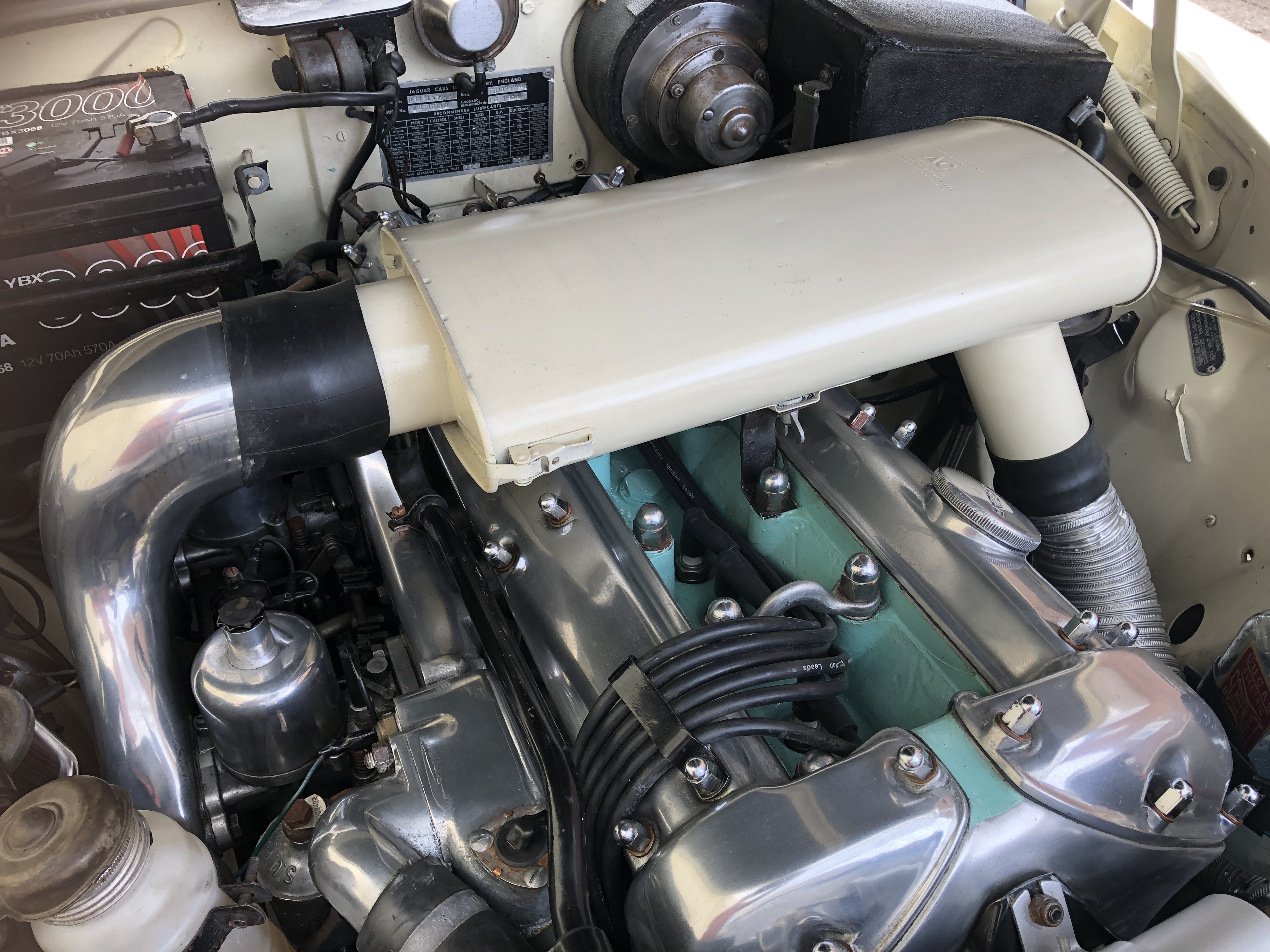

I know Alan had some made and I bought one from him. Alans were for the joint between the bottom of the air filter and the paper cool air pipe. Fits nicely but after time the rubber is becoming hard due to the heat from the exhaust pipe. The rubber band that goes at the top of the air filter housing between the alloy header and filter housing is also not available. A Friend of mine was throwing out a couple of rubber inner tubes from his Austin Healey sprite which takes a 13 inch wheel. I cut these up into a 4 inch band and it slides quite nicely over the joint. They were not 100% tight but have tightened up with the heat of the engine over the last year or so. They do not move about and look the part.
A 13 inch inner tube on EBay costs £6.90 with free postage. https://www.ebay.co.uk/itm/184440390727 ... SwFGxfWPXV but if you wanted it tighter then a 12 inch tube is also available. https://www.ebay.co.uk/itm/353019818633 ... Swx9peedkV
Although the 13 inch diameter is too large for the bottom joint there is no reason a piece of the same inner tube could not be cut into a square that can be wrapped around the lower joint and glued together using a strong rubber glue. The join can be positioned so it cannot be see.
I would have thought a 10 inch inner tube might suffice for the lower joint and they are only £3.44 https://www.ebay.co.uk/sch/i.html?_from ... =0&_sop=15

Cheaper to buy a 10inch inner tube and make your own Glyn. You could make five or six out of one inner tube.
Re: Air cleaner rubber seal
Agree
Not too many cars in the USA with 10 inch wheels, just classic Minis, but maybe a wheelbarrow innertube would work?
That would do John as all you are after is the rubber that you can cut up into a band so not interested in where it comes from.
