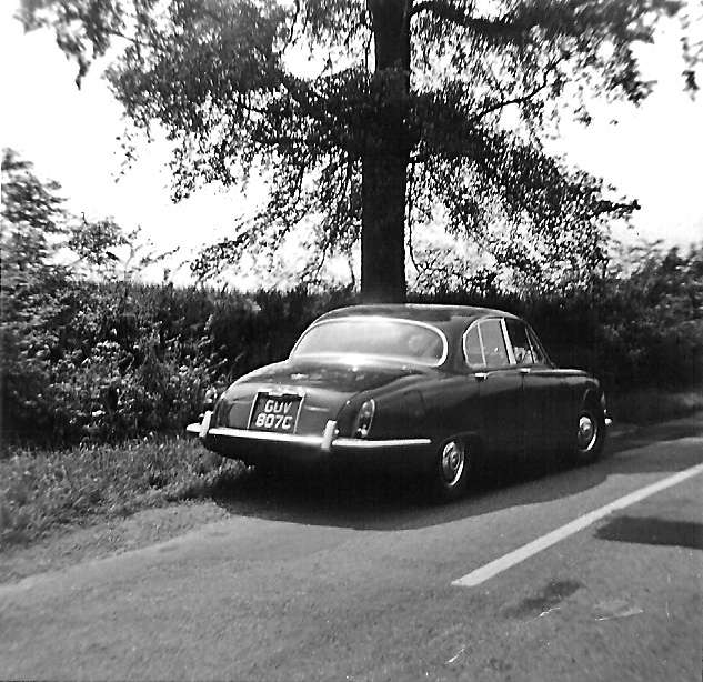

The earliest photo I have is from 1974, taken on my Kodak Instamatic:

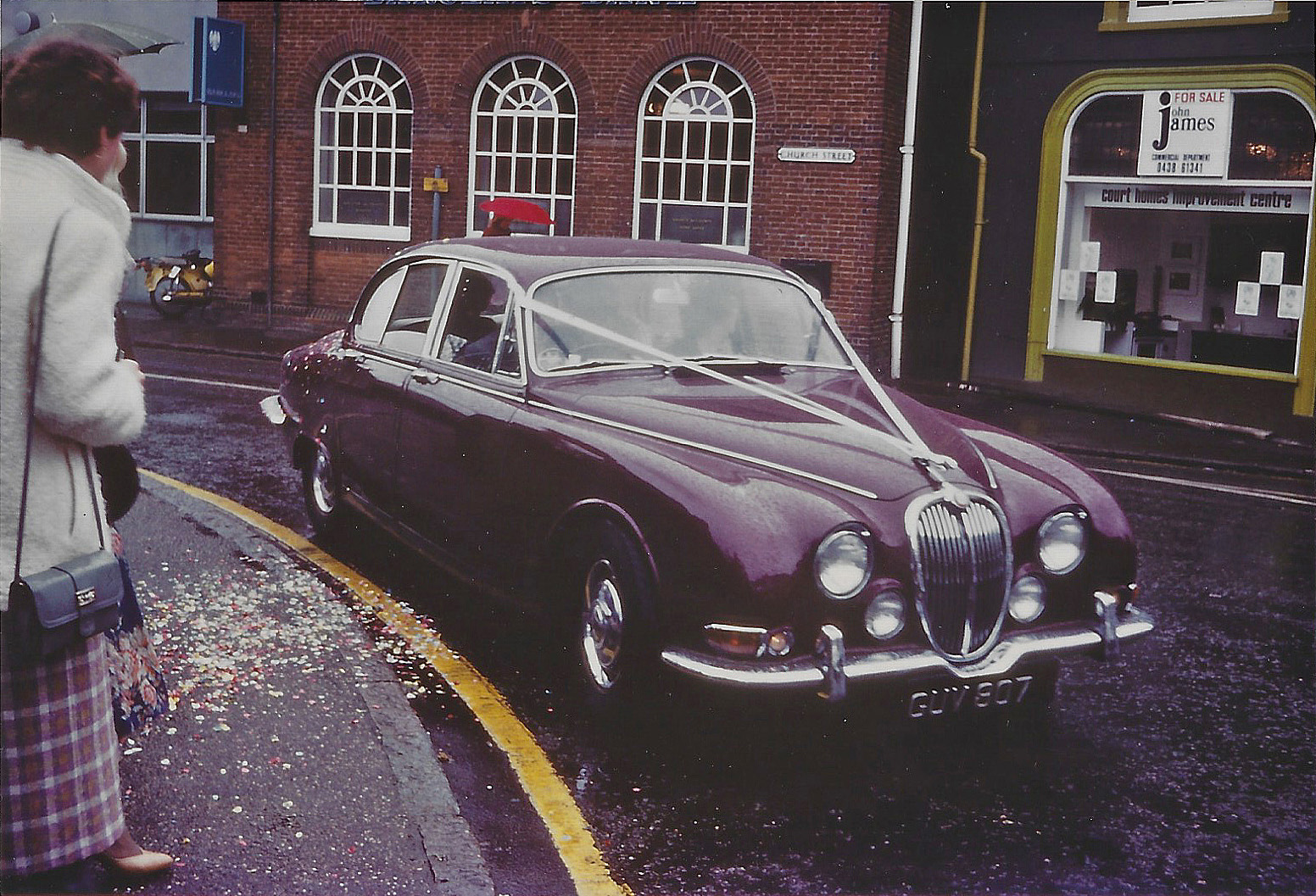

Slightly better pic - and substantially better weather - from my sister's (first) wedding in 1985:
1985 08 24 wedding of my sister shelley cropped.jpg (204.76 KiB) Viewed 6858 times

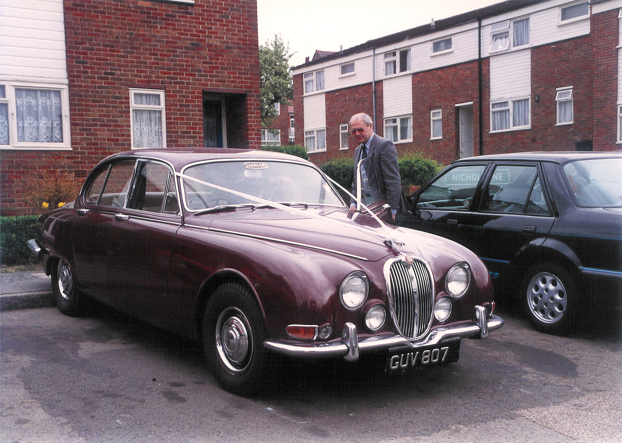

And here's my Dad putting the ribbons on the car at my sister's second wedding in 1991:

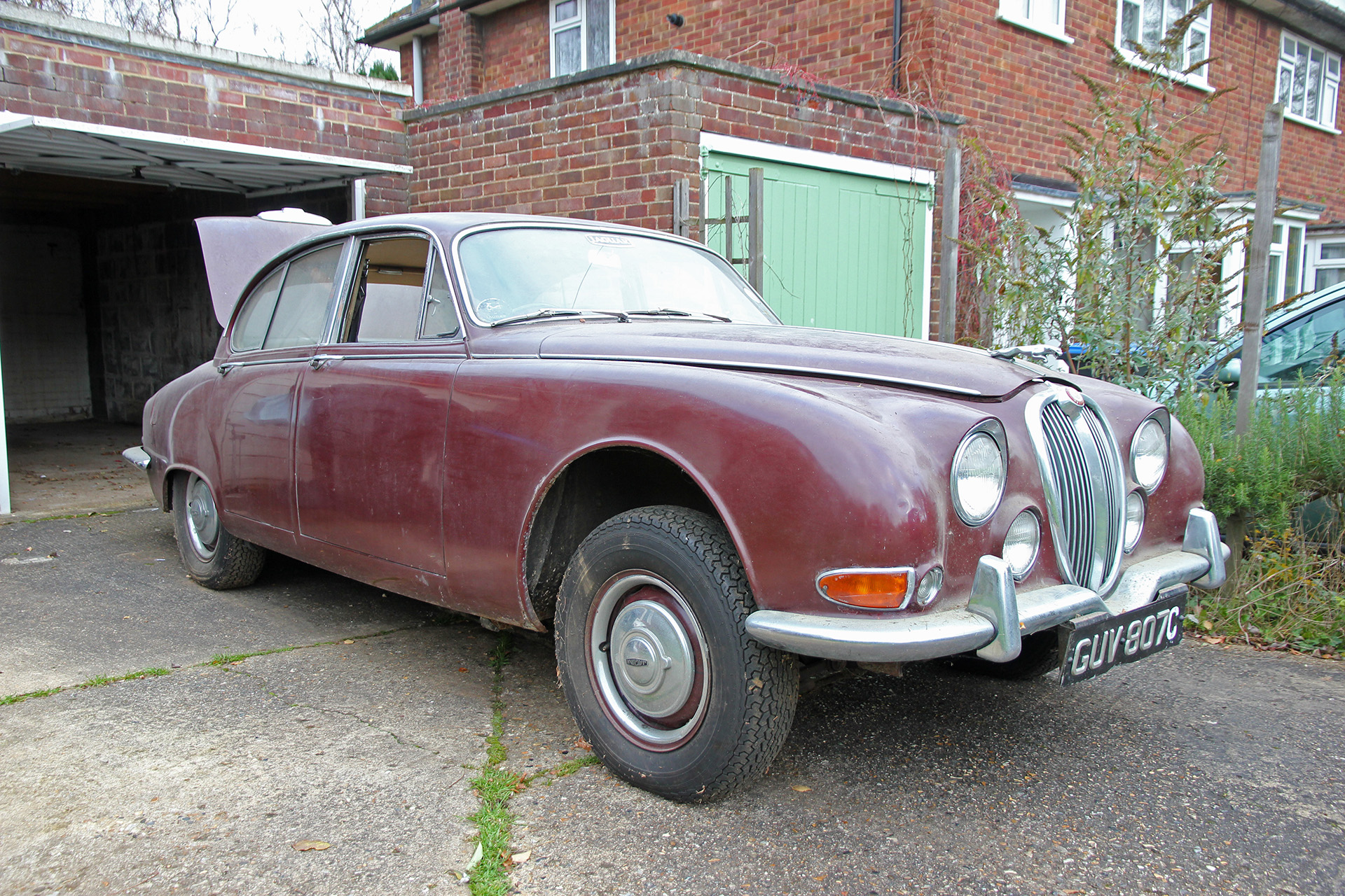

In 1994, it came off the road for an engine rebuild and my dad never got round to finishing that, so 1994 - 2013 were spent in various garages. Here was how it looked when I inherited it in 2013:

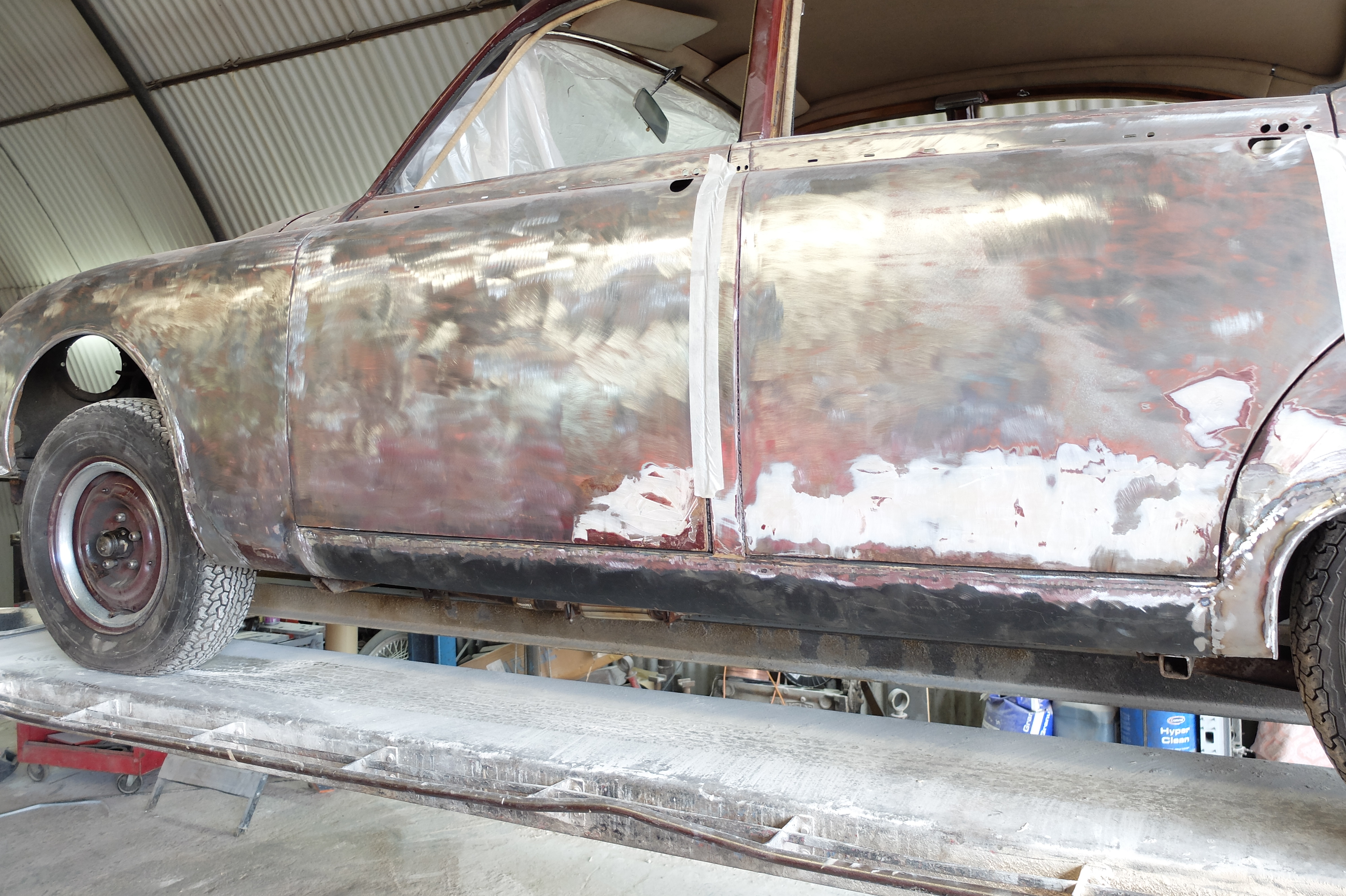

A fairly comprehensive body restoration commenced in 2014. One joy of working on this car was that we knew what was under the paint and there were no nasty surprises. That filler is from the 1960s repair, still in amazingly good condition. You can see the wheel arch repairs. It also had welding around the front idelights/indicators, new inner and outer sills and also needed a new rear valance - the only new panel. Floors and chassis rails were all fine thanks to liberal coatings of ATF over the years, courtesy of Borg Warner:

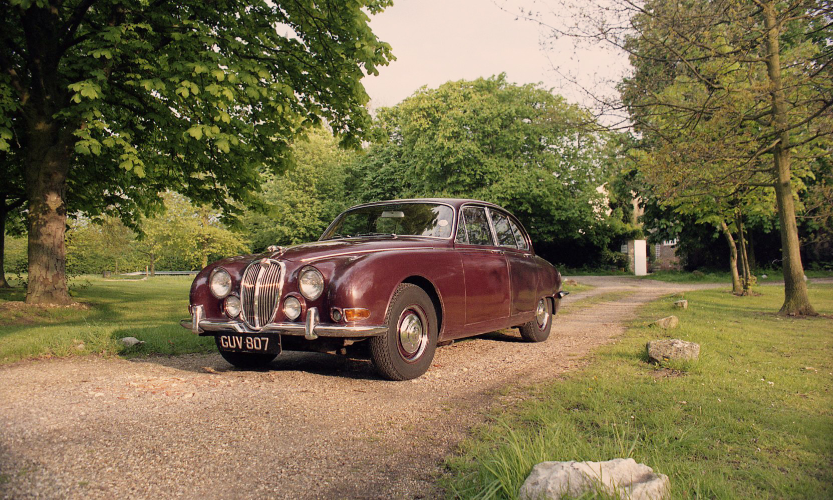

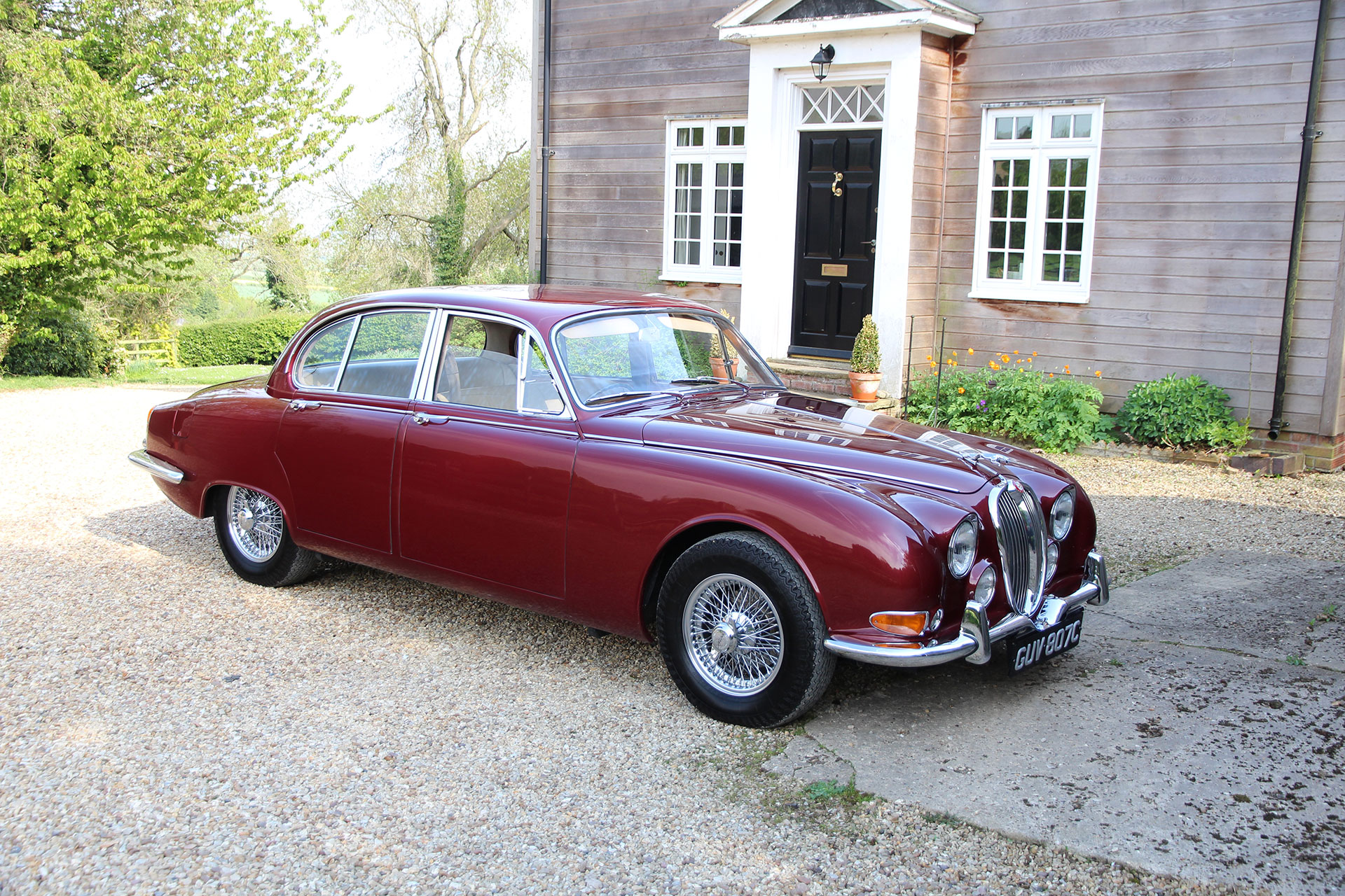

Finally back on the road in May 2015:
I've done 6,000 miles since the rebuild, without any major incidents. It's only stranded me once when the front propshaft UJ failed. Upgrades from the original specification are:
Marles/Adwest Varamatic Power Steering (as the last S-types had)
Coopercraft Front Brake Calipers
123 Distributor, currently using Curve 6
Chrome Wire Wheels
Claytons upgraded heater

Beautiful colour and I have said it before and will repeat it again the Wire Wheels really make the car. Looks so sporty with the wires rather than the old dowdy steel wheels.
Great job and a lovely history. The provenance really makes the car. Love the old photos.

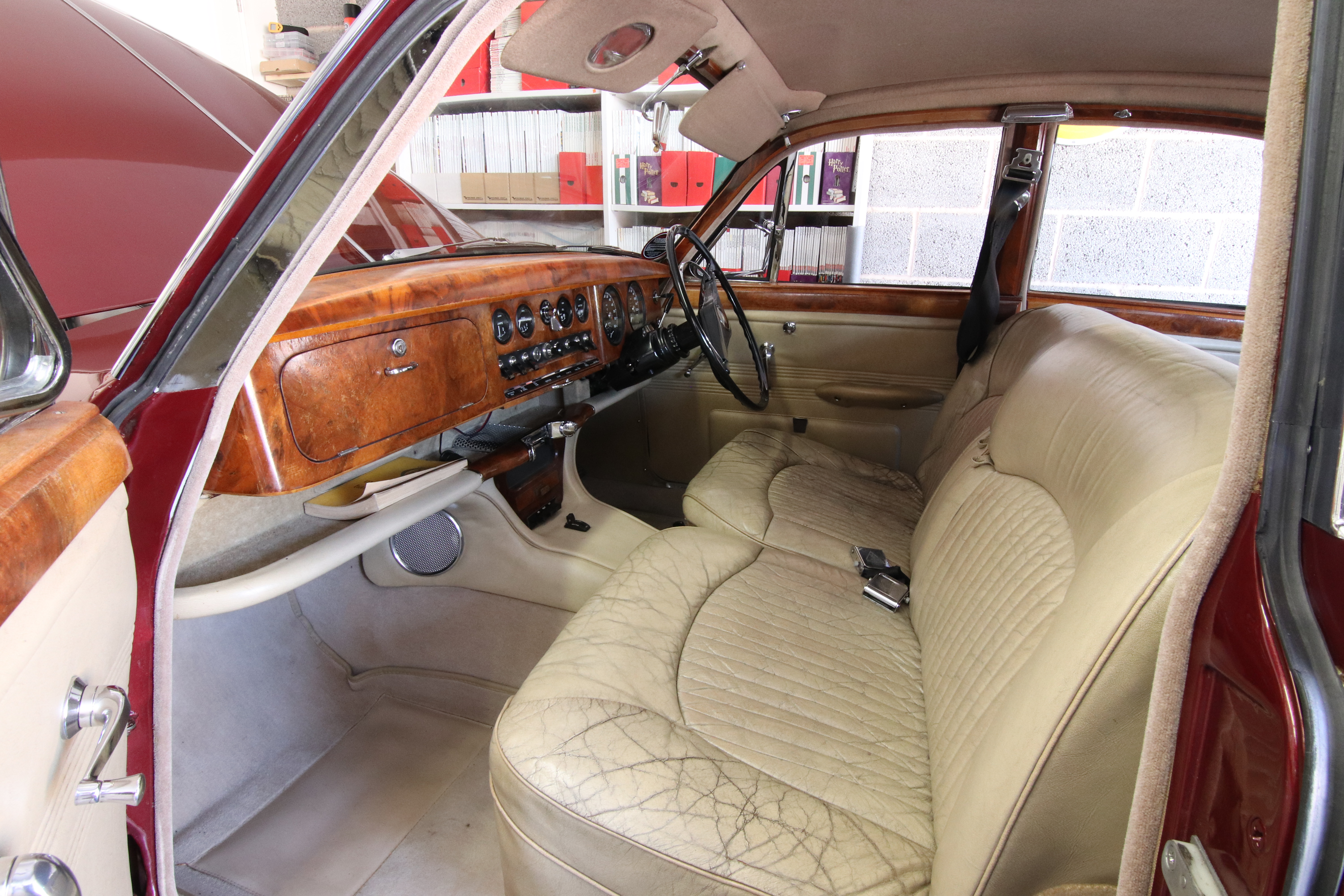

Interior is more or less untouched, apart from new carpets and refurbished steering wheel:

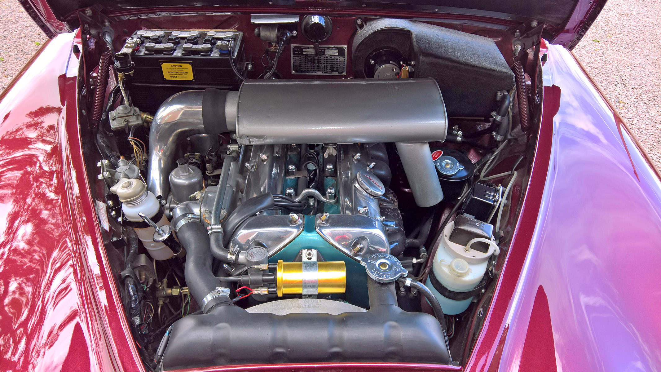

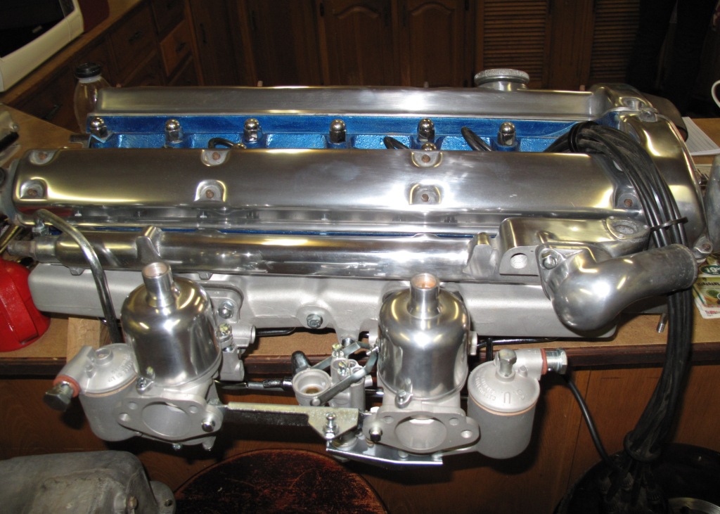

I've tried to keep the engine bay period-correct, but there are one or two departures from that. And the engine rebuilders didn't check where the blue paint between the cam covers should stop (though they made such a good job of the rebuild at such reasonable cost, that I forgave them)!:

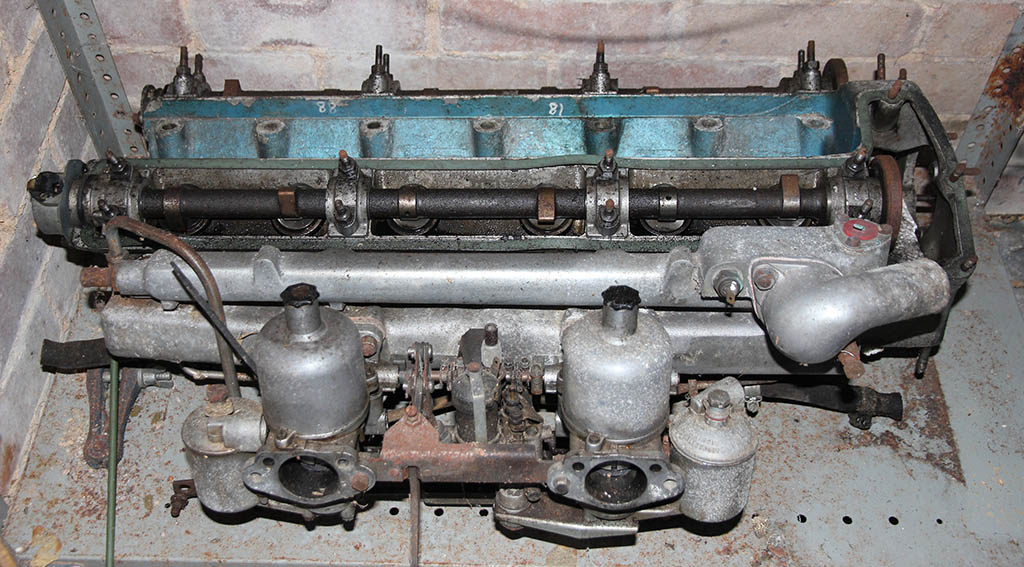

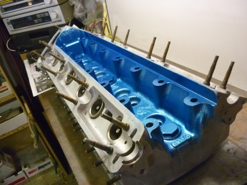

Again stunning. What I like is that it has still got the patina of age but has been restored in all the right places. With the Engine paint though and I know I am colorblind and being picky but is that not Duck Egg Blue which is for the 3.4 head instead of the Dark Blue that should be on the 3.8. Only a Nerd like me might see it but it might also be the colouring of the photo and I am wrong. I have attached a photo of my Duck Egg Blue head on my 3.4s.

Re the blue, it was the SNGB dark blue. It started off a bit darker but seems to have faded somewhat. I don't think it's too far off the original, though:

You are right it does look closer to the original blue than my Duck Egg when you see the original blue paint on the head.
Re the Jet washer I think if you do it too many times with the wheels on you could get some water in to the bearings and hub as it is under a lot of pressure but I take my wheels off the car every six months or so and jet wash them front and back with a good scrub between the spokes just to tidy them up before the shows and weddings season. The splines are regreased when they go back on.
Looking at your cam covers and comparing them with mine now I really must take mine off and give them another polish. They were shiney bright but faded over time and you cannot polish them too well in situ. I originally sprayed them with a high temp lacquer to protect them but this turned yellow after a year or so and I had to scrape it all off and go back to bare metal. (see new Topic Cam covers)

I learned from my engine builder that the easiest way to polish the cam covers, carbs etc. for an original look is by hand with Autosol & newspaper. I did not believe him but he turned out to be right.
The metallic blue for the 3.8 litre, 8 to 1 compression head varied. Mine is a direct copy of my original colour.

Wow, you could eat your dinner off that engine, Glyn!
Yes, that blue is quite a bit different, isn't it? Was your engine originally assembled in South Africa? My blue was darker when first applied, but as soon as the engine was run, turned to its current colour.
