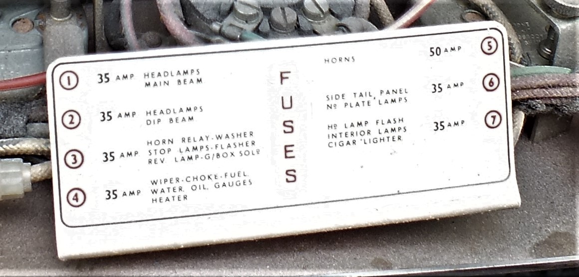

John I have an Auto box so can't help with specifics but from my knowledge of working with my own wiring loom apart from the radio I cannot recall any inline fuses. All my fuses were/are situated behind the dash panel and all the wiring is centred around these eight fuses. Having said that looking at the aluminium plaque in the front of the fuse box there is no mention of the O/D.

It's an inline fuse usually in a red holder to protect the solenoid should it not come out of engagement current to holding current. Early cars did not have them so you burnt out the solenoids.
Re: Overdrive electric circuits
Glyn, That makes sense. Many, many decades ago we burned out a replacement solenoid as the installer did not understand the importance of correct adjustment. Apparently, my November 1964 build car does not have the inline fuse. I only saw it on my large color wall poster of the wiring diagram which is apparently for later cars. Thanks for your reply.
A pleasure. A '64 won't have a fuse fitted. The engagement current is 20 Amps. The holding current is 1 to 1.5 Amps
