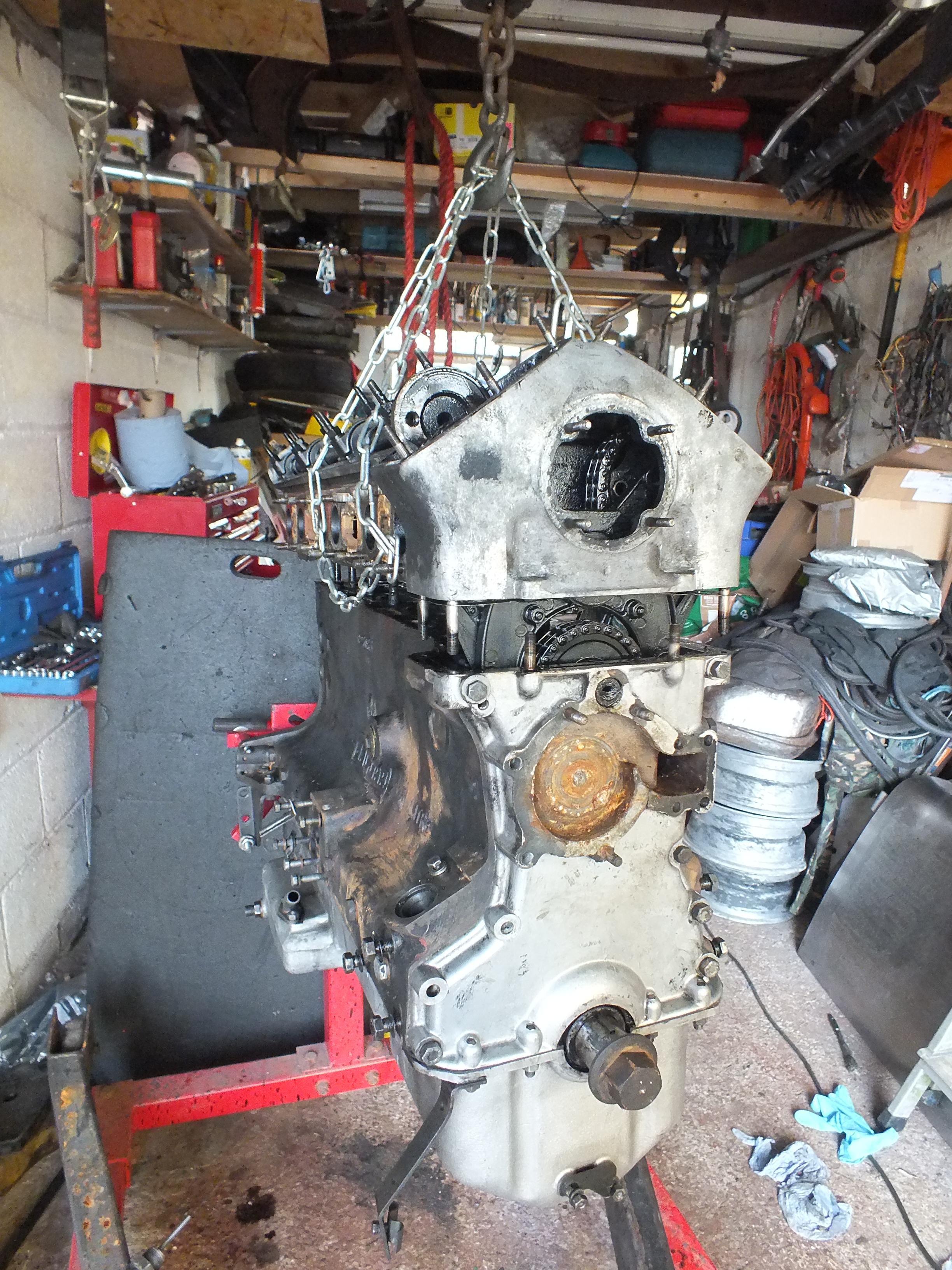

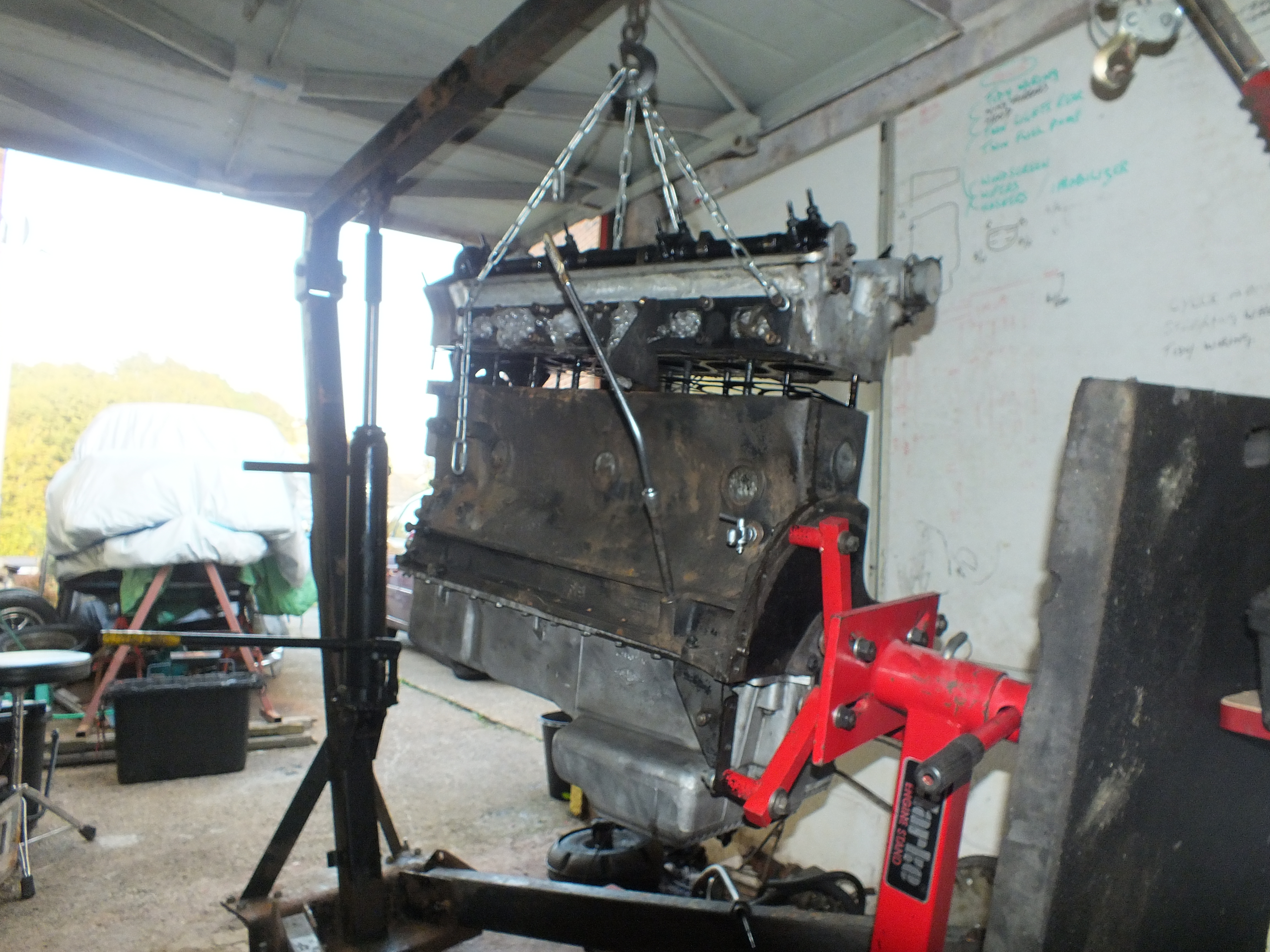

The only advice I would give at the moment is the hard part is often splitting the head off the block. Even though it is made of aluminium it is heavy and has to slide up over the studs. Some times there can be corrosion between the iron studs and the alloy head which causes the head to stick. The other problem is unless you lift the head evenly over the studs you can have it jam up as one end lifts and the other does not. When taking the head off it is more than a two man job and I would recommend lifting the head off the block using an engine hoist or crane. This way you can exert even pressure as you lift, it also allows you to lift without having to use crowbars between the head and block with might cause damage whilst lifting. I had my engine out on an engine stand and was able to lift the head off by myself using the engine crane method but there is no reason this method cannot be used whilst the engine is still in the car.

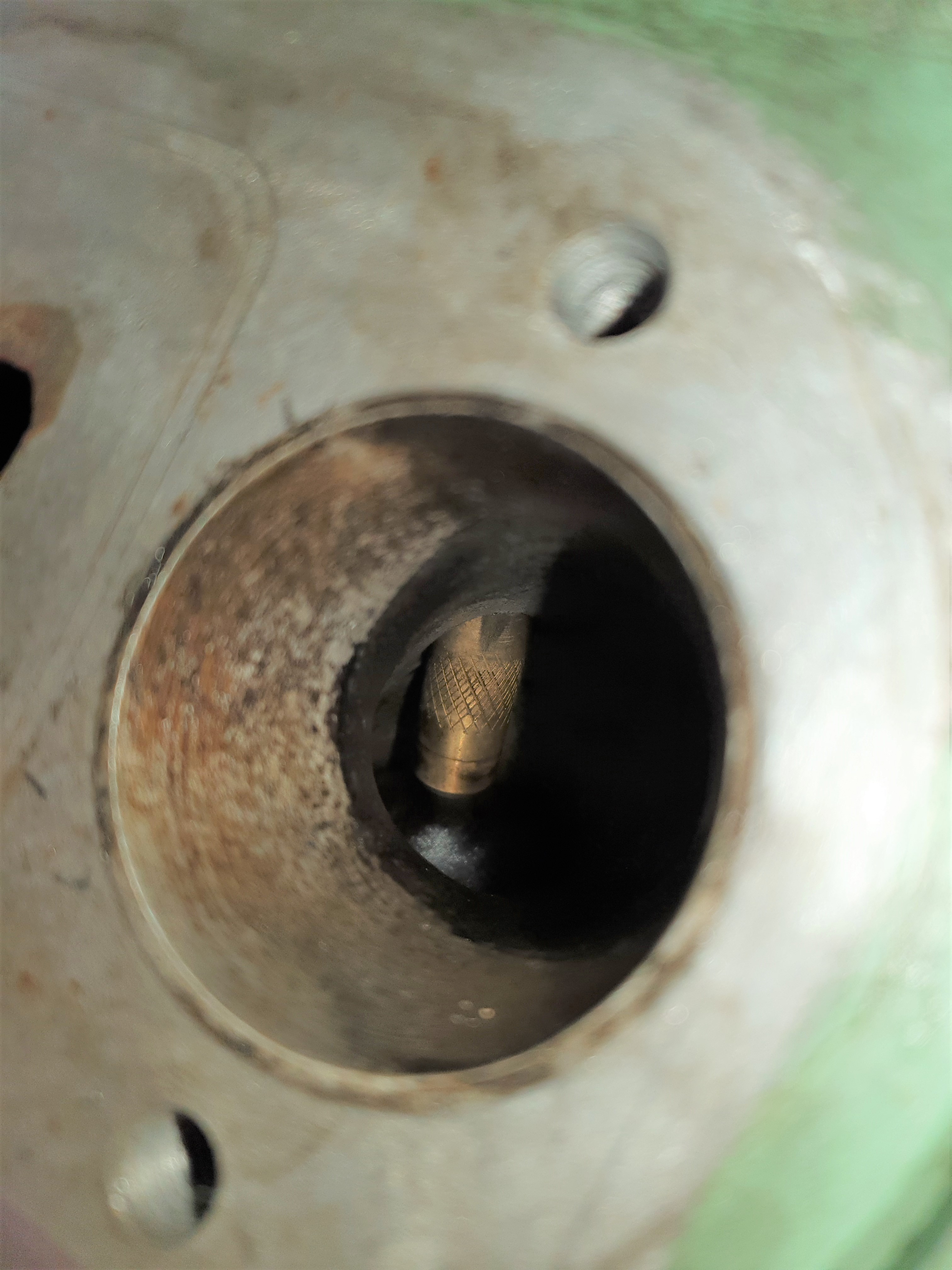

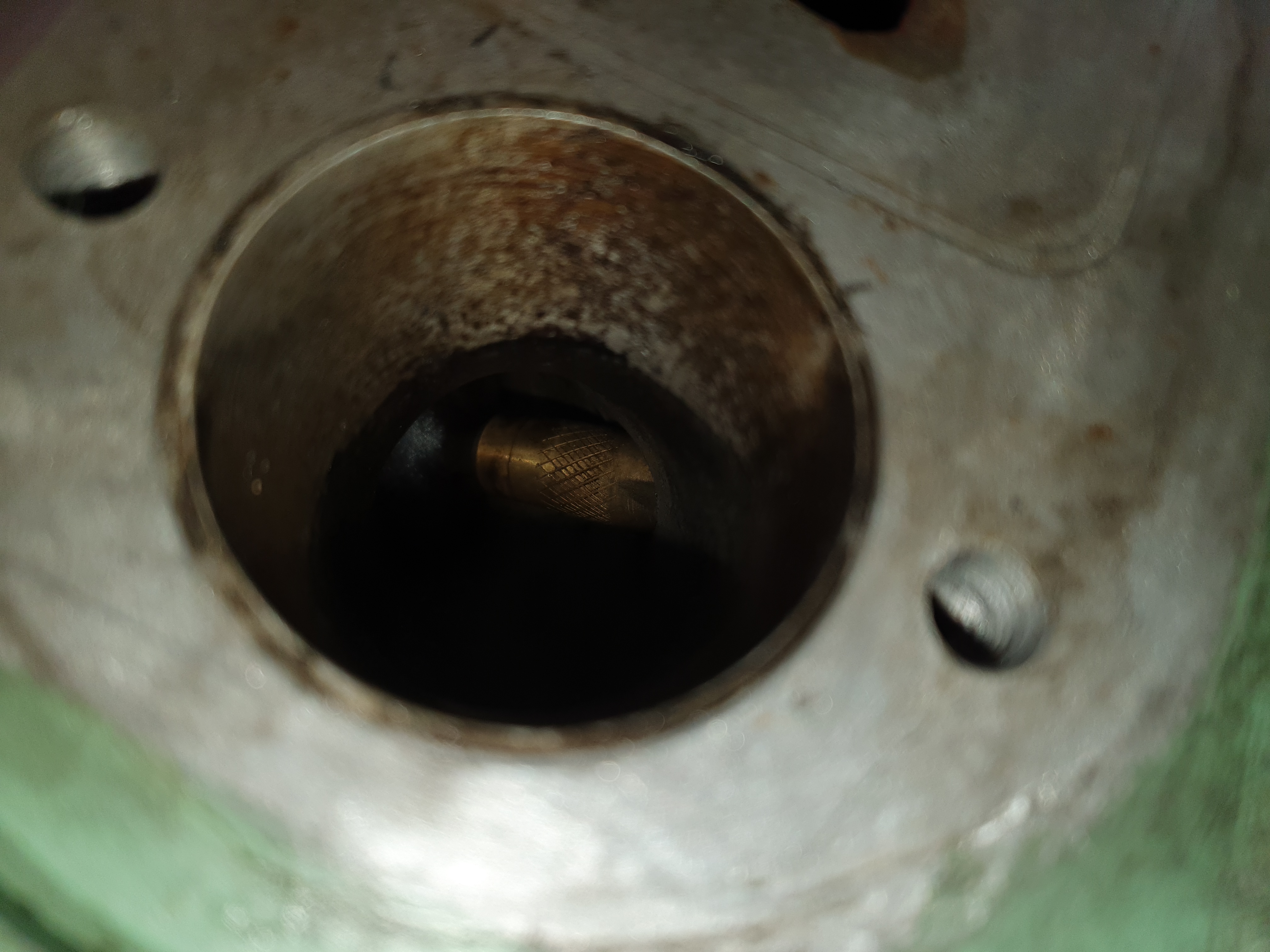

After removing the 'smoking' head but before replacing I together with my classic jaguar consultant decided to try to find the toot problem and started removing with a compressor the valves from the head one by one]. Arriving at nos 6, all was revealed I have heard of a dropped valve guide, I can now say I have seen one ! I have forgotten how to attach a picture, I wanted to show the dropped valve, what I have done is put it as an attachment file but I don't think this is the way to do it.

Thought I would clean up and brighten up your photo for you so you can see the dropped valve guide more clearly. Interesting as I have never seen one before. Good to find a problem even if it is bad. There is nothing worse than stripping the engine down and not finding anything but still no wiser to what the problem was.

That valve guide looks familiar, the same thing happened to my engine. I can't remember now but I think I had the machine shop fit over size (outside diameter) guides, this was back in 1980. When I did the latest rebuild in 1998 I had new guides machined from solid bilit to get a good fit.
