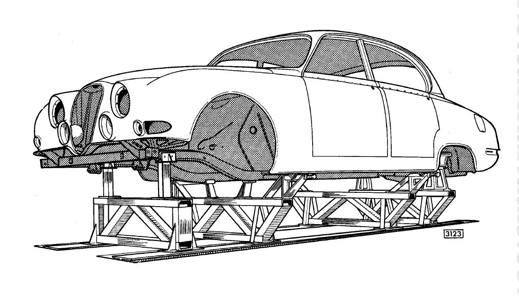

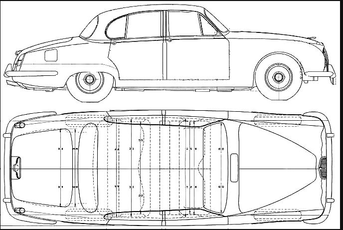

Just started restoring my '67 S-Type and it appeared it had some minor accident in the front.
The body needs to be put on a frame and straightened as well as checked if all the reference dimensions are correct.
Does anybody have some dimensions chart to do that?
Or where could I find one?

Read the blue Service Manual from pages N28 to N36 including the diagrams ~ you should find all the measurements you want.. Below download & blow up.
That's it from Jaguar without the Churchill Jig.
Highest Res I have.
Body alignment Jig.JPG (124.28 KiB) Viewed 2853 times
Re: Dimensions chart needed
Here is another one ...
Jaguar 'S'-type Dimensions.JPG (77.62 KiB) Viewed 2365 times
