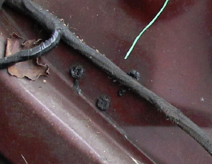

We have a new member from Australia (P1B4351BW). His car does not have power steering. It has the ‘P’ prefix on the data plate, but the chassis number in the bonnet catch channel does not.
There are holes where the power steering reservoir would be normally attached with rubber bungs plugging them (see attached photo).
Question 1: Were the holes in the fenders of all cars and plugged on those without power steering fitted?
Question 2: Does anyone have a car where the two chassis numbers differ in prefix (or suffix)?
Question 3: As the two chassis numbers differed when the car left the factory, why and how might it have occurred?
- power steering reservoir mounting holes plugged
- power steering reservoir mounting holes plugged.jpeg (154.04 KiB) Viewed 4844 times

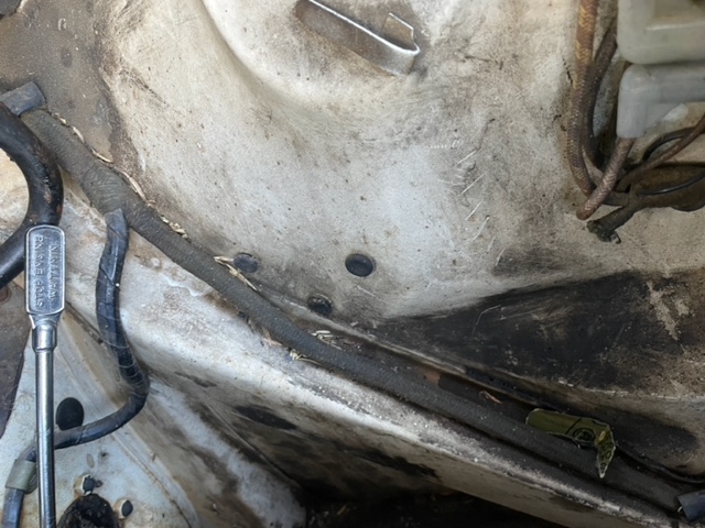

My car was originally non-PAS and had the holes present with what look like the remains of rubber bungs.
Seems most likely to have been an error at time of manufacture.
