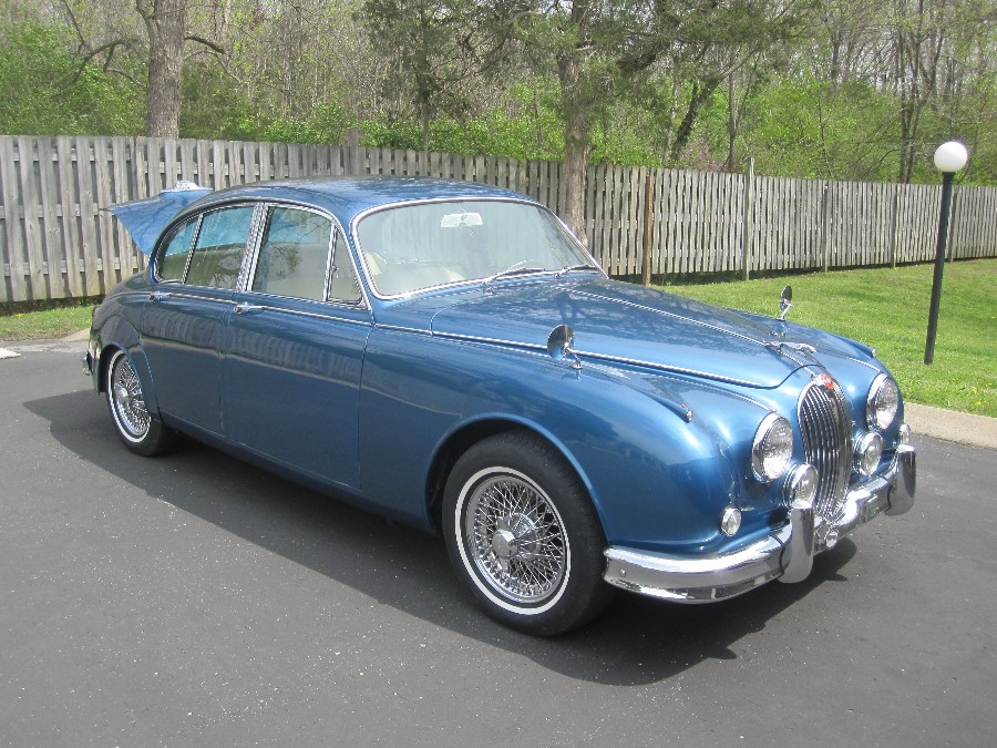

it was my friend Lynn Crook of Lebanon Tennessee who did these hinges.
I found a buyer for his wonderful MK2, a guy in New Jersey. The whereabouts of the car is unknown to me, I think he resold it.
I asked Lynn for drawings or specs of the hinges to make them for my S type. At the time of selling the car, Lynn had become ill and could not do anything. Last time I asked him was in 2014 and he said he could not find any paperwork on the hinges.
All I have is pictures of the car and of the hinges.
you can possibly make them from the pictures. If you do, make a set for me. Thank you!

here you go.
The last picture is Lynn and the Mrs., very fine people.
Lynn is an aviation engineer, lived in Alaska and did crop dusting flying, where they fly 12 feet from the ground.
Last I heard he was restoring a 1930s airplane engine.

Thanks Jose that I think is the one I saw. I should be able to replicate the hinges from the photos and I will be sure to make a set for you. I think the bonnet would be very heavy to lift with these hinges as the original has a large spring to assist so I might have to add a couple of the gas filled telescopic boot props you can buy these days to assist with the weight and to stop it from falling back down in a hurry.

the Mk2 has the same springs, Lynn eliminated them.
the special hinge has a lock on the right side hinge which locks the hood in place when at 90 degrees. Similar to the Stay Lock in the XJ-6.
the design itself, some kind of pantograph design, lifts the hood very smoothly without much effort.
the only danger I can anticipate, is if the hood were to come open at speed and became unlocked at the front. You can imagine what would happen.
