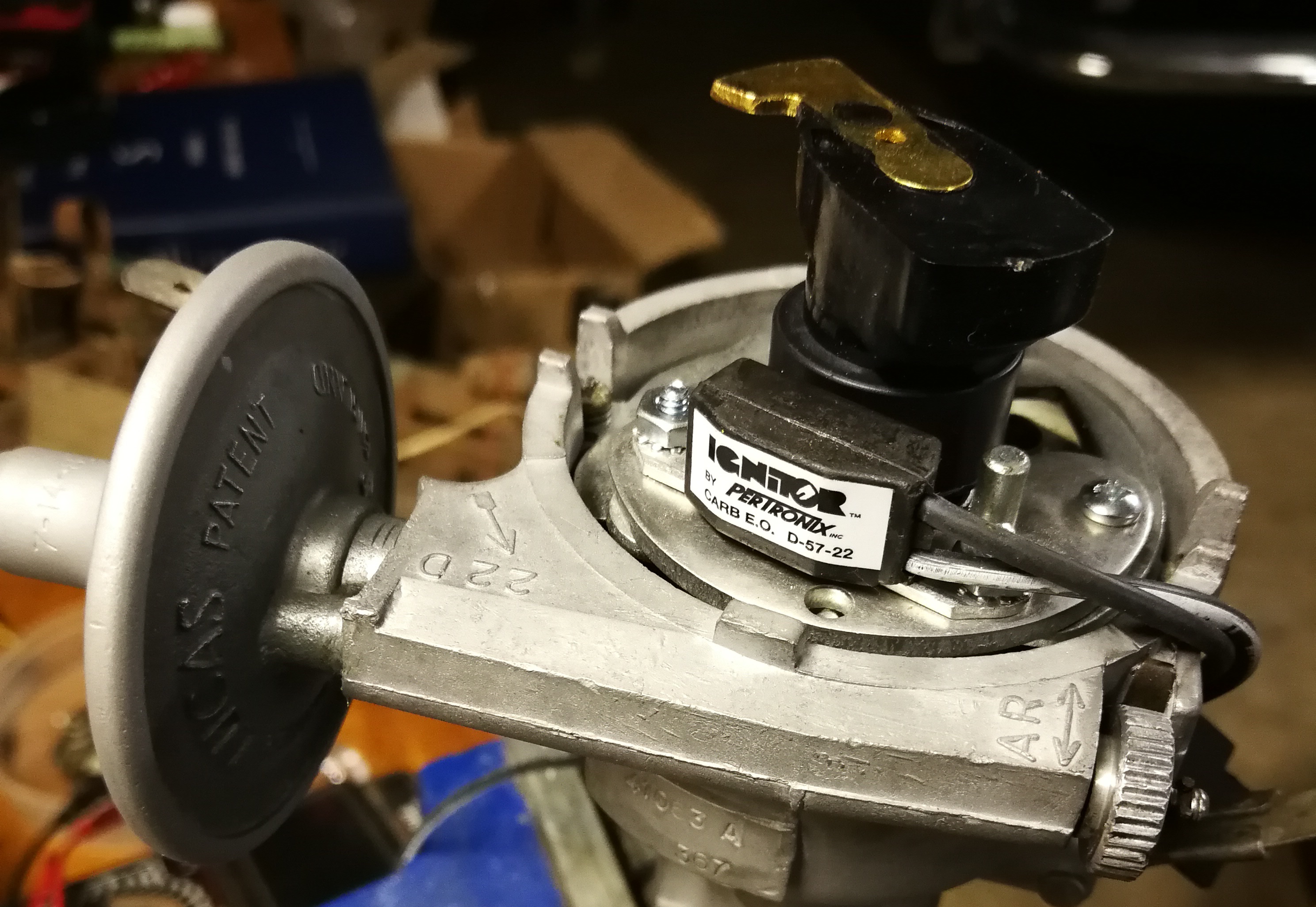

22D6 is correct for our engines. 41063A to be precise for the 3.8. with 8 to 1 CR. The Mk2 unit from Moss should do fine. The listing of different Lucas distributors is huge. I have it. See 20 page pdf below.
IMG_20180205_200304 - Copy.jpg (1.5 MiB) Viewed 3265 times
