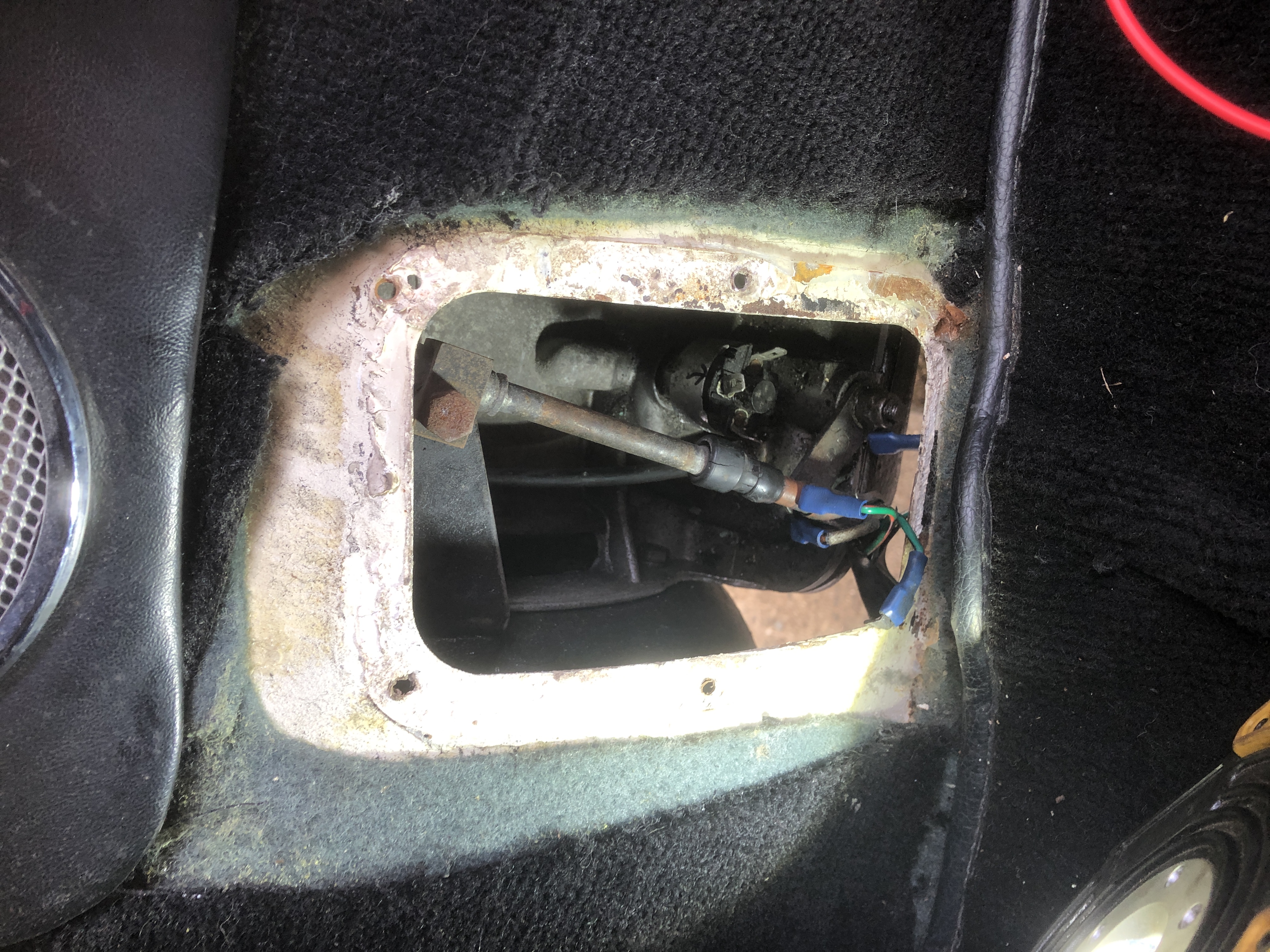

To get to the inhibitor switch there is an inspection panel on the left side of the gearbox tunnel under the carpet held in place by six cross headed screws. Access is good and once the four wires are removed, making a note of where they all went, the Inhibitor switch is unscrewed from the side of the gearbox.

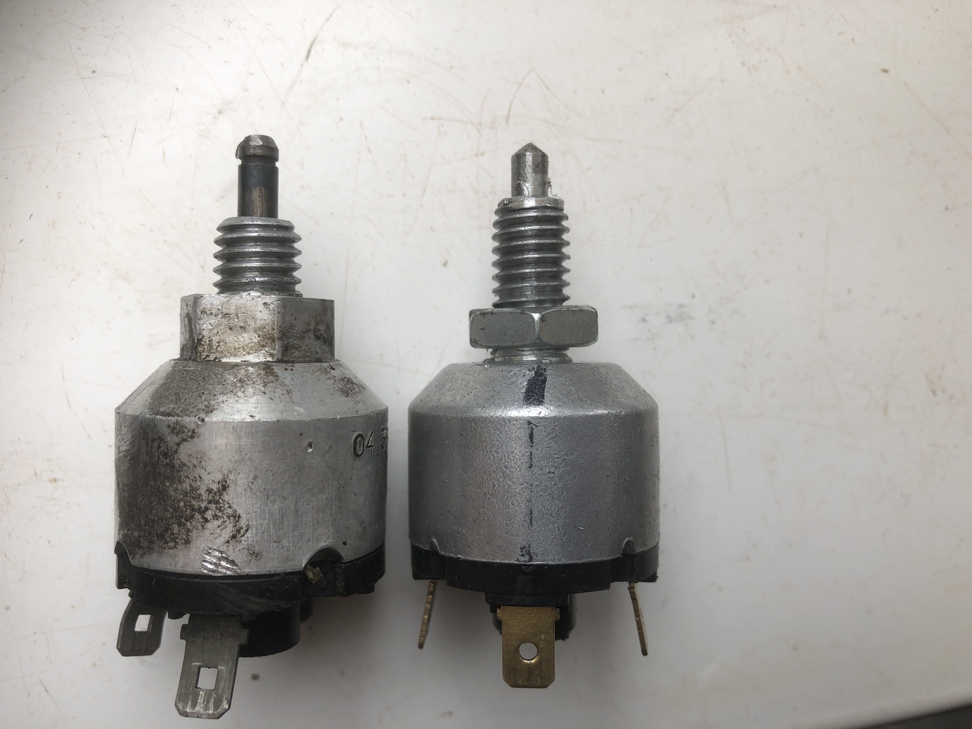

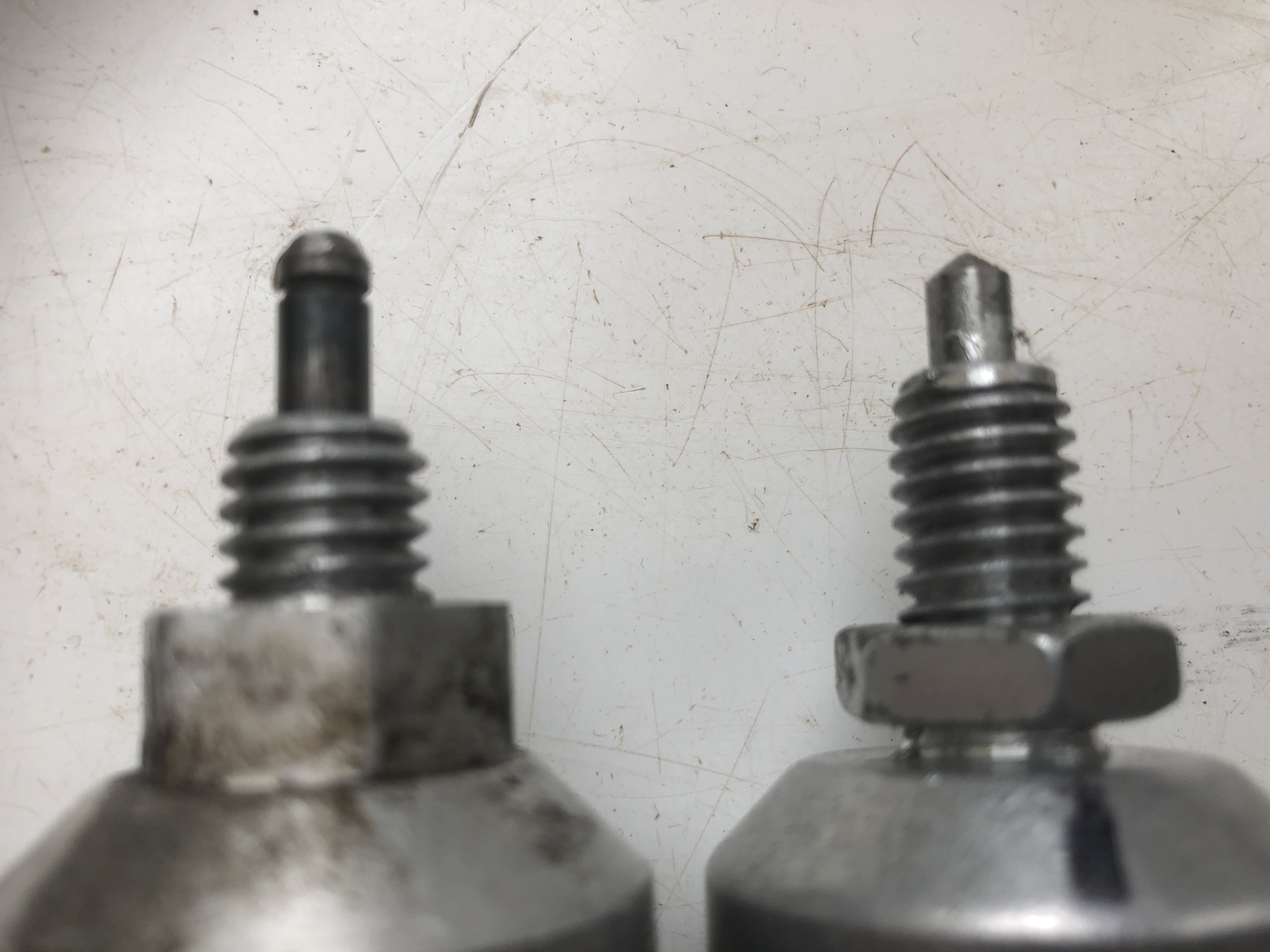

I had a new inhibitor switch ready to fit but when I compared the old and new they were different thread lengths and the new one had no markings to signify which terminals were for reverse or ignition button. As the old switch was broken I took it to pieces to see how it works internally. So basically there is a plunger and something inside the gear box pushes this plunger in to different depths depending on where the gear lever is. The plunger then makes an electrical connection across the terminals depending on the depth it is pushed.
The old switch is on top the new below. It is clear that they are different plunger lengths.
Problem is as there are no markings on the new switch to work out which terminals are 1 and 3 or 2 and 4. I can work out by putting a multi meter across the terminals and pushing the plunger which terminals work at different plunger depths but that does not help as I do not know the depth the plunger should sit at when screwed in the gearbox.
