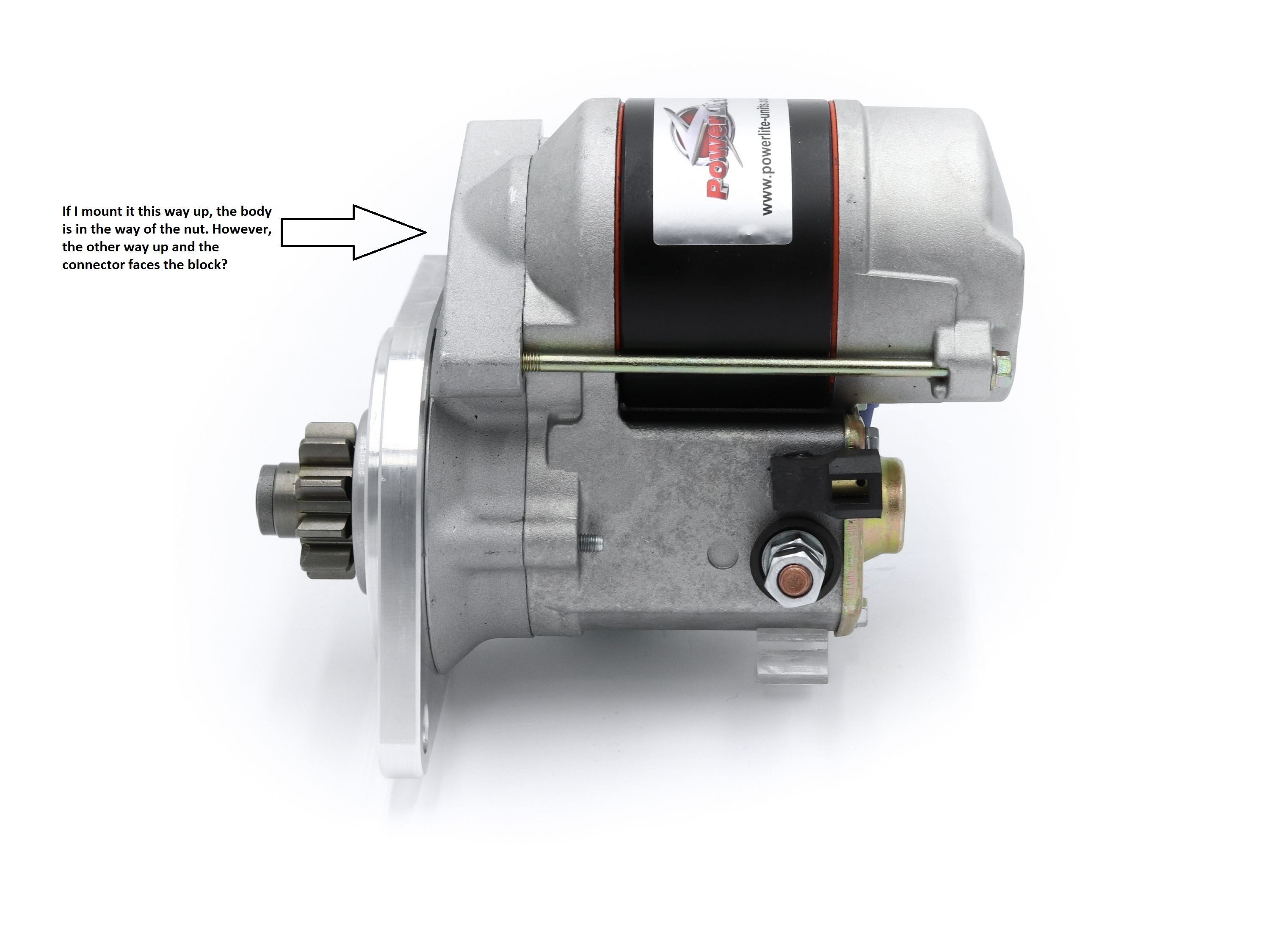

Help. This is really turning into a saga.
I have got the new hi-torque starter located (ish). I sourced a curved band with the bolts on it. Bottom nut on. Was about to try and push starter home and put on the top nut, but with the motor in place the bolt thread would be between the motor body and the block! I guess I could probably push the nut through 'blind' from the front of the car, held on to something with tape, but that looks mad.
So, it looks like turning the motor up the other way would work, with the solenoid/relay bit on top and motor below. However, that puts the power cable connection facing the block. Not a major problem, as I can connect it up first, but I am paranoid about getting the starter in the wrong way round because the cog on the end looks 'handed'. It might not be, of course, But I can't find any clues on the 'net.
Does anyone who has a high torque starter fitted have a pic or can tell me which way up it goes? Motor on top or relay on top?

Re: 3.4S (manual) Starter Motor
I can show a photo tomorrow but I found the "U" shaped bolt holder did not fit with the new starter motor so I discarded it and fitted nuts and bolts. I think from memory I had to use the Churchill tool "WIFE" to hold a spanner on one of the bolts whilst I used a very long extension with a ratchet to do up the nuts.
The solenoid goes at the top with the cables away from the block.
