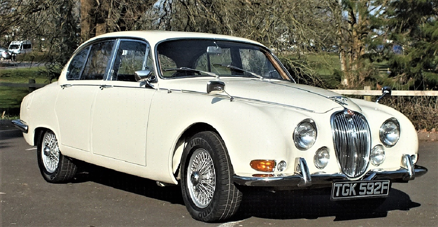

I have two wing mirrors half down each wing plus a drivers door mirror which they called an overtaking mirror.
The mirrors on the wings are useless. They are too far away to give you any decent view. Setting them up is a nightmare and then the visibility is appalling. Tiny mirrors that you can only just see the side of the car in.
The overtaking mirror is fine and gives you a good view down the side of the car but the chrome up right of the front quarter light window gets in the way and you have to lean backwards slightly to get a full view in the mirror of what's behind you.
The overtaking mirror on the door is a lot better than the wing mirrors and if I had not had holes in the wings for them when I bought the car I would not have fitted them.
I would go for two door mirrors. Closer to you and the visibility is better even though it can be restricted at times.
From what I read somewhere the S Type did not come from the factory with wing mirrors fitted and they were added as an aftermarket extra. None of the sales brochures I have for the S Type have wing mirrors in the photos.

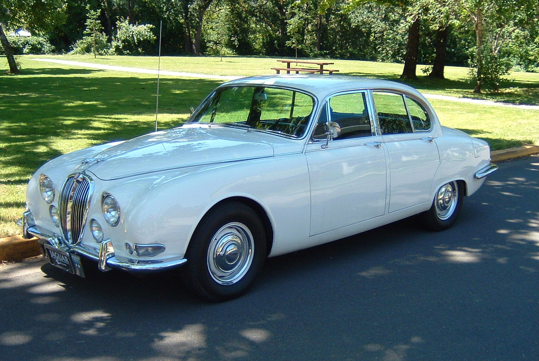

Re: Reversing MIrrors

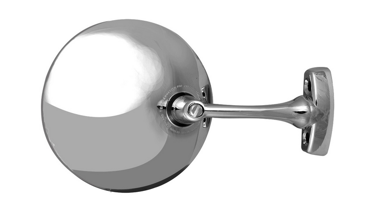

I would agree with Cass3958. In my opinion wing mirrors are useless, spoil the lines of the car and constantly get in the way when working in the engine bay. My car is fitted with two round Lucas repro mirrors on the doors. At least the driver's side can be adjusted from the driver's seat. These mirrors are reversible so can be fitted to either side. Some are available with a convex lens which is useful on the passenger side. There are two types of mountings for these mirrors, the type I use is attached by two chrome self tapping screws but there are also ones that are attached with one stud but that requires a nut on the inside. Mine came from Moss as they are used on many sport cars. Being a Lucas repro the look quite period. And FYI when my car was new, in 1965, there were no factory mirrors fitted to US delivered cars. It was up to the buyer to fit what they wanted and the dealer supplied them.

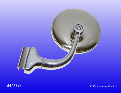

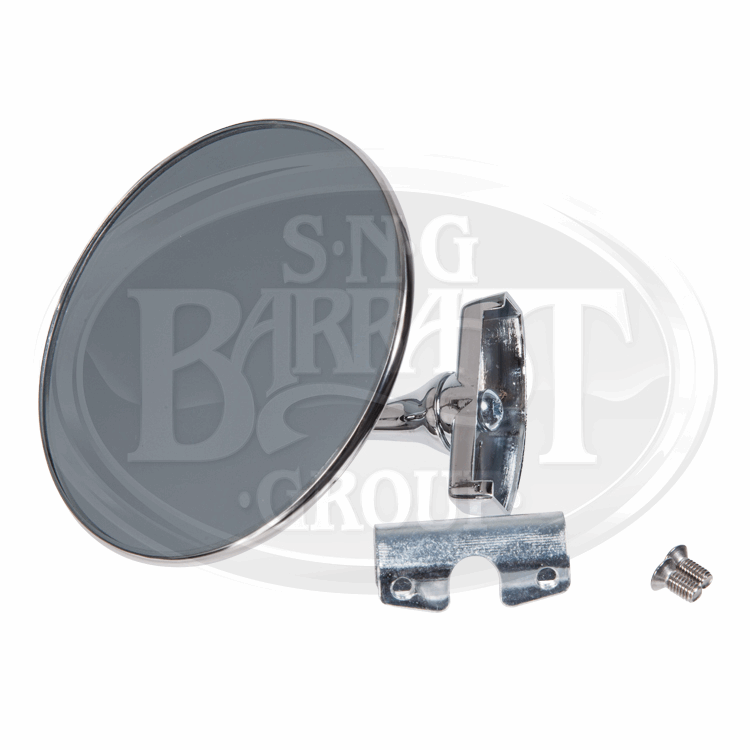

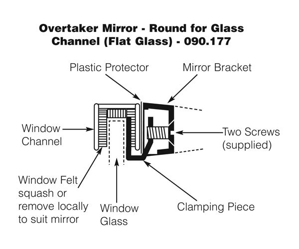

Another option if you don't like drilling is clamp on mirrors to the NDV frame. ~ no they don't damage or mark the chrome.
