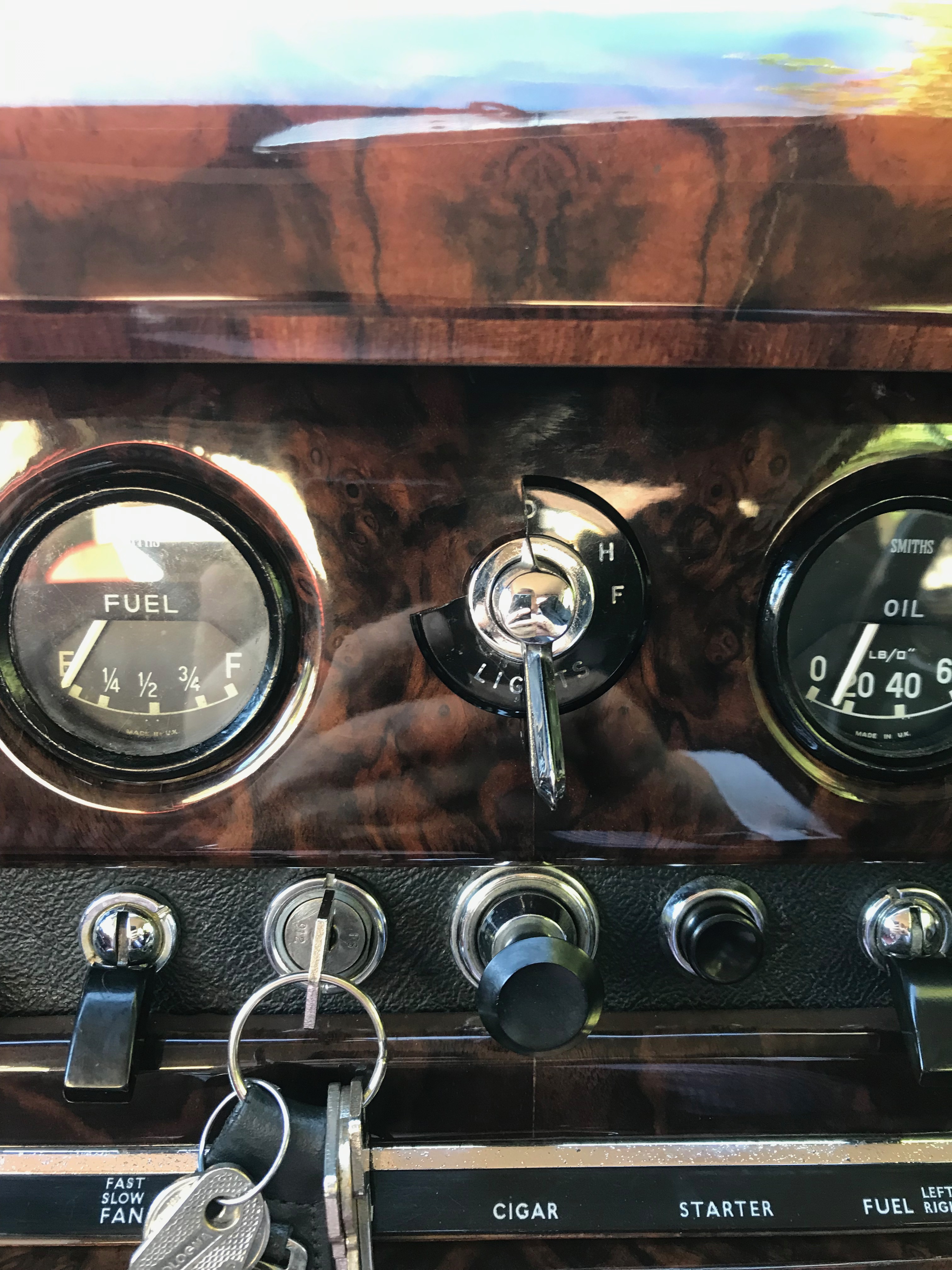

Assuming that I can source a new one, how easy is it to replace? Mine fell apart (and the missing 'quarter' is nowhere to be seen!) so I will have to start again. Is it as simple as pulling off the switch and then inserting a new label?
Given that it has left no mark on the wood veneer, might I assume that (unless it splits again) it is kept in place without glueing?

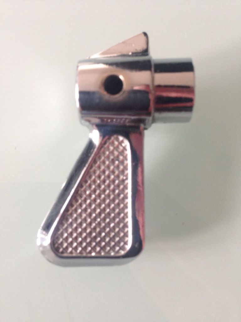

Re: Headlamp label
I think Jaguar is consistent. There is a little detent sprung ball on the lightswitch shaft. You just take an allen key or whatever & stick it through the hole in the lever ~ depress the ball & pull off the lever.

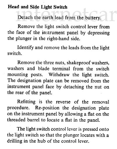

Re: Headlamp label
Here we go: You have to go in from behind to replace the round black escutcheon.(Designation Plate)
Light switch & escutcheon removal & repl..JPG (65.1 KiB) Viewed 3711 times
Light switch removal..JPG (24.74 KiB) Viewed 3711 times

Re: Headlamp label
Not so bad. Just mark where wires go with masking tape or similar.
