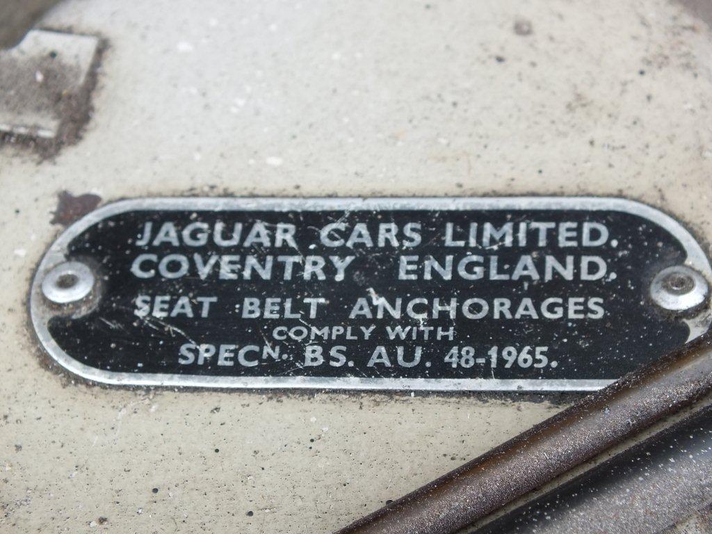

Re: Rear seat belt anchor eye bolts.
This should give you a better view. It is positioned on the inner wing in the engine bay on the left side between the PAS reservoir and the Electric box. The plate is mounted upside down so you can read it looking over the top of the left wing.
I did not use any washers or lock nuts on any of my eye bolts.
I have checked no B.S.plate fitted or holes on that part of the inner wing, although all the seat belt anchor holes are in place and threaded. The build date is August 1965 of my S Type, perhaps the B.S. plate was fitted by Jaguar after that date.
Thanks for the info regarding fitting though, just the bolts no washers or lock nuts.
As the BS date is 1965 one would assume that it was not put on to the S type until 1966 at the earliest as it would have had to have been added to the build sheet and that would not have been done over night.
FWIW, my November 1964 build 1965 3.8S has the anchor fittings but no underhood label. Label must have been a legislative requirement at some point.
The plaque might not have been added to export cars as BS stands for British Standard.
On the internet if you put BS. AU. 48 in it shows a lot of European cars had a similar plaque but only for cars that were being exported to the UK market and then British cars like Triumph had them again to comply with the British Standard on seat belt fittings. US cars might have had the seat belt fittings but no plaque as the USA would have its own seat belt fitting standard and UK cars would not have had it prior to 1966.
Well just for laughs I went out and checked my 1969 Austin and it has a label but it is part of the plate that also shows the VIN and is attached to the hood shut panel.
