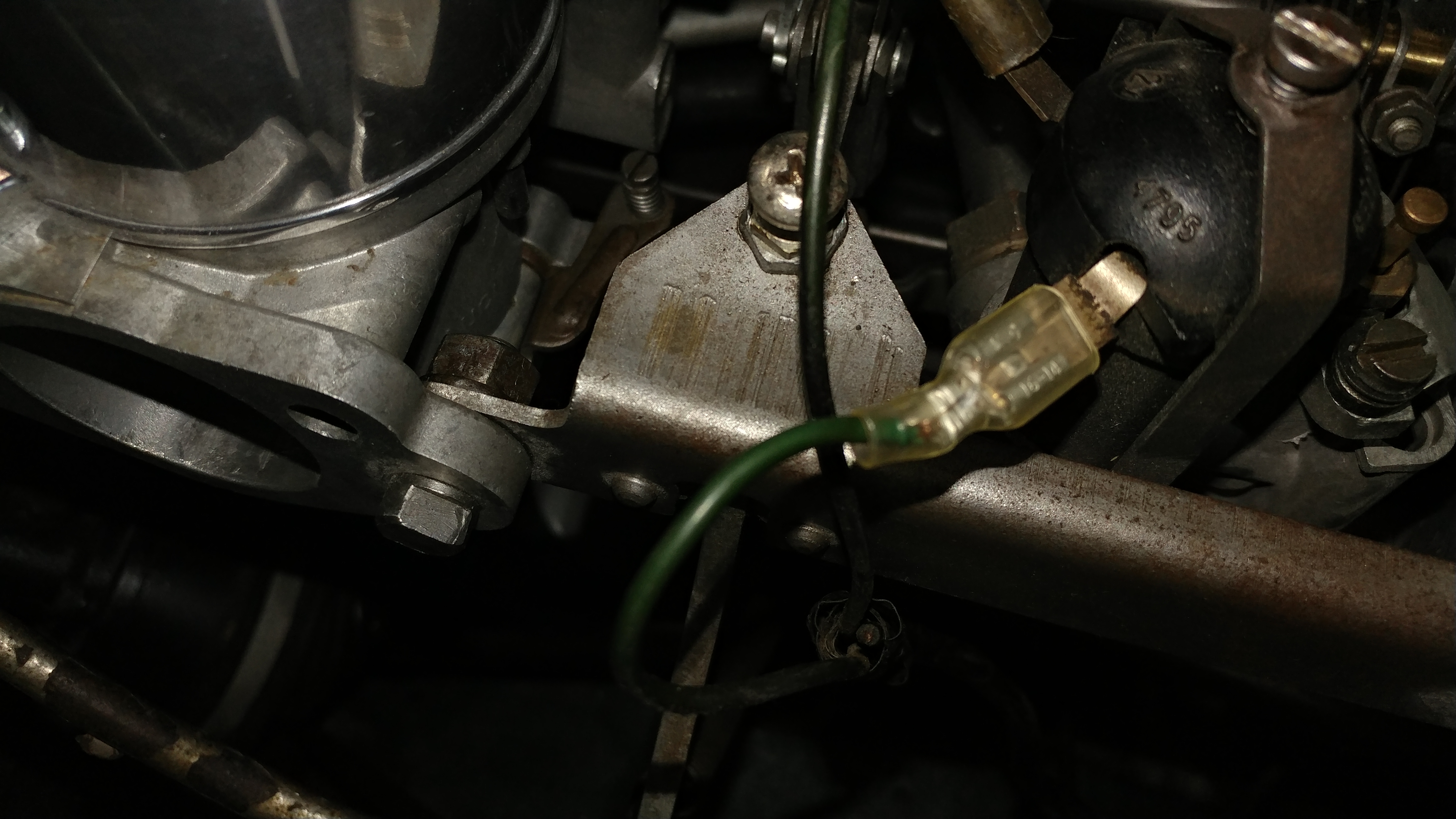

If you look really close, you can see a 3rd wire in the wiring harness. Where does this wire go????? The other two wires are connected to the carb.

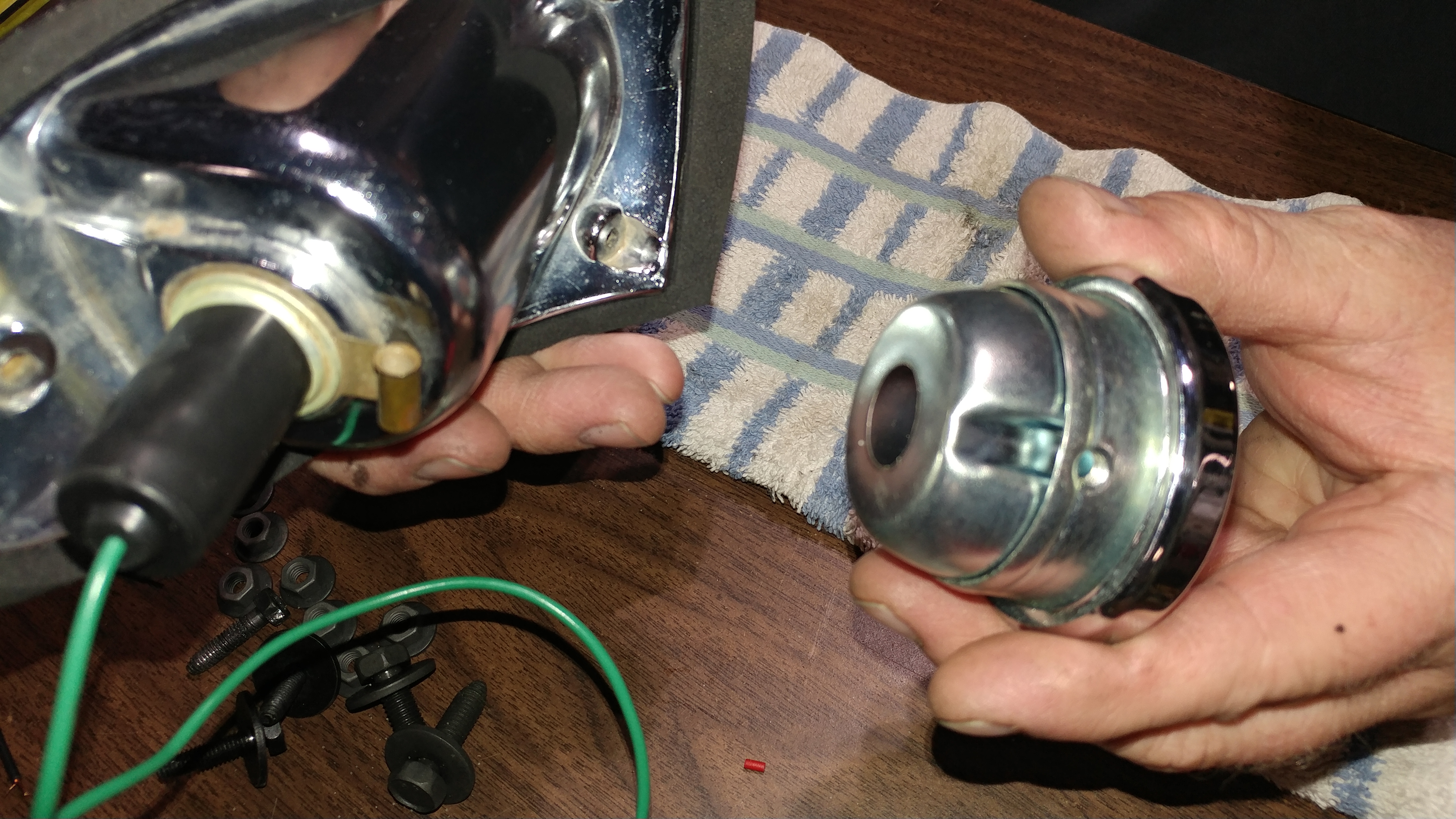

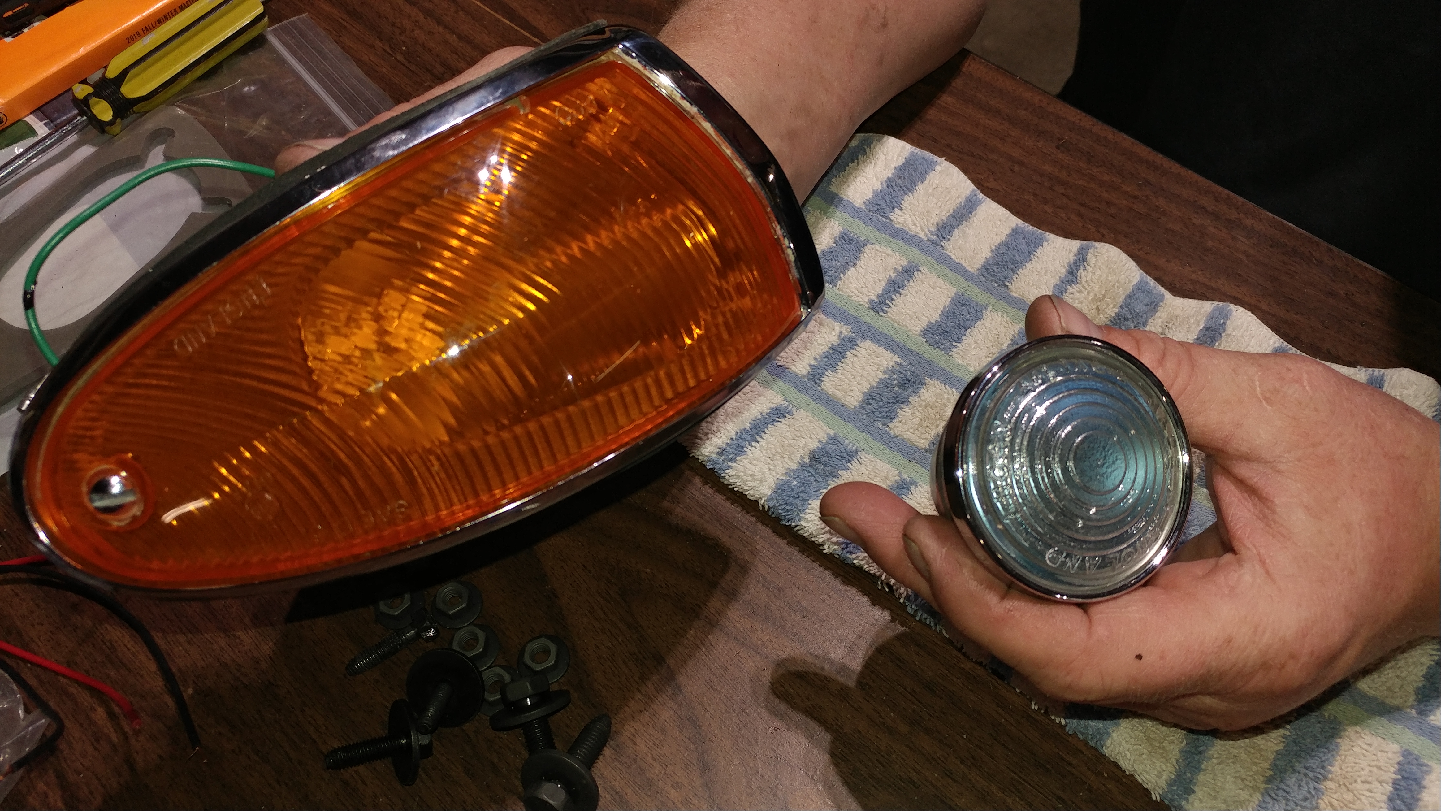

You can see on the little light there appears to be a wiring connection. The sidelight also has a similar connection. Are these grounds? Are they connected together since they are close to each other?

Joe I presume you have an auto car, if so the third wire that looks like it's been cut short should go to the anti-creep switch that is controlled by the throttle lever. I dont have any photos of it as I converted my car to manual. You should have a large solenoid inline with the brake pipe under the car running along the chassis rail unless a PO has removed it that is energised by the switch holding a line lock to the rear brakes when stationary.
You are right as far as the large indicator lamp with the brass connector being an earth. The small side light is earthed via the bulb holder and nothing is attached to the fitting itself.
Nigel is presuming the car is Auto but from your signature Miss Kitty is a Man/OD so I doubt the third wire is for the Anti Creep. It might be for the Otter switch which from memory is the only other wire attachment around that area although mine comes from the front of the loom and is seperate from the two wires that go to the choke. The otter switch is on top of the inlet manifold by the thermostat housing and has a cover with three bolts in a triangle and then the wiring plug sits on the top of it.
I go with Nigel on the light wiring being the earth.

Rob, doesn't the otter switch wire share the same loom outlet as the temperature sender wire?
