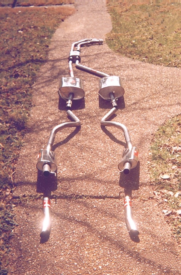

Ordered the Bell System today from SNG. They added the accessory kit for free, got the 10% Jag Forum discount, and free shipping. Not bad. Ordered the Permatex from Amazon. Thanks everyone.

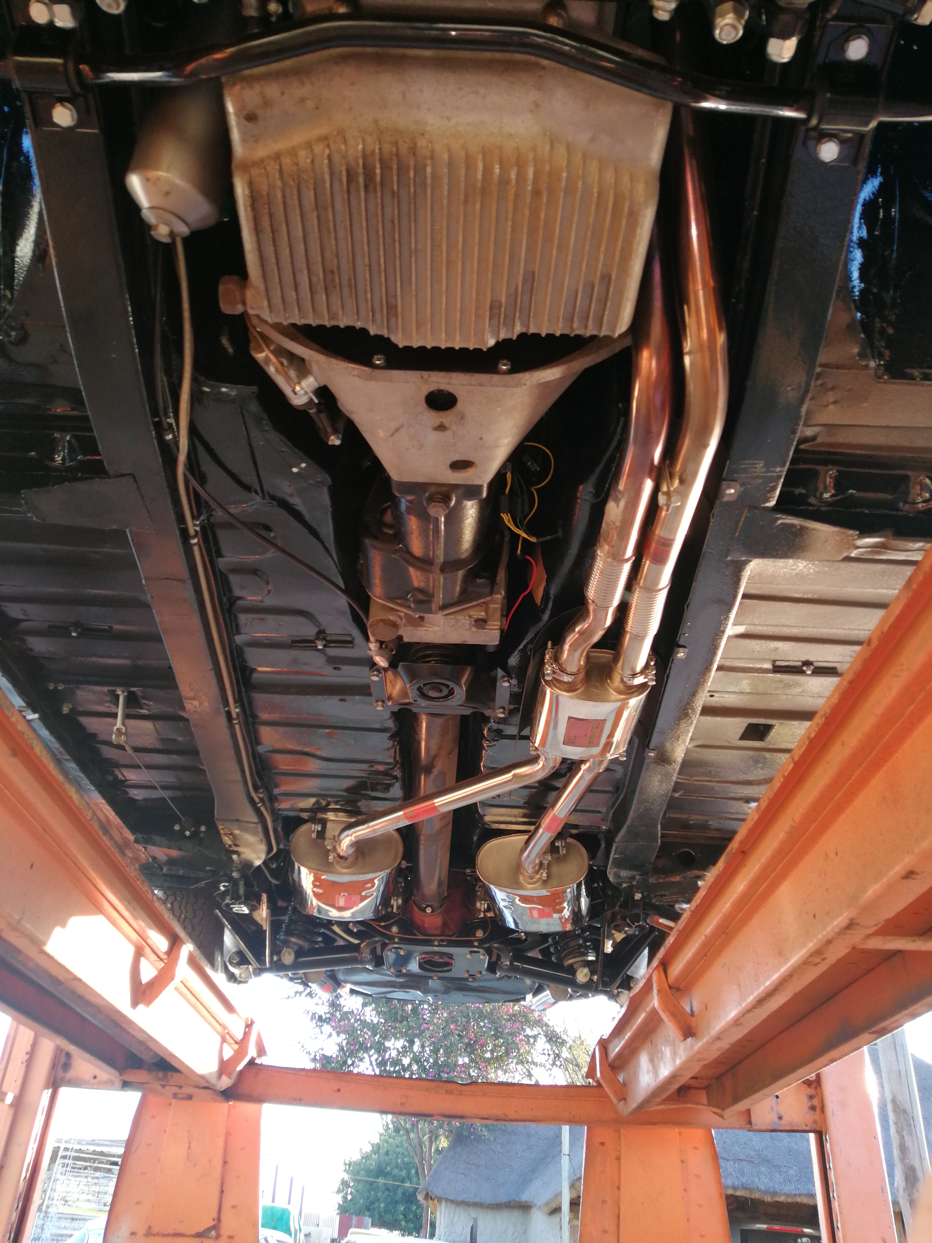

I have been very happy with the Bell system I fitted to my car. Fit & finish is good. They are not quite as solid as the old Langford SS exhausts but get the job done. I strongly recommend you fit the exhaust dry. You don't need any exhaust sealants on these if you use the proper stainless band clamps.

As you can see, the kit is $63.xx now. But, SNG included it in my sale. The biggest savings was in the free shipping. Just received the kit. As advertised. The Bell system was not received. Looks like Monday.
