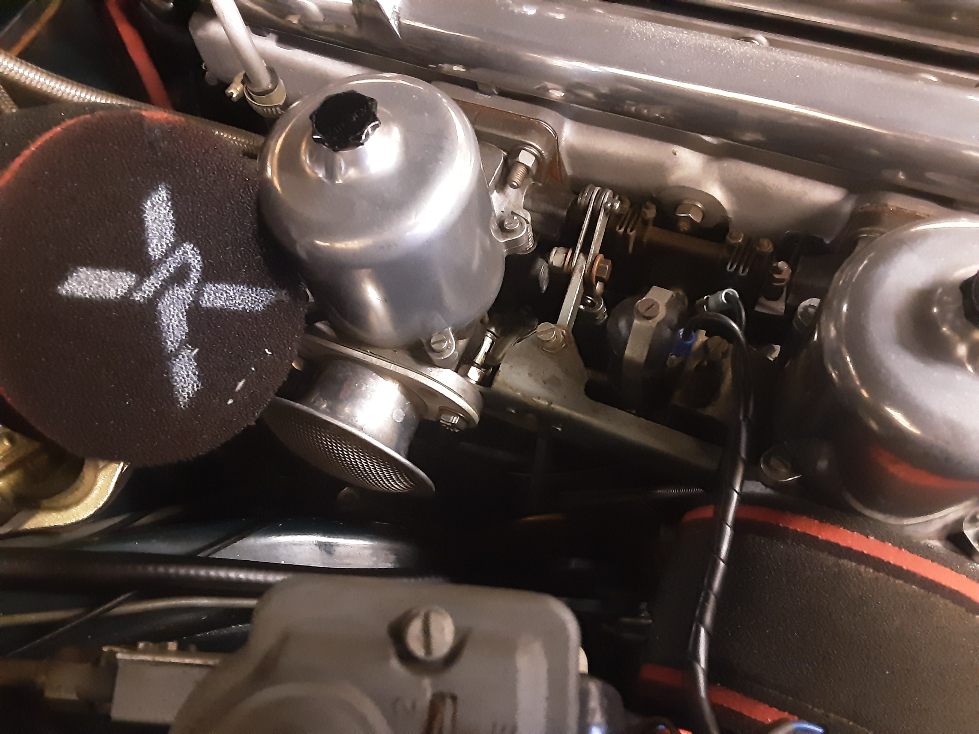

I'm not quite sure what the intended outcome of this mod is, if it's to get more power out of the engine a set of 2" SU's would be better. I have fitted them along with Guy Broad intakes including high density foam filters. They have been on for the last twenty years and haven't killed the engine yet.
- 20231025_161951.jpg (1.49 MiB) Viewed 5627 times
