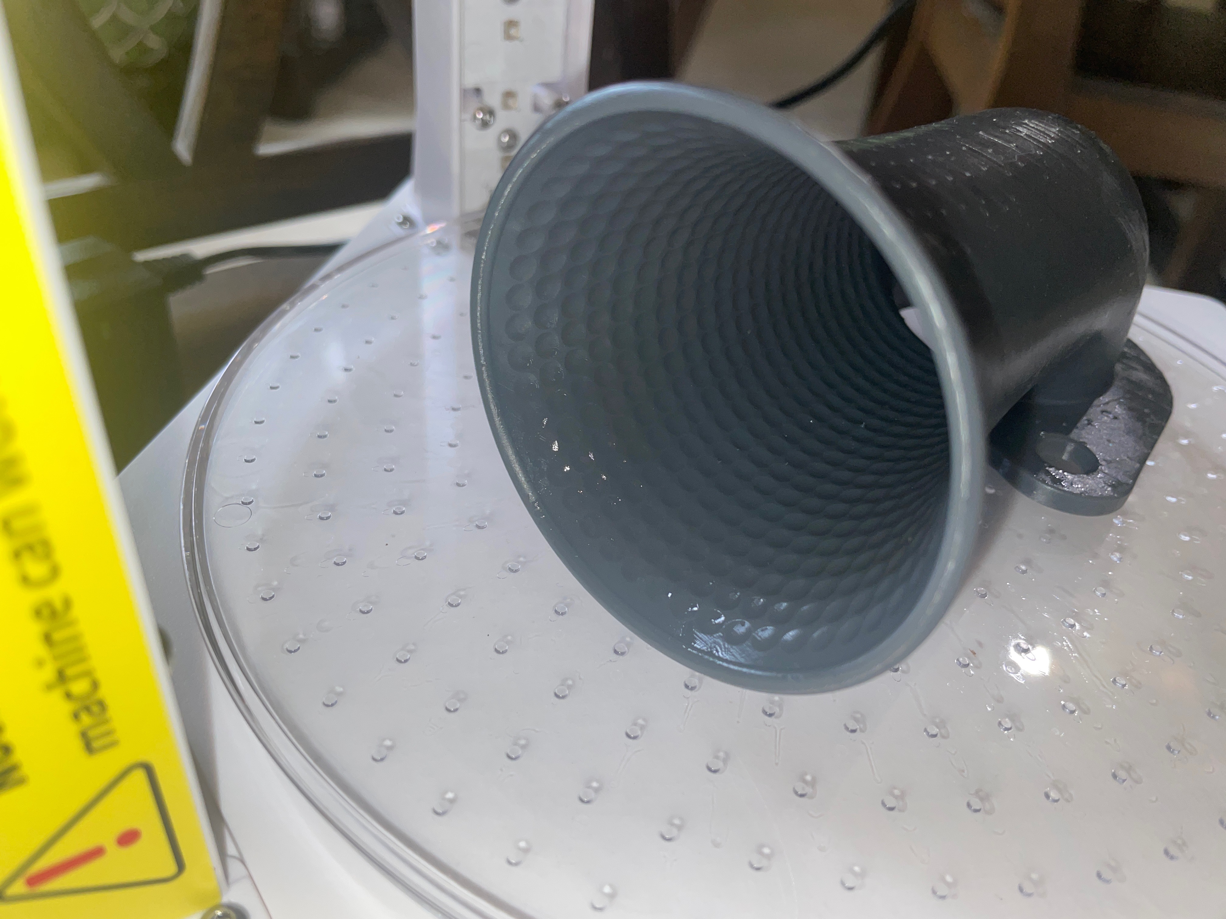

As an experiment I am printing velocity stacks for my HD6 SUs.
Experimenting with dimples to affect the flow..
Flange width : 2.75”
Carb side 1 1/2”
Horn length 5 1/4”
I have metal mesh filters.
No idea as to how to honestly measure the difference in the stock plum/cleaner setup.
Pictures are of an older version..flange upside down, and smooth horn.
Pictures of the correct flange and dimples on the inside of the horn coming.

Final prototype..
Correct flange
Dimples for flow.
Will paint outside surface gray aluminum
Metal mesh screens on order.
