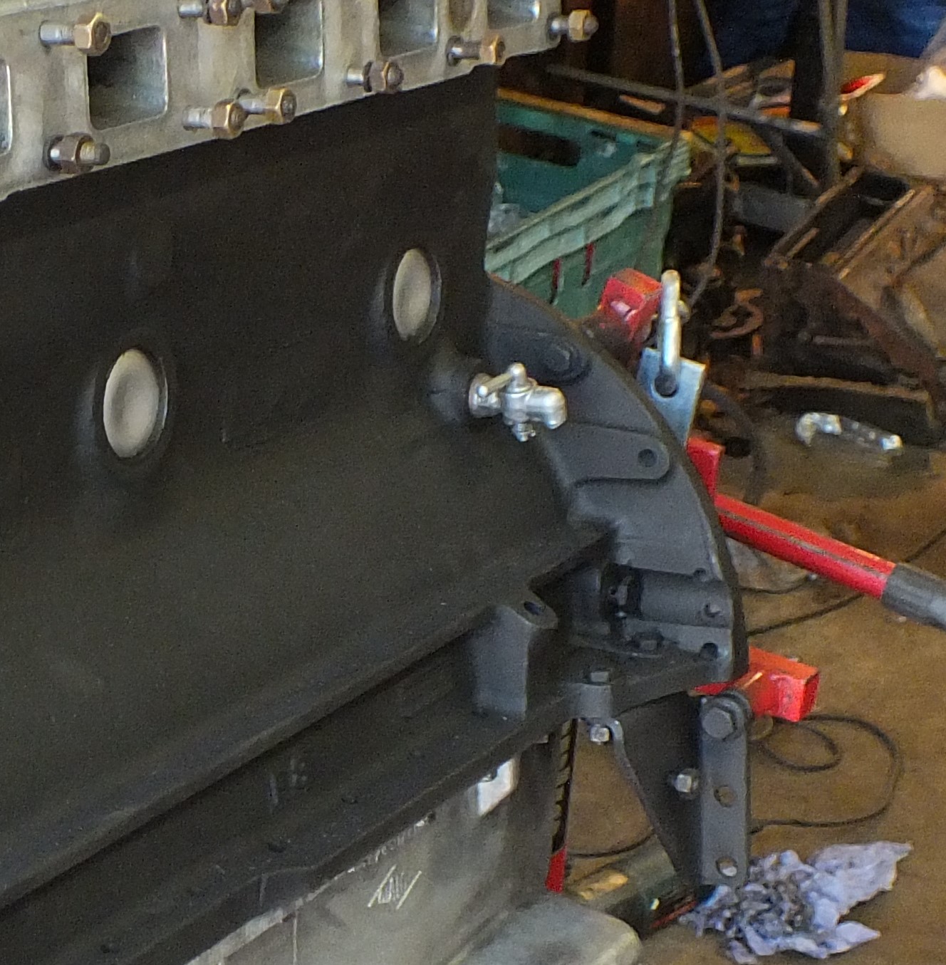

Two things. First the broken off part cannot fall into the sump as the end sits on the bottom of the sump almost and remains in the tube. It is also if I remember rightly to large a diameter to go through the hole in the block and fall out at least mine was and from your photo mine broke off in the same area. So removing the tube will sort your problem and although it sounds hard I found it surprisingly easy to remove and refit with the blow torch.Bingo wrote: ↑Sat Sep 16, 2023 10:33 pm Thank you, thank you.
Would dropping the oil pan and letting the remaining part fall out or pulled out ?
SNG Barratt has dip a stix for a E type 3.8 for $110.
Looks a lot like ours.
https://www.sngbarratt.com/English/#/US ... d9c7b406d3
Secondly you need to get the correct dip stick which fits the S Type engine. They are all different in length and shape which depends on the length of the dipstick tube, depth of the sump and in the case of the 2.4 engine the depth of the block. All the dip sticks might fit but they are not going to give you an accurate reading of oil depth and that could be catastrophic for your engine.
I removed my dip stick tube during my engine rebuild so here are some photos showing the block with and without the tube fitted.
