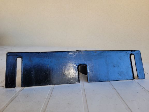

I believe we may be talking of different parts. The part that sits over the hinges is this one Opposite to it is the heater fan inlet. I would expect some conical or cylindrical piece of metal sheet to come against the fan inlet, preventing entry of rain water from above and funneling air into the fan. My car does not have such a part, and I expect rain water will easily get into the fan and the heater.

No there is nothing else only the part you have shown. The heater box has its own flap which is operated by the Hot/Cold lever in the car through the metal cable that attaches to the side of the heater box. You do find that the foam seals on this heater flap deteriorate to nothing so when I refurbished my heater box I replaced them with closed cell sticky back foam.

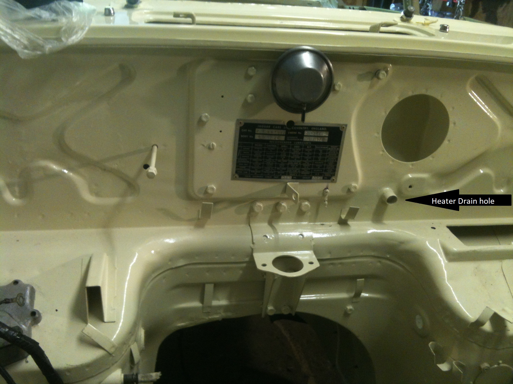

Any water that goes into the scuttle should drain away via the drain hole which we have talked about several times on the forum. It sticks out the face of the bulkhead and then there should be a rubber hose that allows the rain water to go down to ground at the side of the gearbox bellhousing.
Attached is a photo showing the drain hole. You will see that the area behind the heater where this drain hole is, is a lot lower than the hole that goes to the heater fan so unless the drain hole is blocked you should never get enough water in there to affect the heater.
