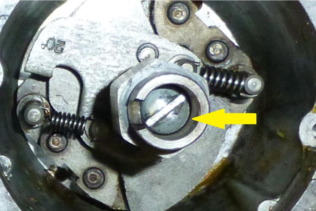

Please note that I'm not talking about the drive dog being 180 degrees out.
On a Lucas 22D6, by removal of the central screw you can take the main cam lobe shaft piece out of the distributor with the weight plate and re-install it 180 degrees out. An easy mistake to make. This places the Rotor 180 deg out.

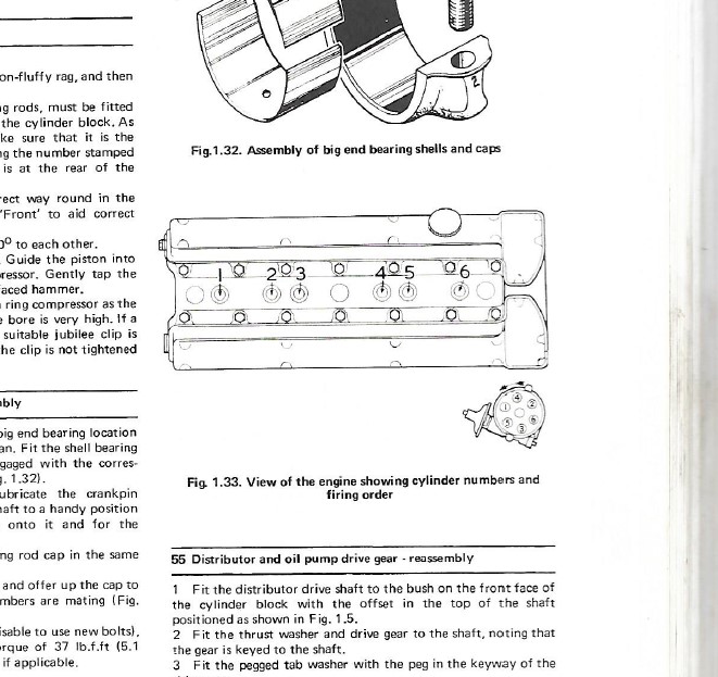

The reason why I'm confused about it is that the Haynes workshop manual of my E-type discribed the opposite.
I attached the Cylinder_numbers, firing order and Valve_timing part in that manual. There you can read that the No. 6 should in TDC.
It is confusing isn't it?

They are correct in that they have numbered the cylinders correctly. They are also correct that if a cylinder is at TDC then the distributor arm should be pointing at the corresponding HT lead for that cylinder. I think the confusion here is that what they are describing is VALVE timing not ignition timing. The blue service manual for the S Type is exactly the same but if you go to page B48 there is a section on Ignition timing.
Now I am confused because I have just looked at this section B48 and you are correct that even the ignition timing is set off cylinder number 6 according to the book. As I said it was eight plus years ago that I set my engine timing and I am sure I did it off cylinder number one but I might be totally wrong and I apologies if I have miss lead you.

B.T.W. I found the root cause of the confusion.
The distributor itself is ok. But when I took that out of the block I saw that the drive shaft position is opposite compared with the manual.
See attached pictures.
That's why it seems that the rotor is pointing to the wrong cilinder when 6 is in TDC.
I can turn the engine 1 cycle and remove the camshafts and place them back in cilinder 6 TDC position.
But for the moment T choose the exchange the numbers of the spark plug wires. So 1<->6, 2<->5, 3<->4.
