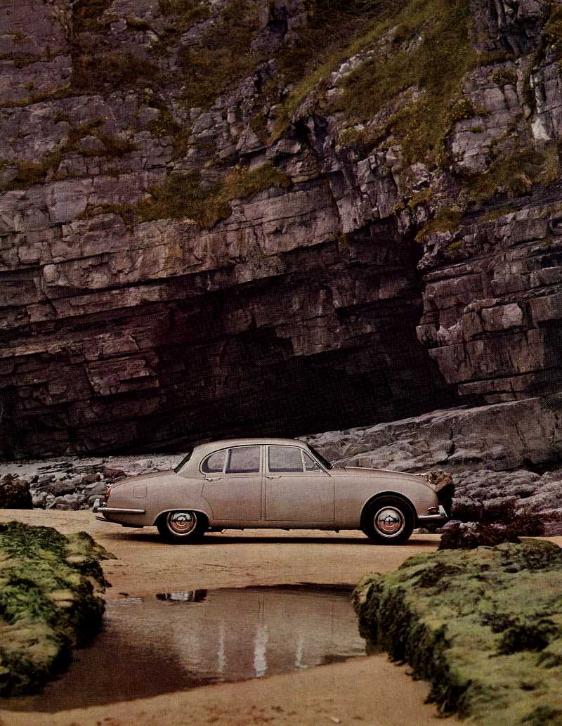

Rob. I think your car is as close to perfect as anyone is likely to get. These cars tend to sag in the nose as the miles go on.
New cars from original brochures.

Strange as well Glyn that all those brochure photos are of steel wheeled cars!
