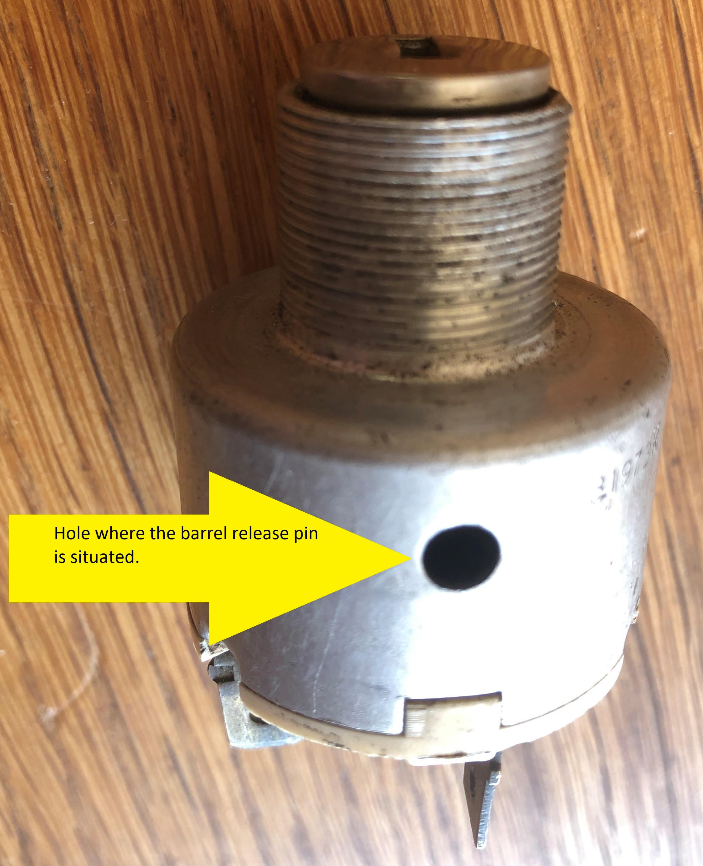

The ignition barrel key as stated should be the same as the door key but over the years these could have been changed for a number of reasons. To remove the barrel from the ignition switch it is easier to remove the whole switch from the dash. Unscrew the chrome retaining collar on the front. Disconnect the wiring on the back and the ignition switch comes out of the hole. One the side of the ignition switch there is a small hole and by putting a small screwdriver or punch into the hole and pushing down on a sprung loaded clip the barrel will pop out of the front of the switch. Again the FS number is stamped on the side of the barrel. Should you ever need to change the ignition switch you can always use this method to change the barrels over retaining the original ignition key which matches your door lock.

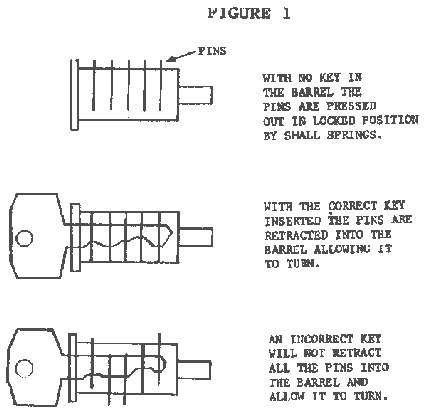

As Glyn said the locks are easily altered to fit any key but the way the locksmith achieves this is not pretty.
The way the lock works is there are five brass plates or wafers in the barrel which are sprung loaded. When the teeth of the key enters the barrel the brass plates are pushed up or down so they all line up flush to the barrel allowing the barrel to rotate. You can see this in the photos of the barrels already on this post. If the wrong key is inserted the brass plates are not flush and stop the barrel from rotating.
There are two methods used by the locksmith to fit the key to the lock.
First all the locksmith does to match the wrong key to the barrel is to put the key in the barrel so the brass plates are sticking up and then they file them flat. Not rocket science. The original key will still work along with the new key.
The second method was to use crushable wafers. The barrel is fitted with new wafers and then a tool is used to crush the wafers to the right sizes to fit the key.
Both these methods reduce your security as the brass plates will have been damaged and possibly weakened. Not that the locks were very secure in the first place as brass is a very soft material.
The act of sticking a screwdriver in to these barrels and turning it so the lock opens is down to bending or shearing off the brass plates when you turn the screwdriver with force in the lock. This is similar to the crushed wafer method but making the barrel fit a screwdriver shape rather than a key shape.
The original FS numbers were actually quite small. they range from FS01-FS99 and FS876-FS955 meaning there are only 177 different FS Key numbers used on Jaguar cars. As there were two different FS keys supplied to each car that means that every 89th car made had the same FS keys as the 1st car made.
Of the 24993 S Type Jaguars made, 284 of them would have had the same set of keys and you wonder why so many cars were stolen in the 1960s and 70s. As a young Bobby we were always looking for car thieves with large bunches of keys on them so we could arrest them for going equipped.
