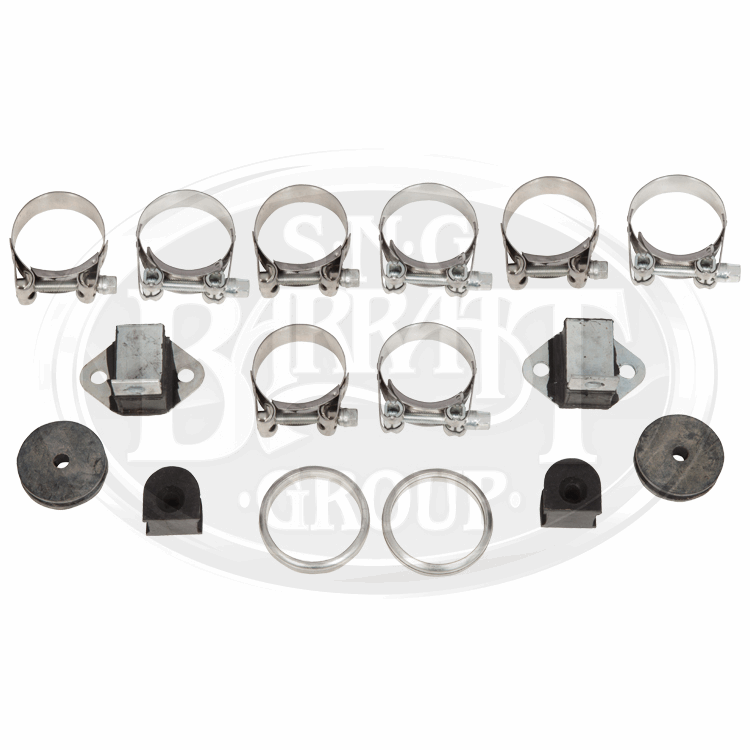

I have a Bell stainless system on mine & it is quiet & sounds civilised. None of that odd tinny sound some SS systems make.
I'm also of the opinion that a decent mounting kit changes sound somewhat. Use band clamps. Stay away from U clamps & use proper mounts.

I have a SS system from Double S Exhausts https://stainlesssteelexhausts.co.uk/ja ... st-system/ They are based only 30 miles from me in Devon UK. The previous owner had already fitted two rear sections from Double S so it seemed stupid not to buy the front sections from the same company and fit them. I have not had a problem with my system other than removing the U clamps and fitting Band clamps as Glyn has mentioned. U Clamps do not allow adjustment very well and allow the exhaust to leak at the joints due to the way they crimp the exhaust. Glyn has the narrow 1 inch bands in his picture where as I fitted the longer 3 inch band clamps to mine which really seals the joints well. The system fits the car well and it sounds good now I have sorted that annoying ticking noise from the Cams.

Yes ~ you have some choice with band clamps. They are a lot more expensive in SS than zinc plated U clamps but well worth it. Length of band clamp used is your choice. I have had zero leaks using the mounting kit shown above.

As Glyn has already said stainless band clamps and new mounts are mandatory.
