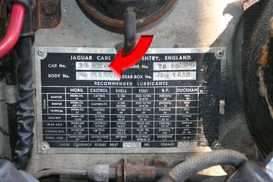

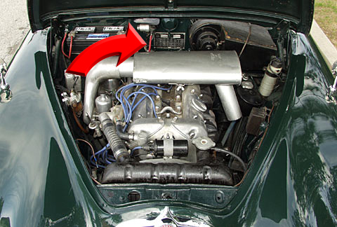

Several inquiries to the Register have asked where to find the ‘S’-type’s identification numbers. All of the original identification numbers are stamped on a plate in the engine compartment. Most plates are on the firewall but a few are on the left-hand inner wing. Numbers are repeated on the item itself (as described below) and if they do not match those on the plate, that component has been replaced and is not original. All original numbers of your ‘S’-type are also available from the Jaguar Daimler Heritage Trust (JDHT).
Chassis or car (VIN) number
The chassis number will also be etched or stamped in the bonnet catch channel forward of the radiator header tank. It breaks down into four components: a ‘P’ prefix indicates that the car has power steering; ‘1B’ is the ‘S’-type designator; the next four or five digits are the cars serial number; finally there are two possible suffixes, ‘BW’ indicting a Borg Warner automatic transmission and ‘DN’ indicating that the car has Laycock d’Normanville overdrive with its four speed manual gearbox. If there are no suffixes, the car has manual transmission without overdrive.
rhd (right hand drive) 3.4’s chassis numbers began with 1B1001, lhd (left hand drive) 3.4’s began with 1B25001, rhd 3.8’s began with 1B50001, and lhd 3.8’s began at 1B75001
