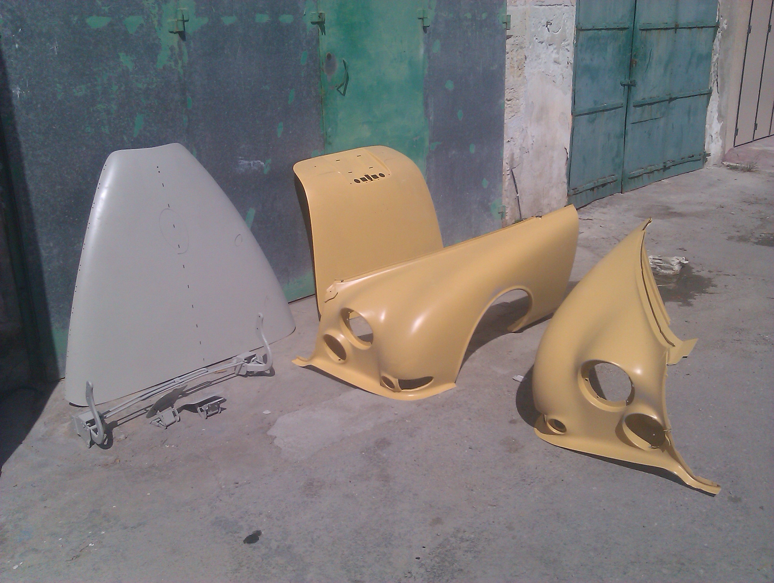

Thanks for the info. This confirms that Jaguar did not give much importance to that. Most probably their suppliers did not bother much with producing left and right side quarter window glass since it is the smallest piece maybe. If anyone has got it differently it would be interesting to know though. I am hereby attaching a picture of some body parts ready to be mounted.
- Picture 009.jpg (848.26 KiB) Viewed 2850 times
Re: Albions car on FaceBook
Make sure when you mount the front wings that you also mount the bonnet and get everything lined up and the gaps correct before welding the wings in place. Sadly this was not not done by the professional monkeys that did mine prior to me buying the car and the gaps between the tops of the wings and underside of the bonnet are different on both sides. Only I notice but it bugs me everytime I think about it and without cutting the wings off and starting again there is nothing I can do about it.
