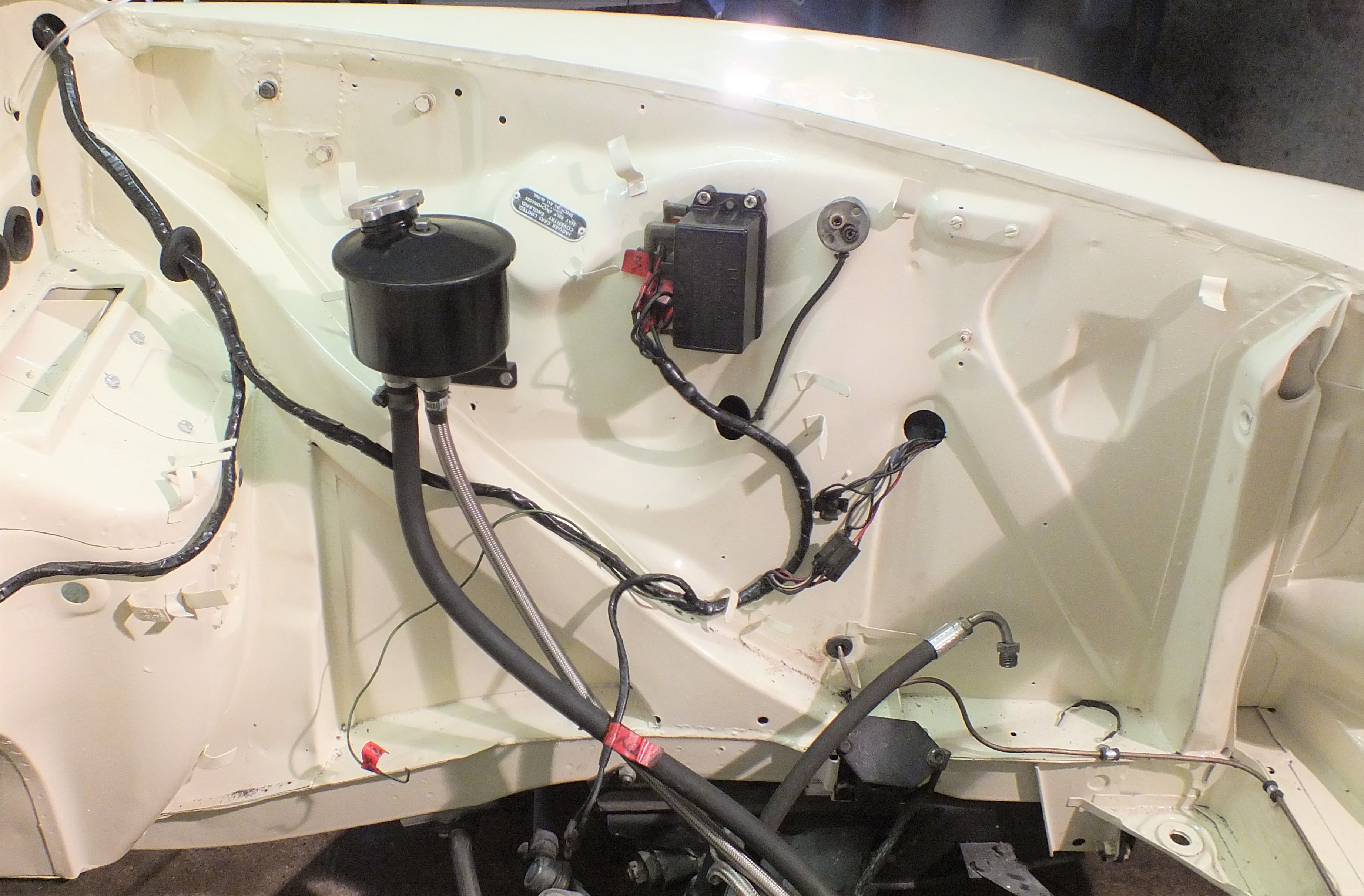

This is the left side inner wing with the three items that sit on the wing. Left to right they are the power steering reservoir, the Voltage regulator and then the auxiliary powerpoint.
There is one more item to the right of the powerpoint which is the water Bottle which is not shown in the first photo but sits on the three screws you can see just to its right. The water bottle can bee seen in this second photo.

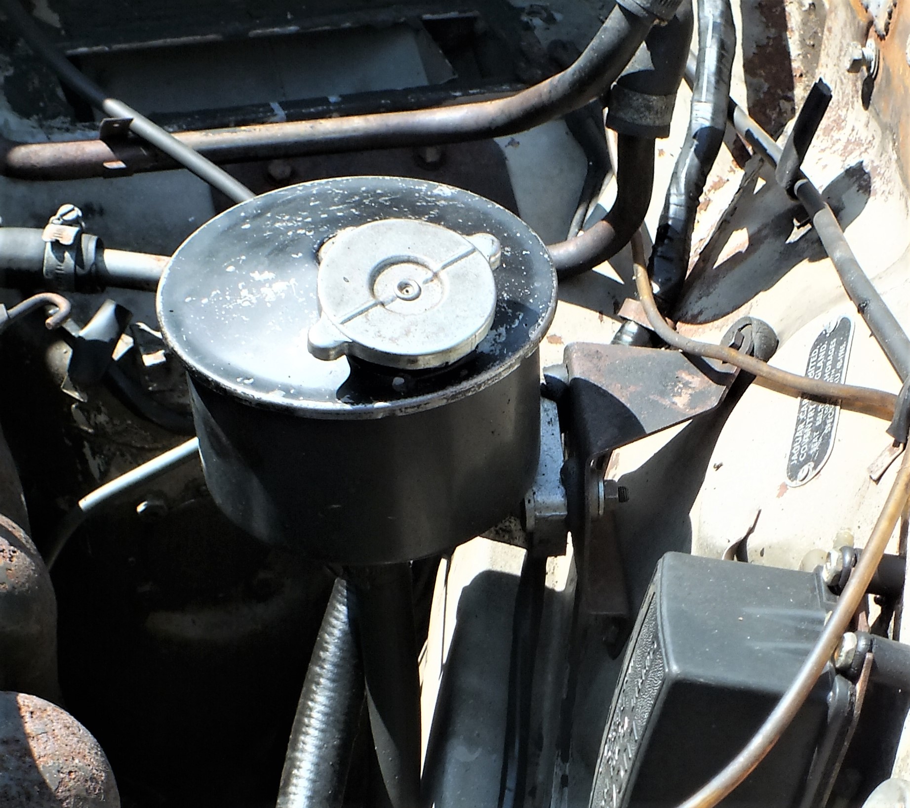

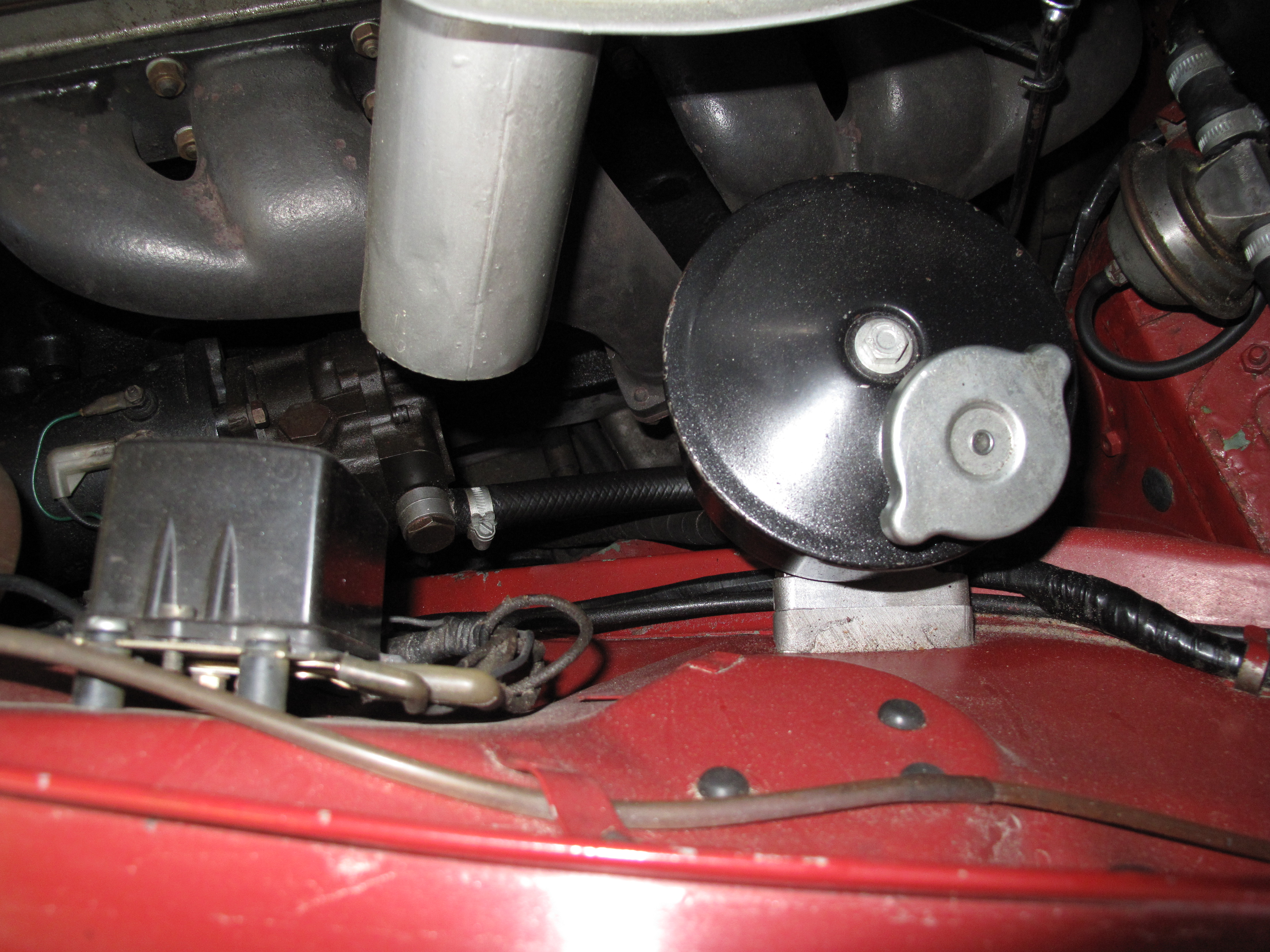

Re: Help An Old Man Out
Interesting Rob,
If I'm seeing correctly your late car seems to use a pressed steel reservoir mounting bracket. On early cars it was part of the alloy casting with an alloy shim piece to suit the wheelarch of the respective car.
Yes Glyn it is a pressed folded steel bracket not the Alloy one you have shown. The base is still Alloy but it bolts to the steel bracket which is then bolted to the inner wing. It seems to stick out further in to the engine bay then the alloy bracket version. Now come to think about it I have a couple of those Alloy brackets lying around in boxes that I could not place on the car. Not from my car but from job lot S Type spares I had bought. I did not think they came from the S Type but now I see where they go.
