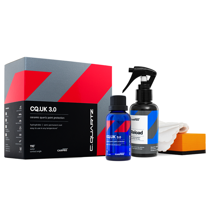

My first restorer used to do all polishing of cam covers, carb parts etc with newspaper, Autosol & elbow grease & advise all his customers to continue doing that. Now me! I'm always looking for a short cut that reduces effort.
I have wondered how these new ceramic products would work to protect aluminium? They claim to do a good job.
https://carpro.uk.com/products/cquartzu ... 6722425031

Both products are interesting and a lot cheaper on Ebay.
I have ordered some Diamond white to see how that fairs and because it is Vanilla scented. Mmmm!
I might also order some of the CQuarts for the paint work.
