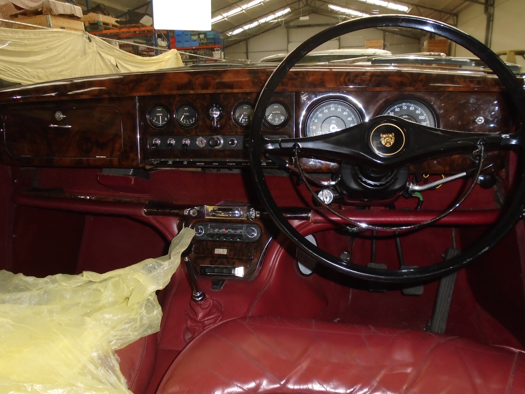

Thank you everybody – it sounds as if I am barking up the wrong tree! If the attachment works, here’s a picture of it.

All looks fine to me ~ pretty ~ good luck!

I think that's just the effect of the wide-angle lens on the camera/phone. Looks fine to me.
Lovely interior, btw.

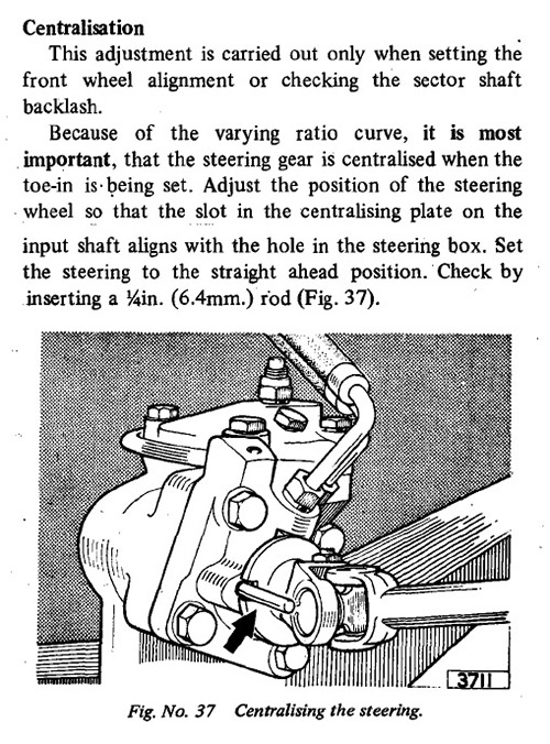

Wandering briefly off topic, as we so often do, the Varamatic steering box has two marks to line up to centre the steering box when you are aligning the front wheels. This is important because of the variable ratio of the rack, so away from dead ahead, the ratio increases and you don't want your dead ahead position at the wheels to be where the ratio increases. You then level the steering wheel afterwards using the same marks.
