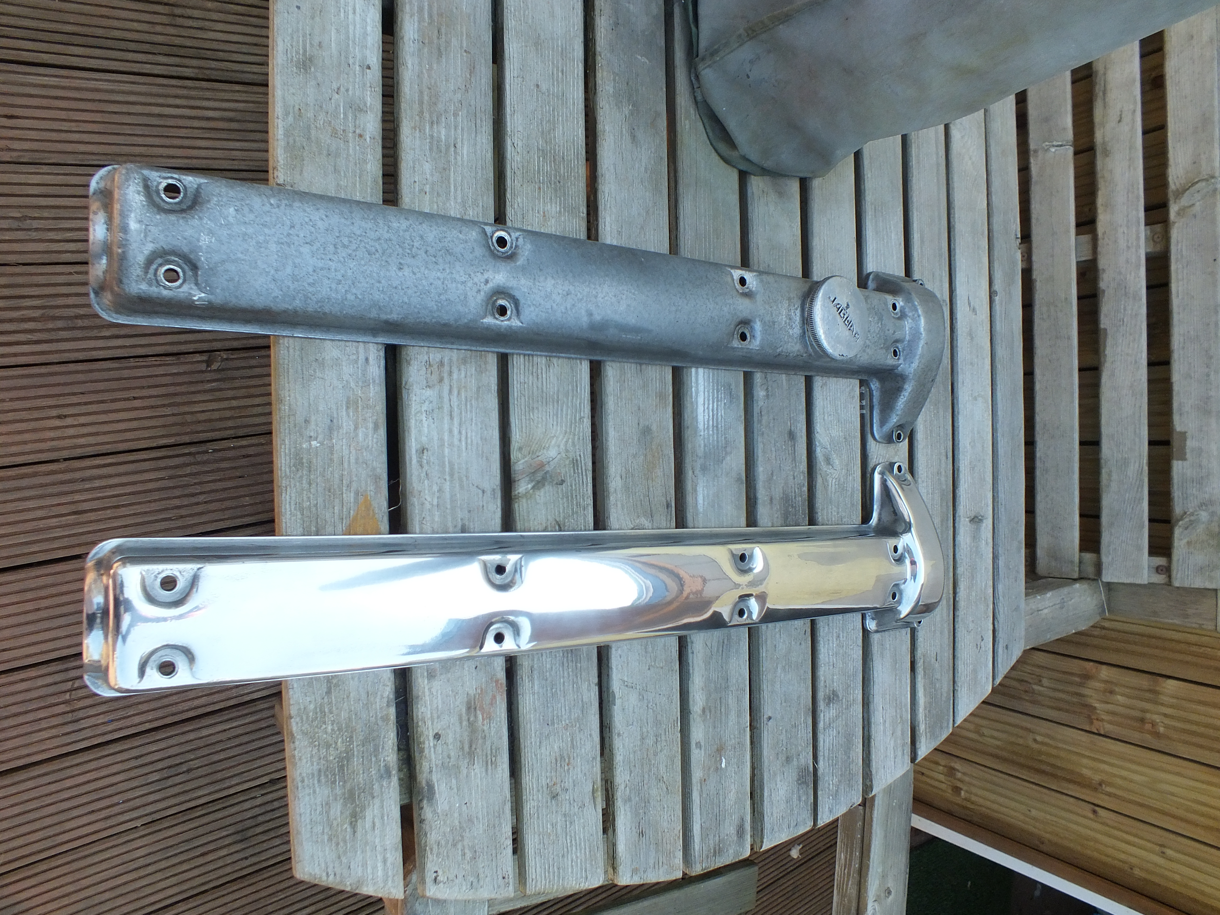

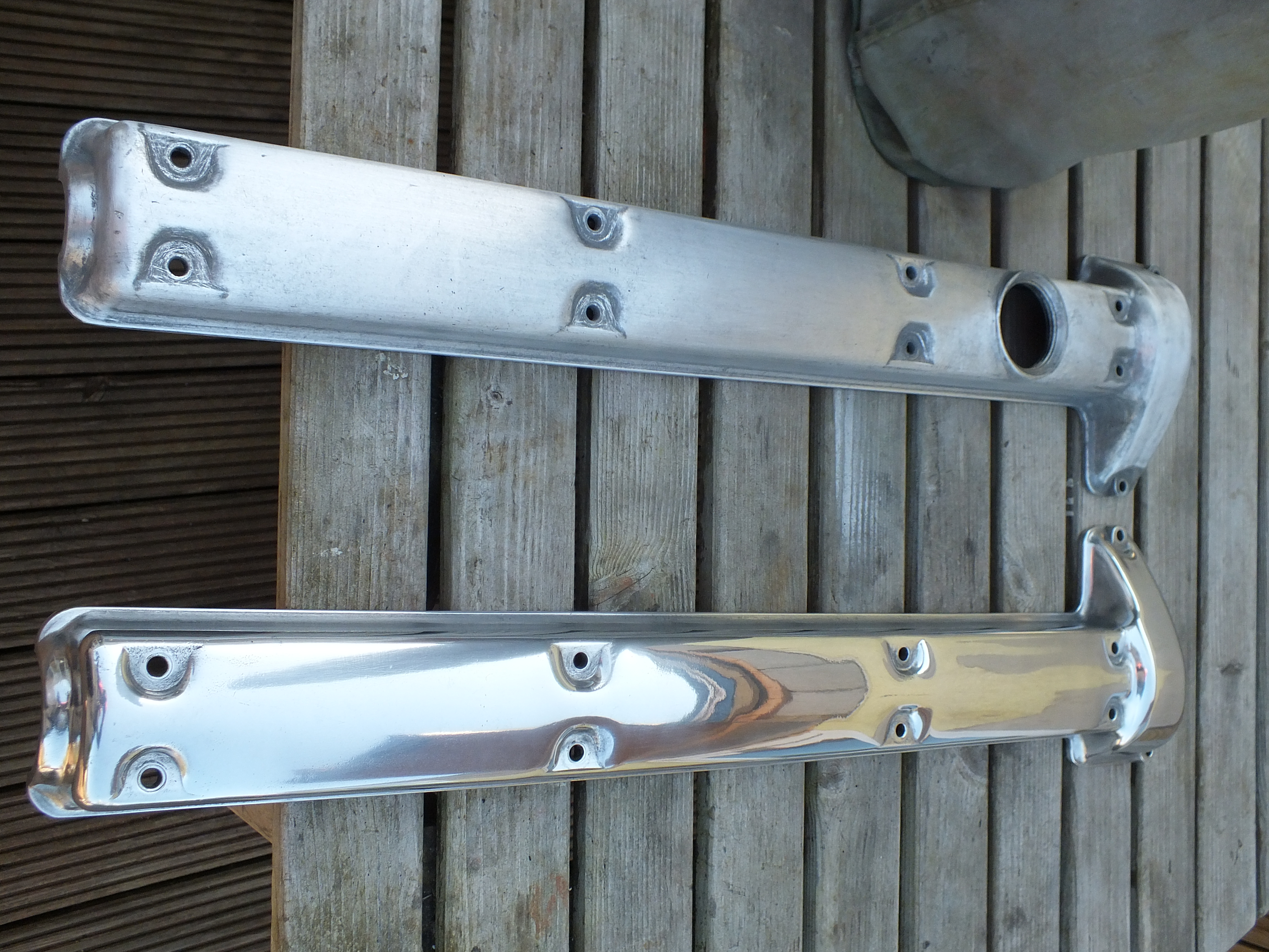

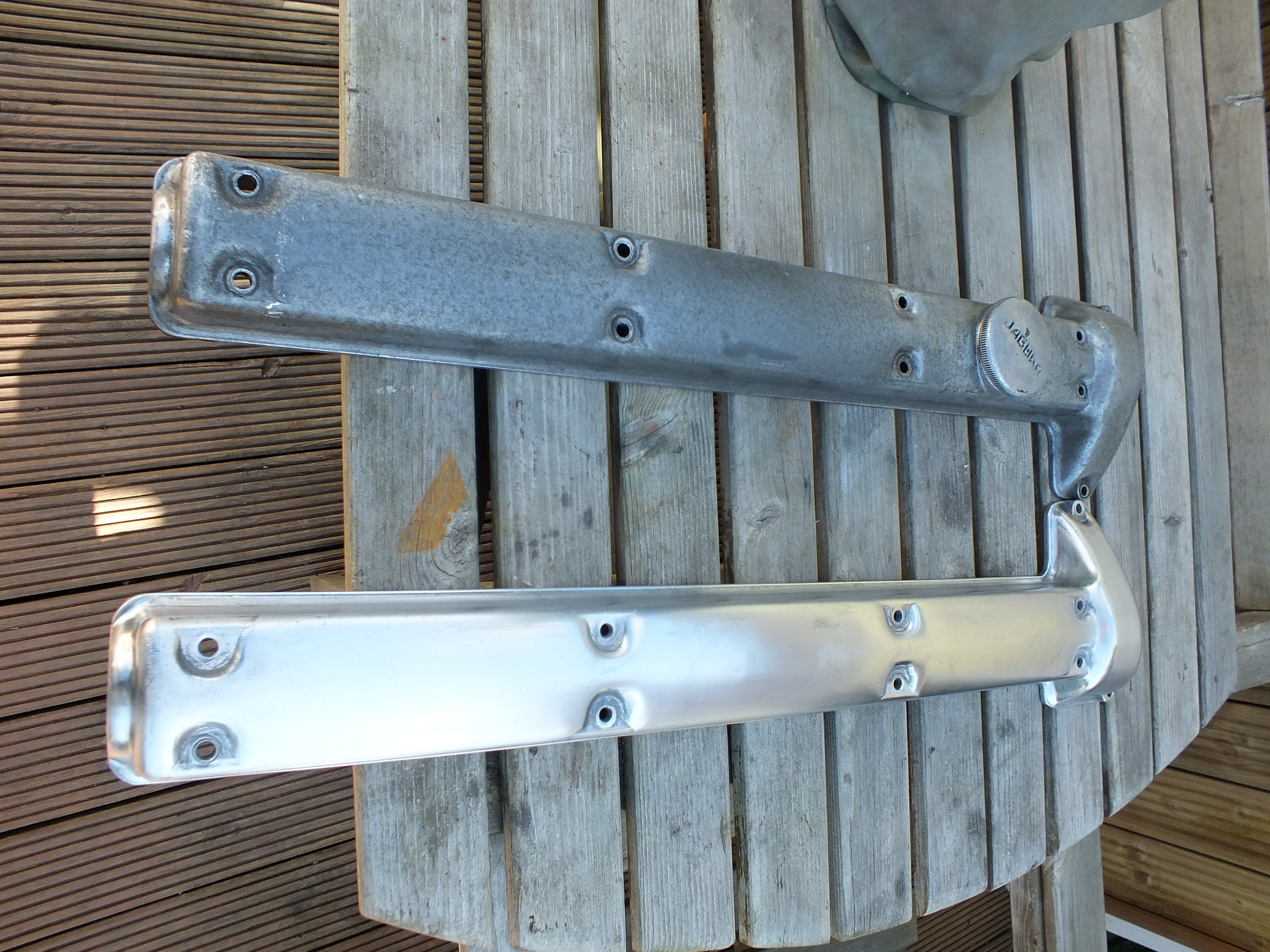

These are the stages I went through to get them shiny but they are now looking more like the part polished cam cover in photo one.
The stages involved cleaning then with a degreaser then starting with a rough grade emery paper to get all the blemishes out they were rubbed down. The emery paper was exchanged for wet and dry and the grade went from 120 down to about 2000 grit before I used the polishing mop wheel on my bench grinder to get the final shine. Autosol was then liberally applied to get the deep shine which as I said I sprayed with a high temperature lacquer to seal the surface but this turned yellow and had to be removed.

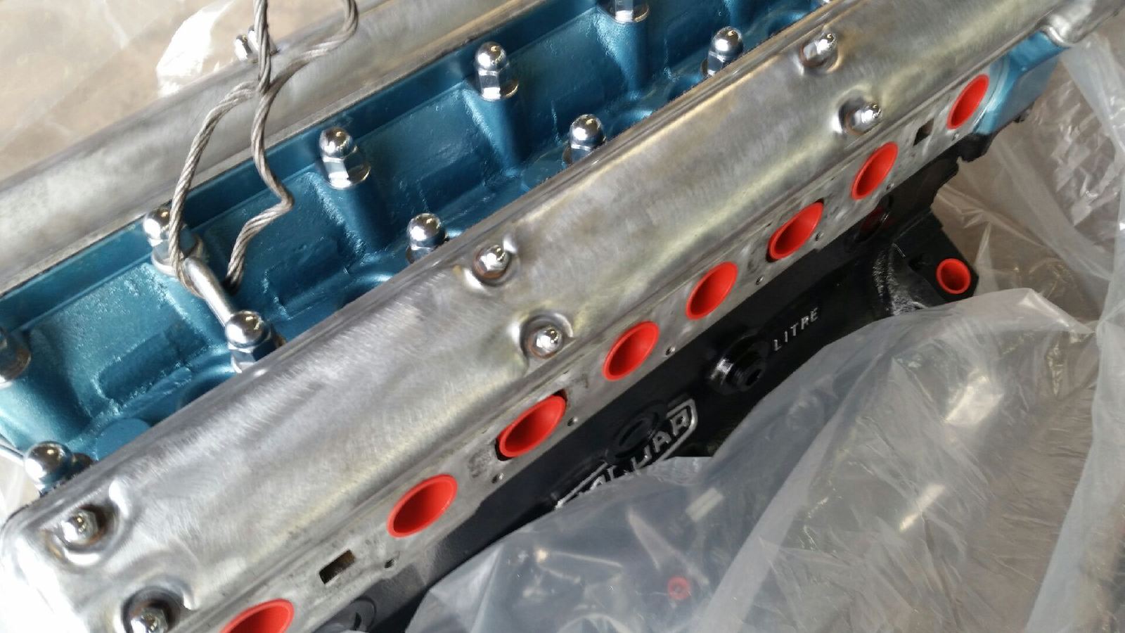

My cam covers were professionally polished, because here's how they looked when the engine rebuilders finished with them: Since then, I've really just cleaned them a couple of times a year with a rag and WD40. I think it helps that my garage is integral, so never goes below 12C, and very low humidity. They never get that condensation on them which causes the oxidisation.
